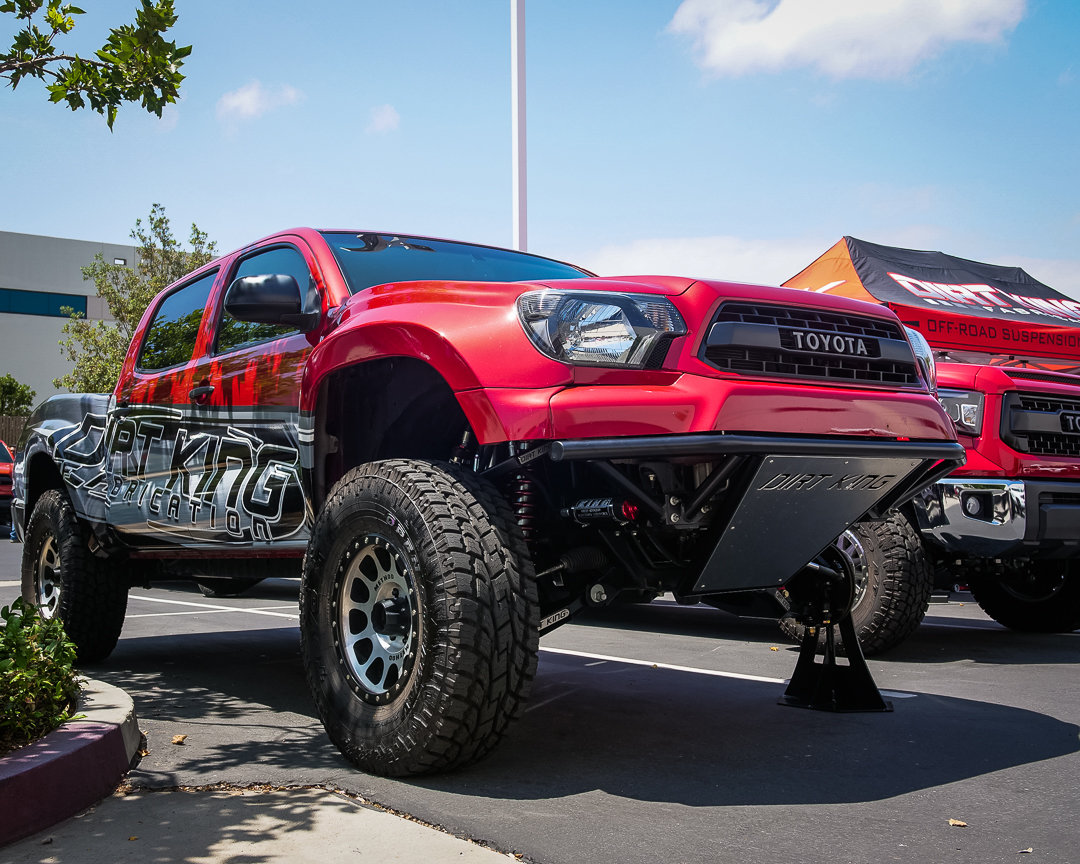

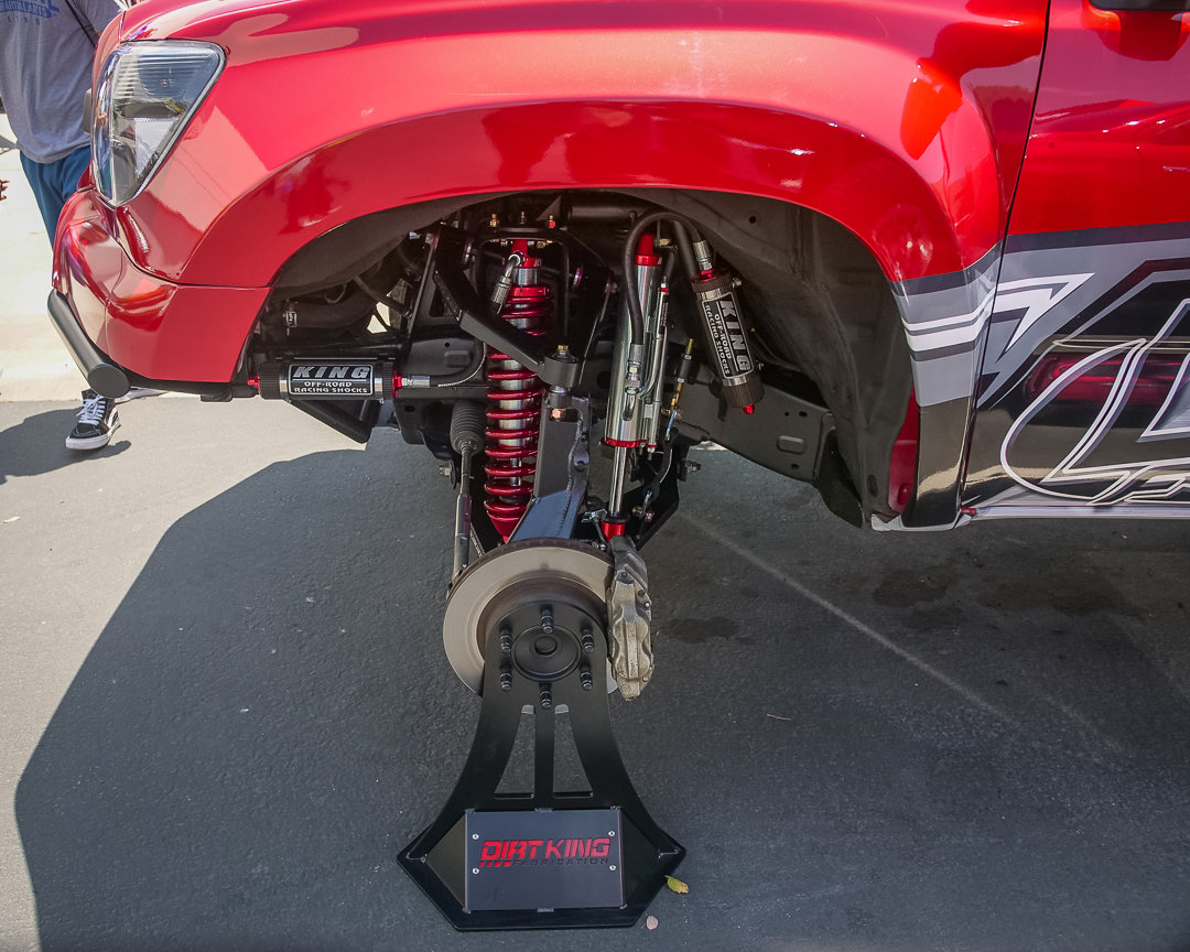

    You can’t go wrong either way, they are both huge improvements from factory suspension. It really all depends on what your looking to do with the truck. The 2” kits are good if you plan on doing a lot of narrow trail driving and don’t want as much of an aggressive look. The 3.5” kits allow for additional travel and keep the truck more stable with the increased track width. They also will require less modifications to fit 35” tires making it a better option in that aspect. I attached two photos of my truck with our 3.5” kit and 35” tires.
