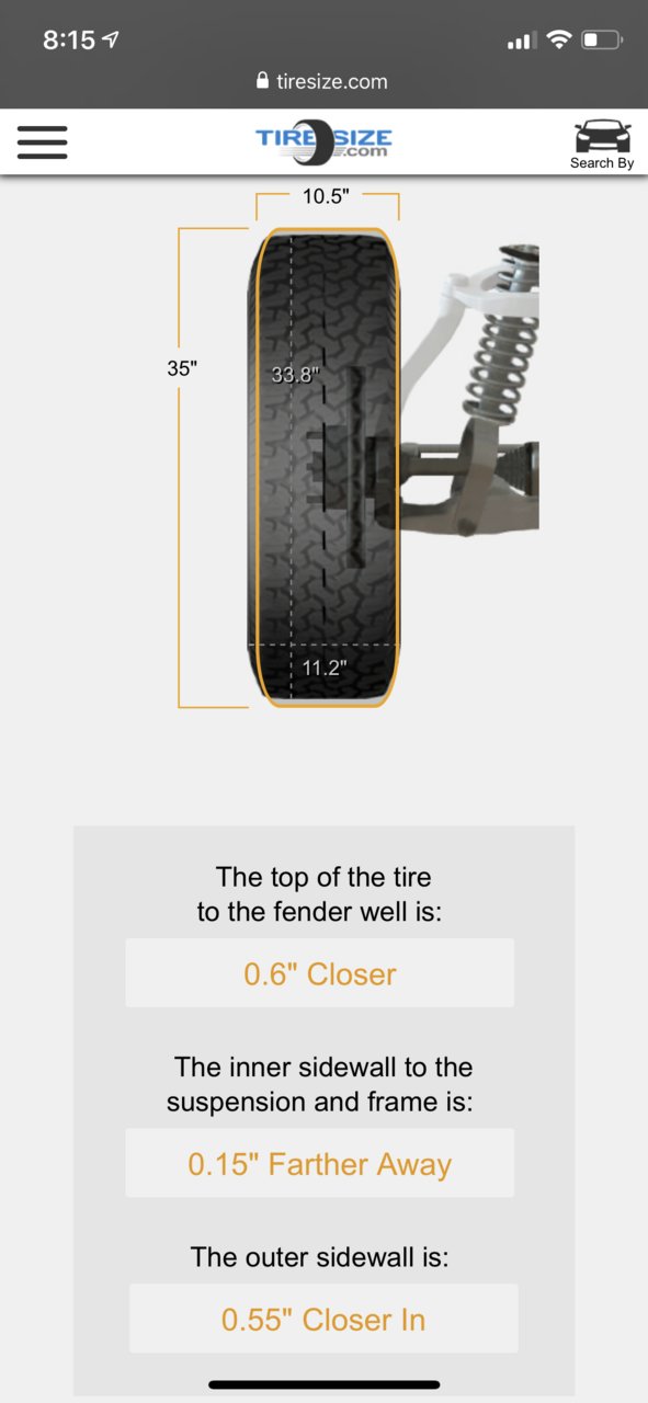

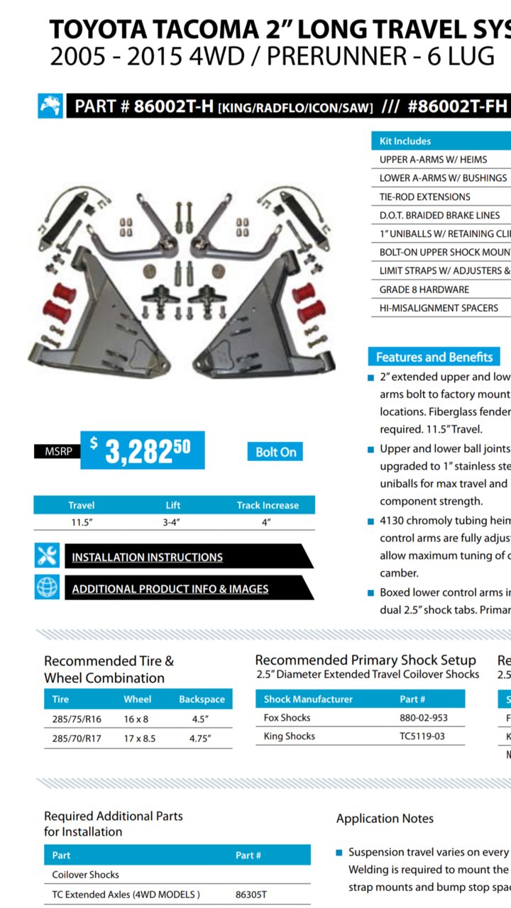

    Planning for the TC +2 race kit. I'm pretty convinced I want to run 285/75/17, seen a bunch of threads where this tire IMO looks perfect on the Tacoma. 35" would be cool, but don't want to deal with cutting the OEM fender, as I actually appreciate the factory body lines.
    I'm looking at the Method MR312 wheels, 17x8.5 with a 0/4.75". I think somewhere in my search I found TC says 4.5" minimum, but can not find the thread for reference.
    What would be the proper offset for me? Like to try to get this all figured out before I start ordering.

    I am planning on running effectively the same set up. Except 17x8 0 offset wheels. With my current mid travel set up and 34’s I clear the cab mount but need to flatten the pinch weld a bit.
    Check out the Taco Blanco build on the TC page and here. It’s a ‘16 +2LT 285/70/17 on methods. Pat told me the tire scuffs the inner upper part of the flair at full bump.
    I would gladly trade my FN FX pros for some TRD sema pros (+ 5 offset) 4.5 bs and run 35x10.50x17 Kenda’s like @Lord Humongous.
    Does anyone know if LT kits shift things forward (away from the cab mount/pinch weld)?
    I play with this site... I feel like the less tire sticking out the better.

    From someone who recently went to a +2 kit, go +3.5. I wish I would have. The +3.5 kit will basically cost the same amount of money and you will gain more. The only additional cost will be glass.
    Backspacing can be a confusing number. It is a function of offset and rim width. Offset is the dimension that you really want to look at. Offset is the distance the mounting surface is from the center of the wheel. the center of the wheel does not change regardless of rim width. The backspacing measurement would.
    Example: 0 offset, 8 inch width = 4.5" backspacing
    0 offset, 8.5 inch width = 4.75" backspacing
    In this example the wheel and tire are in the same position relative to the mounting surface, the only difference is the width of the rim.
