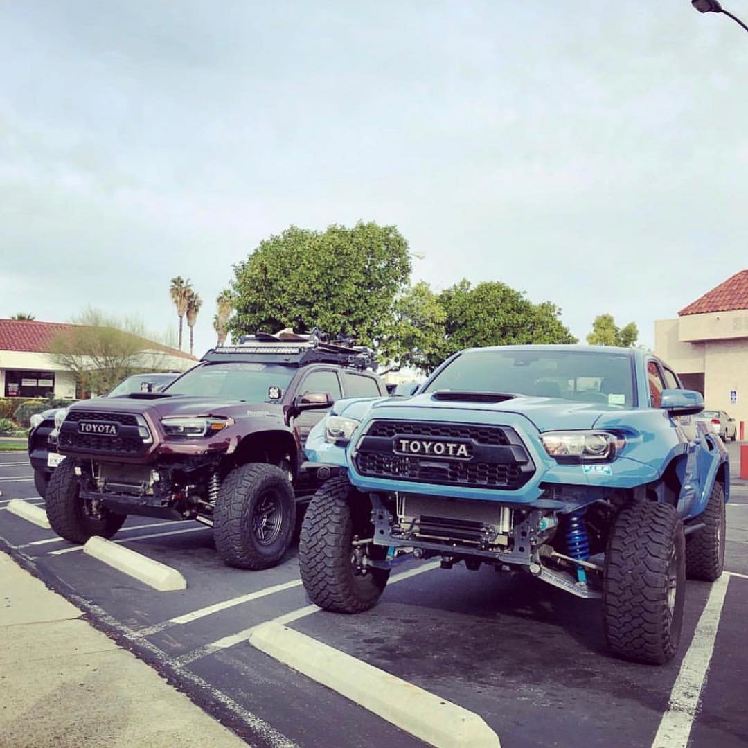

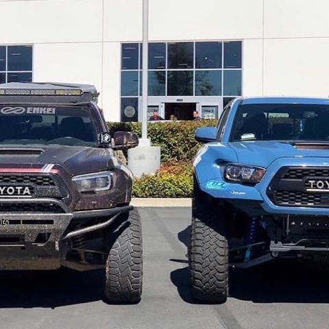

    I ended up getting the 3.5 Camburg kit (the deal was too good). Also picked up a set of Methods MR312 in 17s and a set of 315/70/17 KO2s. What are my best fiberglass choices.
    Theres a photo I keep going back to of 54syota and a blue one. I know 54syota is running 3.5 dirt king with mcneil 3" fenders. Not sure about the blue one, but it looks like 6 with TC 3.5".

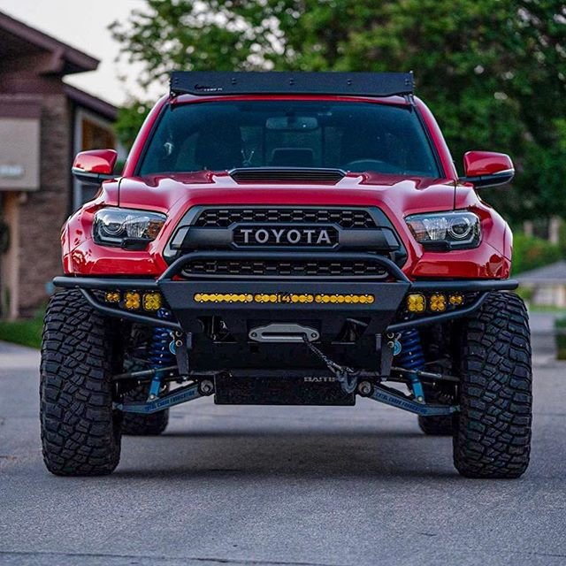

    Curious to know what rear spacers 54syota is running. I'm hesitant on the 3" fenders, because I don't want to bang em up, but Im not sure if I can do 6", I guess I would need to see in person. Also would like to know if anyone has any info on the red one.

    So from what I can tell my options are pretty much whatever I want for the front, 3, 3.5,4.5, 6" - for the rear Fiberwerks (3.5 or 6) or McNeil (3")

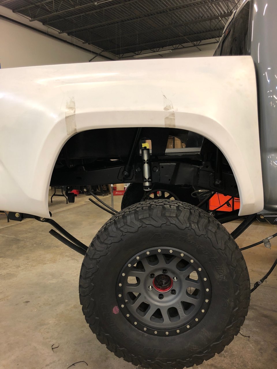

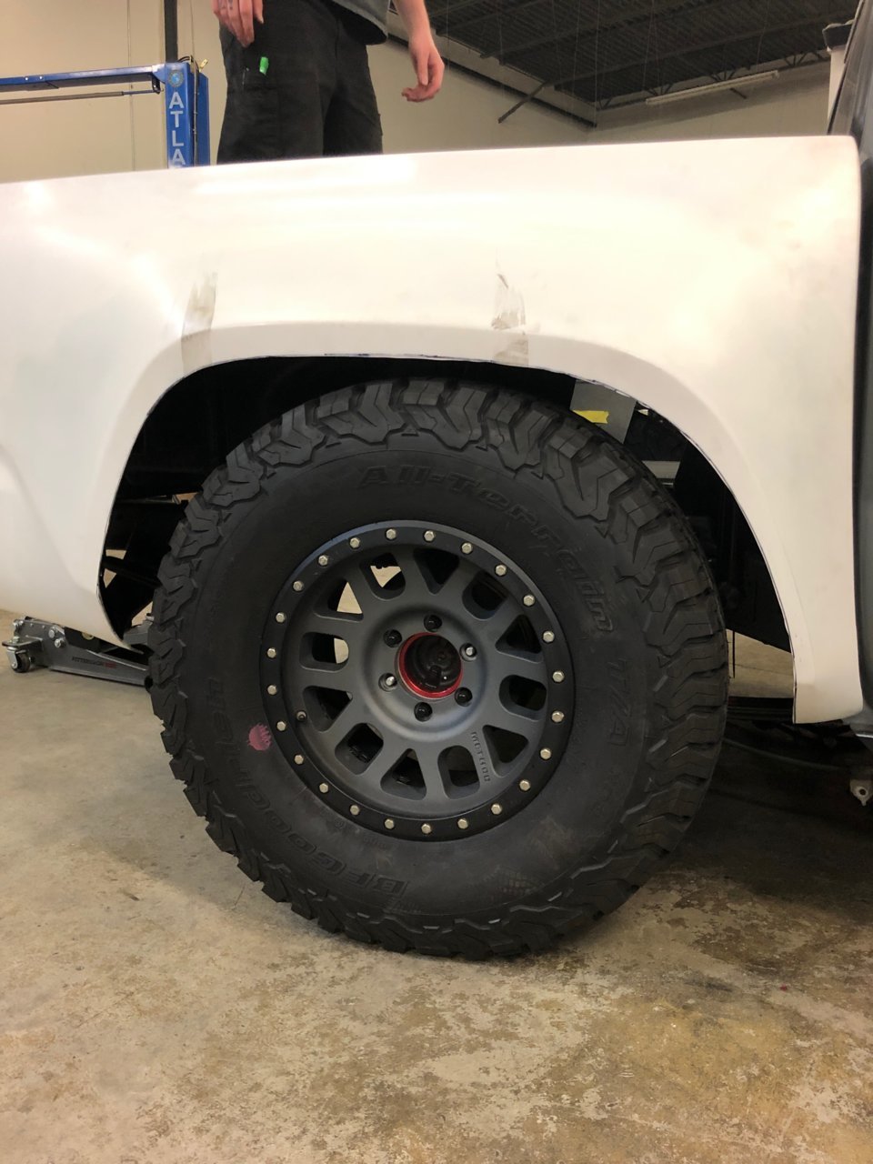

    @MISTERRABBIT my advice on rear fenders and real SUA kits is to go with fiberwerx rears. Tim at Dmz did a white 3rd gen and was able to clear 35s with it. I believe they revised their fenders after someone couldn’t even clear 33s.
    Here is what my rear looks like as of yesterday. In order to clear the fenders we had to trim them. I was really hoping for a matching look front and rear, but fiberglass will never be perfect and it’s made to be beaten up. Eventually I’ll go 6in rear to clear 37s. Another thing to note on my rear fenders is that they are a custom 1 off that Mcneil got rid of the stock fender trim and made the 3in match the front style 6in. So in doing that I’m not sure if that changed anything. They still had a 90 degree lip under them like the regular 3in. And I think he just molded them to match my fronts. But not positive and don’t want to give anyone wrong info.
    one pic is how they came.
    another is trimmed.
    another is painted and how it was sitting yesterday.
    And I’ll have my truck back Friday which I’m really pumped about.
    now don’t go thinking ur front is going to clear 315s with that 3.5 kit and actually get 14in travel. We cut A LOT and basically remade my inner fenders. And it’s still not going to clear at full bump and turn.
