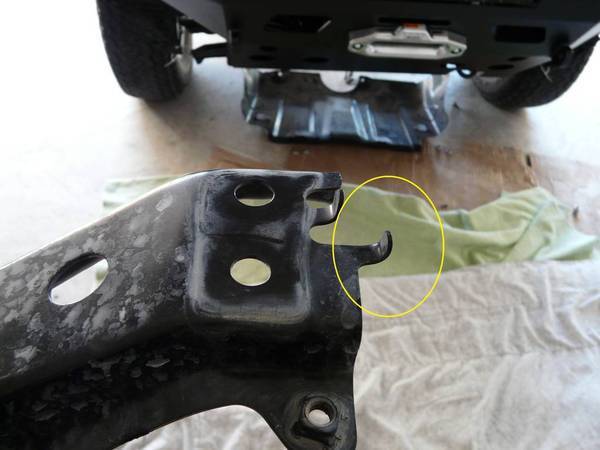

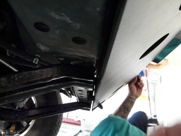

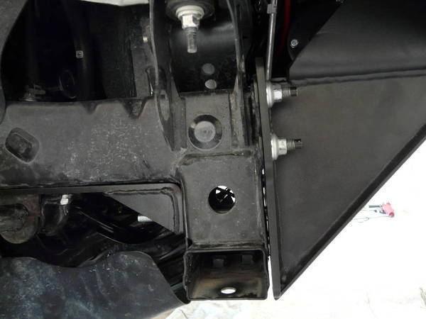

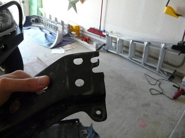

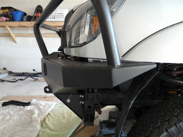

    HoKay! So I finished installing my bumper and it took me 2 days to make final adjustments here and there (OCD). My review based on what I encountered:

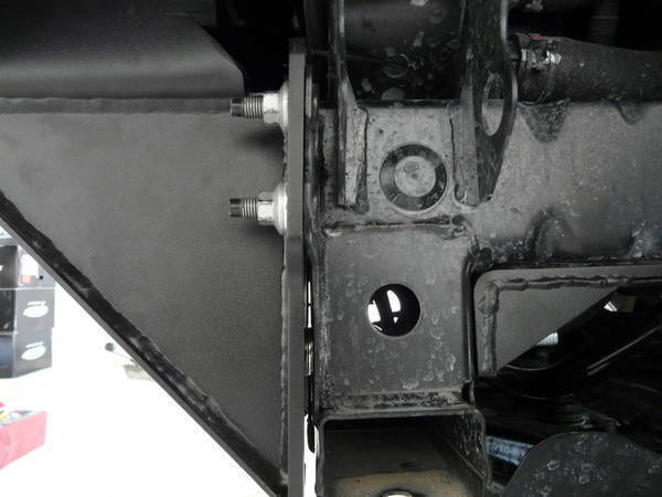

    1) I shimmed the VERY bottom of the driver's side in order to get the proper angel so my bumper wasn't pushing up against the factory flare. I used a total of 3 washers to shimm my bumper out. Before and After pics below. (This flare problem occurred only on my driver's side)
    2) Due to shimming, I had to get a longer bolt (1" longer than the supplied bolts) that runs through the bumper and the supplied gussetted brackets. (no pic)
    3) Observation: Shimming the one area I did shim pushed and angled my bumper away in the direction I wanted. In doing so meant that there would be a gap inbetween the mounting surfaces of the bumper and the frame where the studs are. When I torqued down the nuts on the permanent studs it tweaked the metal a bit. In the pic below the frame's mounting surface SHOULD be straight, but since I shimmed it, there is now a bow in the mounting surface.
    Also, I have to add washers to the very bottom bolt on the passenger's side in order to close the gap and to avoid problems in the future.
    4) I had to cut off this tab on both support arms because there was not enough space in order to reintall the factory skid plate.
    5) I was able to mount my solenoid control box on the winch barrel. However, on my bumper it was an extremely tight fit. It sits right up against this bracket (pic below). If this box were any larger, I would have needed to mount it elsewhere. (Warn VR-8000s)
    6) My RI Dually fog lights also sit right up against the same braket above. Not a big issue, but any other fog light with a larger housing would have pushed my bumper down; therefore, creating a larger gap all along the top of my bumper.
    7) During install of my bumper I decided that I wanted to remove the sway bar in order to gain more suspension flexibility when off roading. When I took it for an off road test run, the body was flexing way TOO much that the bumper was significantly pushing up on the factory flares. Hell, it was even getting the same flexing when I was pulling into my driveway. So, I reinstalled the sway bar, did another test run, and the flexing of my bumper seemed to completely dissappear. The bumper was no longer pushing up on the flares. I had to make a decision at this point; risk ripping off the factory flares when flexing the body, or sacrifice some suspension flexibility. I went for the latter since I don't go CRAZY on the off roading.
    This review is based on my experience with installing MY bumper only. There are variables that exist, but are not shared by all bumpers/Tacomas manufactured. Each bumper is unique and each has their own variances.
    This is one AWESOME bumper. I would definitely purchase another one if I had to.

    No frame braces on that bumper ?
  7. Oct 29, 2012 at 11:18 PM
    #47
    OZ-T
    OZ-T I hate my neighbour
    Dec 15, 2009
    #27584
    50,586
    Peter North
    British Columbia
    Oh , on the engine side of the frame rail ?
  8. Oct 29, 2012 at 11:20 PM
    #48
    TeamLombardo
    TeamLombardo [OP] WE'VE LANDED ON THE MOON!
    May 20, 2012
    #79227
    641
    Tony
    El Paso
    '12 DCSB TRD Off-Road 4x4
    OME 886x, OME Trim Packer, OME Shocks, Dakars, Toytec Shims, LR UCAs, CB Drop, Demello Sliders, Pelfreybilt Plate Bumper, Warn VR8000-s, RI 20" LED, RI Duallys, TRD Exhaust, Weathertech Liners, SS Brake Lines Front/Back, BHLM, Anytime Fogs, CV Boot Mod, 20% Tint, Stubby Antenna, Salex Console Organizer, Derped Grill/Badges
    Below it.
    I kinda wished that it did have beefier mounting points though. The stock mounting points are weak IMO

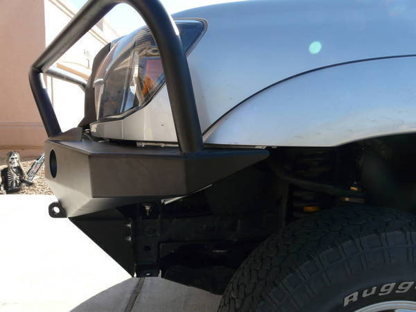

    Mother F'er! Damn body flex is making my bumper hit the fenders. Gotta adjust the damn shit again.

    Yeah I have a lot of leeway to adjust downward and open up the gap. I played with it a bit when initially installing, but I just hate having to fiddle with it more :mad: Fuck it! Going fenderless COMPLETELY. That's one thing I like about Jeeps.

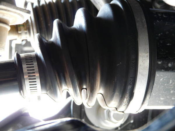

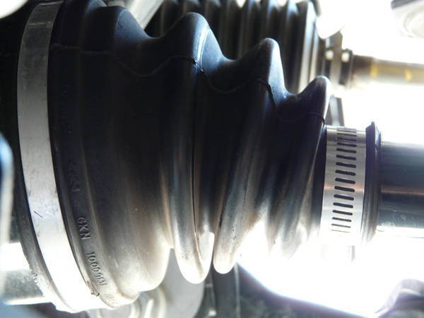

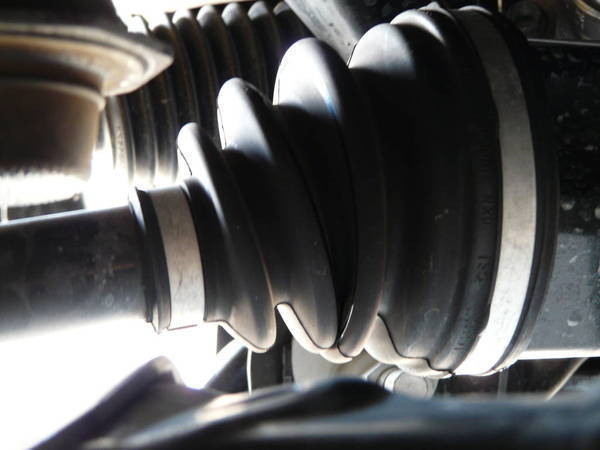

    So I decided to do the CV Boot Mod since the fins of my inner boots have been leaving a nasty groove. This mod took me about 15 minutes. Very simple to do.
    Tools/Materials Used:
    -Flat head screw driver
    -Needle nose pliers
    -8mm socket w/ratchet
    -Rag to clean shaft
    -3/4" to 1 3/4" hose clamps
    Miles Mod was done at: 7,488
    Drivers Side Before:
    Drivers Side After:
    Passenger Side Before:
    Passenger Side After:
    Edit: Holy shit you really have to crank down those clamps! I drove to Target (3 miles round trip) and when I got home the fins had moved closer together. They weren't touching, but were close. I readjusted the boots and cinch down the clamps real tight like. Lets see what happens.
