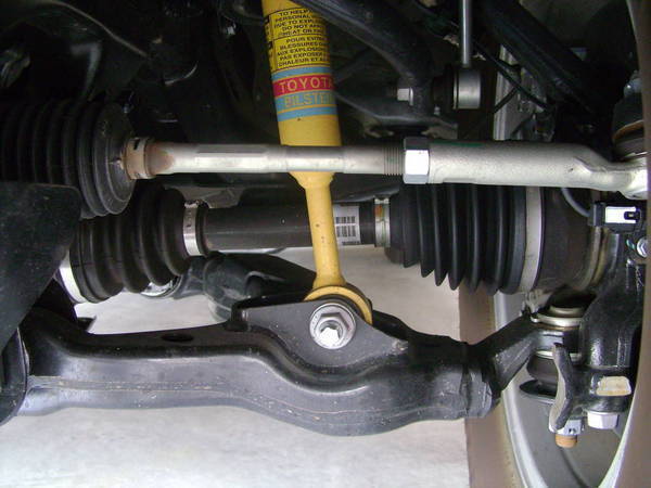

    CV Angle Before Lift (Driver's side)
    CV Angle After Lift (Driver's side)

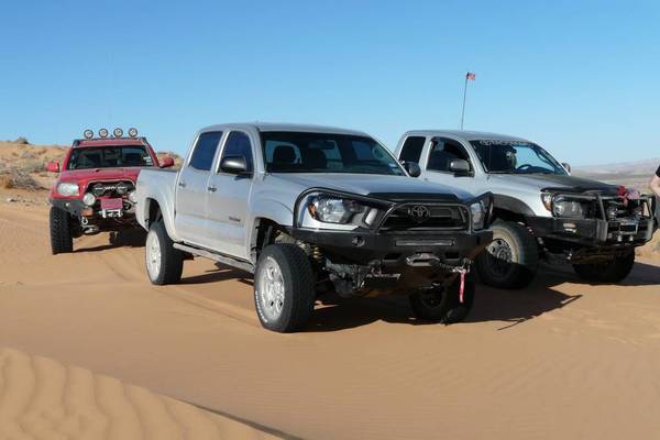

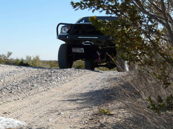

  14. Sep 15, 2012 at 11:48 PM
    TeamLombardo
    TeamLombardo [OP] WE'VE LANDED ON THE MOON!
    May 20, 2012
    #79227
    641
    Tony
    El Paso
    '12 DCSB TRD Off-Road 4x4
    OME 886x, OME Trim Packer, OME Shocks, Dakars, Toytec Shims, LR UCAs, CB Drop, Demello Sliders, Pelfreybilt Plate Bumper, Warn VR8000-s, RI 20" LED, RI Duallys, TRD Exhaust, Weathertech Liners, SS Brake Lines Front/Back, BHLM, Anytime Fogs, CV Boot Mod, 20% Tint, Stubby Antenna, Salex Console Organizer, Derped Grill/Badges

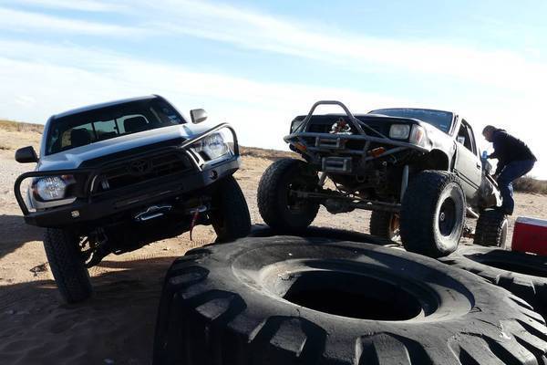

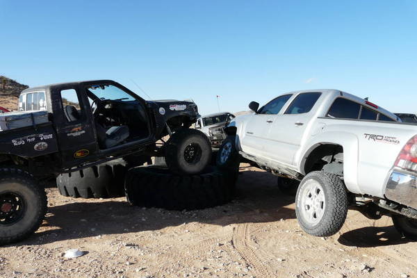

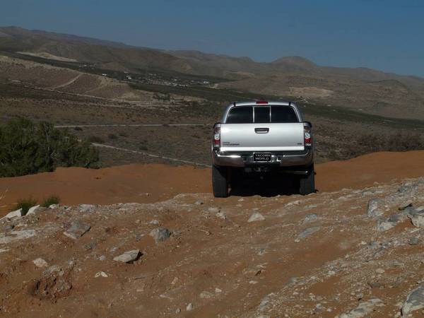

    Airing down a bit (18psi)
    This was a pretty steep climb (4lo w/diff locked)
    The old lady pretending to like going on the trails
    Trying to figure out what the hell I am doing
    Getting off the hill cause I couldn't go up any further. The trail was too narrow.
    Airing back up (An onboard compressor would be nice....)

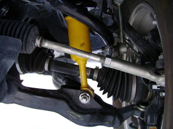

    Here are pics of the driver side.
