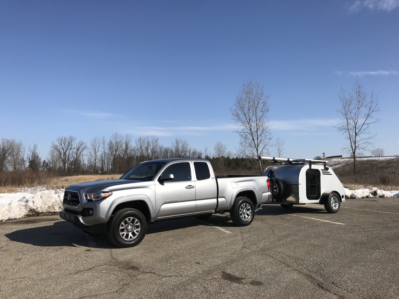

    I’ve camped in my teardrop for a few years and after pulling it with a CX-5 I got tired of worry about tow limits and deciding if I had enough available tow capacity to bring the dog with me. It wasn’t that bad, but you know the feeling if you’ve towed with a small SUV. Anyway, tomorrow is the first time I’ll be pulling with the Tacoma for any real distance. My teardrop is about 1400 lbs loaded and there will be about 500lbs in the truck (including the humans). I have the tow package/V6 and want to know if I’m ok not using ECT. We are going to northern Michigan so we aren’t dealing with many big climbs where ECT would be needed. I believe the manual says use the ECT when towing...is that an absolute when towing such little weight? I just like the way the truck behaves without ECT on (I know I’m in the minority on that). If not using ECT, is it safe to let it run in overdrive? I obviously wouldn’t do this in terrain with real climbs. Just looking for sound advice. First post (first Taco) here so go easy!
