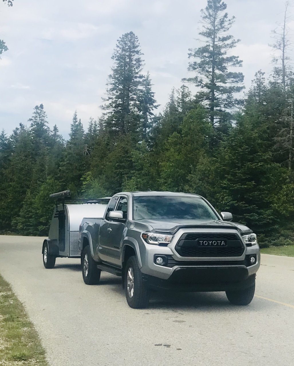

    It should pull the trailer you're looking at without any issues. I would try and keep the trailer weight loaded to around or below 2500# (some will say it can tow more than that, but 20% of the 3500# towing capacity is 2,800#). You also want to drive using the ECT button and S4 mode to keep it out of 5th and 6th gear. You may also want to maybe look into a transmission oil cooler, if you have an auto. I saw that you have a hitch, but didn't see anything about the type of wiring that you have on the truck. Make sure you know what type of wiring harness the trailer comes with so you get the right wiring for your truck. For example, lighting alone usually only requires a 4 pin connector, but if the trailer has trailer brakes you'll need a 7 pin connector.
    As far as the V6 goes it will definitely tow better, but don't underestimated the 2.7L engine. BTW - it will probably rev around the 2800/3000 RPM mark and that's fine.
    Good luck!!

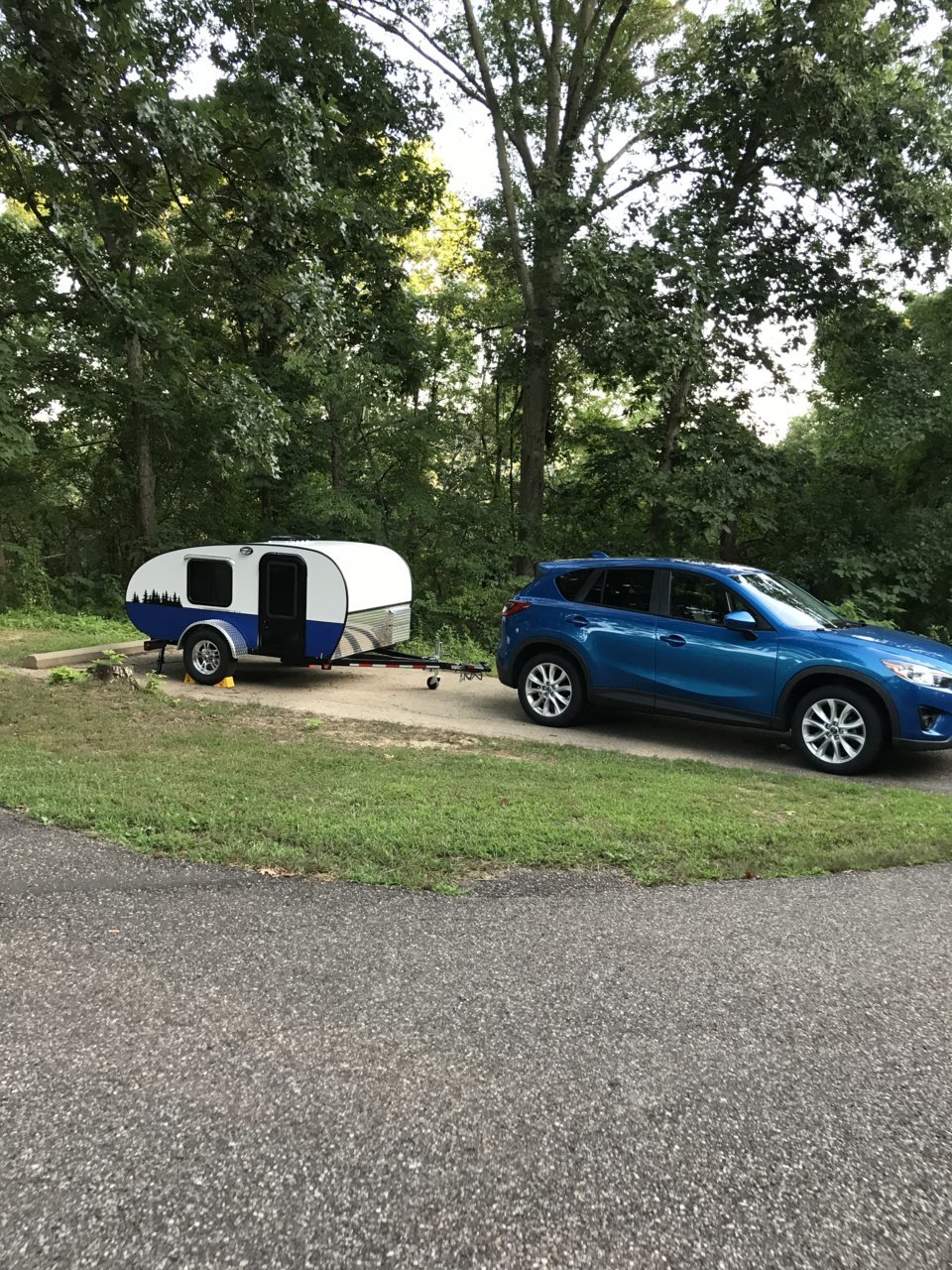

    I had their Papa Bear teardrop and pulled it with a 2014 Mazda CX-5 (2.5 4 cyl). It did a good job of pulling it. Definitely knew it was back there when I hit hills, but never felt like it was struggling much. I’d imagine 4cyl Tacoma would pull it even better. I have a V6 2017 Tacoma now and pulling my new teardrop is a lot less stressful and more enjoyable overall.
