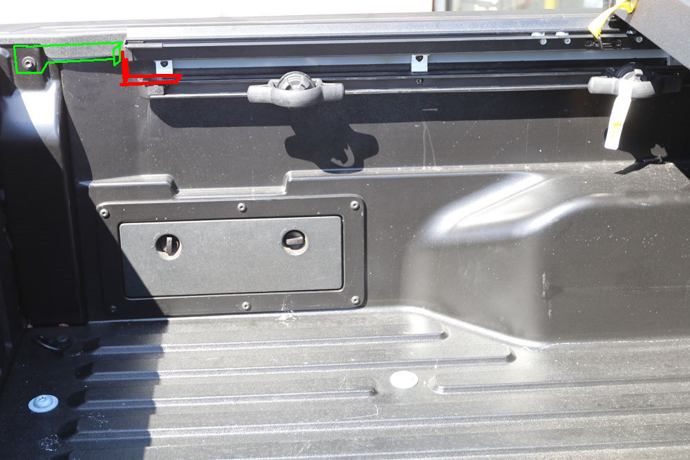

    @Shveet does your tonneau cover shift around off-road? Mine slipped 1/2" backwards after Ardbeg. It seems the aluminum brackets lose grip with the tonneau rails when flexing in rough terrain. I moved the rails back to the original position, only to have them slip backwards about 1/4" after Picard Lake Trail. This lets in water in the headerboard area.

    The Extang tonneau mounts differently (Extang and Bak are the same company): Five aluminum S-brackets bolt to the bed in place of the OEM accessory rail. The tonneau rail dovetails onto the S-brackets. As the S-bracket bolts are tightened, the tonneau rail is squeezed between the S-brackets and the bed. The OEM accessory rail then bolts to the lower flange of the S-brackets.
    I'll probably just fabricate an L-bracket to hold the tonneau rail in place (shown in red or green).

    Do you have the 2.0.
    That doesnt look like my 2.0 brackets

    nope. no movement, solid as a rock.
    you also need to remember mine was either;
    A) Braced by the RTT/ bed bars, so the bed wont flex
    B) Flipped all of the way up, to take on the large trash load

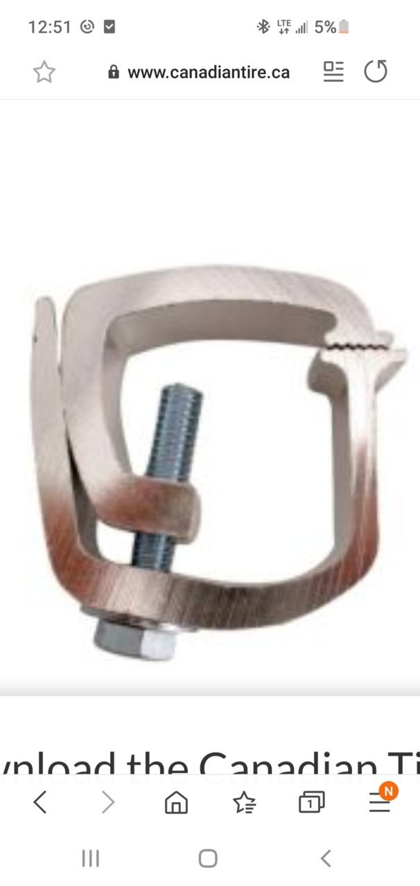

    the ones I have are these types, the absolute worst. When I have time ill drill holes and bolt it down.

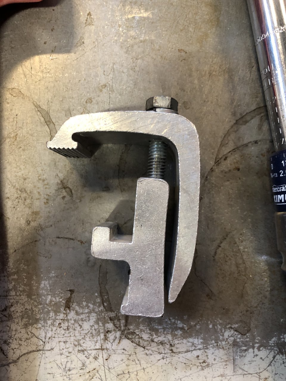

    Should see if you can find a set like mine.
    They hook into the rails and they usually get stuck in there so i have to knock them out when i take my cap off
    and fairly low profile

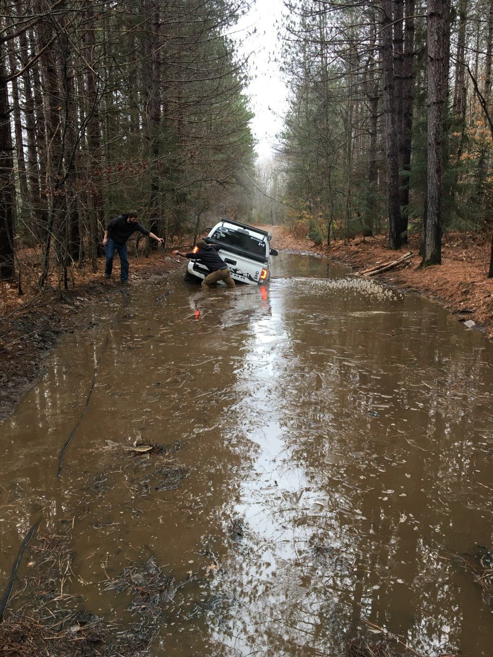

    A friend of mine was out there and in that area with a Jeep group this weekend, said water levels were pretty deep in some areas upload_2020-11-2_2-6-34.jpg
