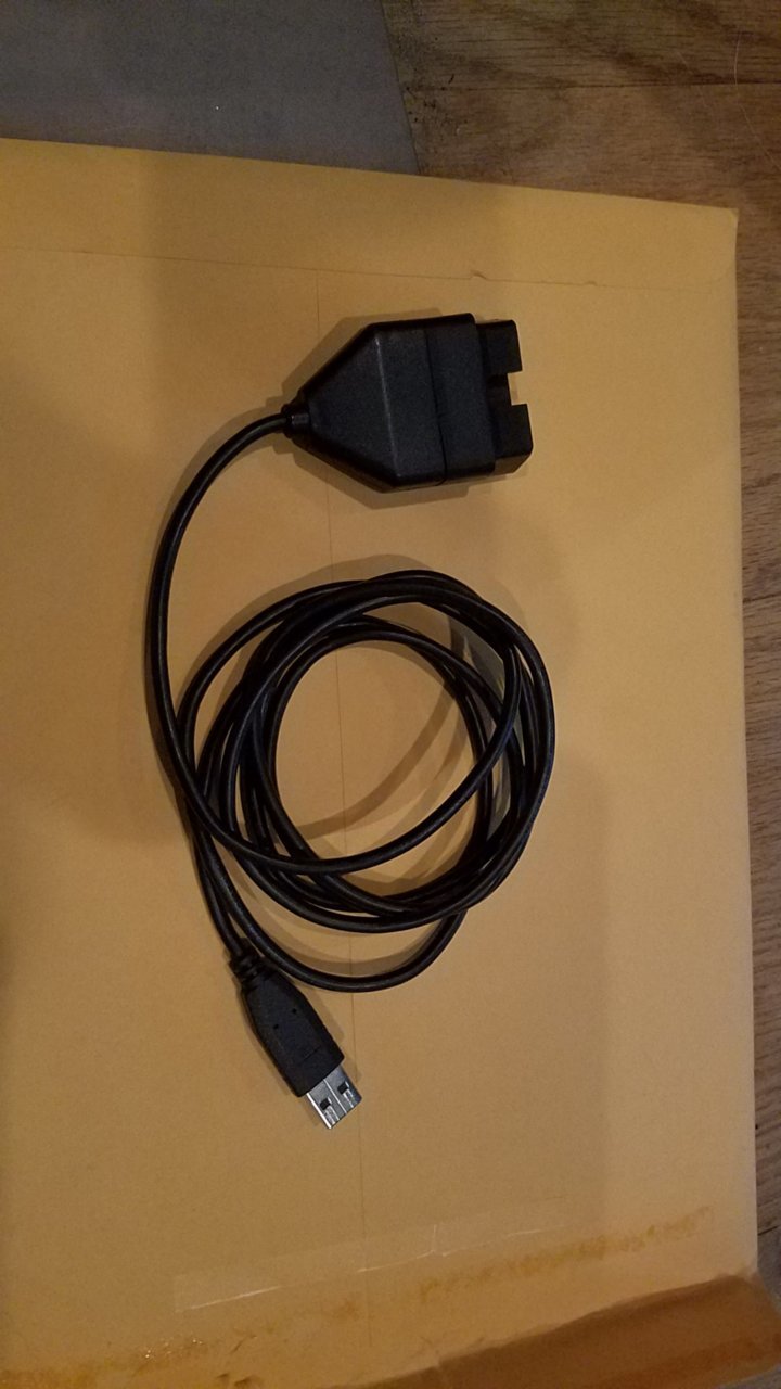

    Just for sanity sake, here is the Tactrix cable I am referring to, it is OBDII and it is a genuine Tactrix from back in the day... Is this going to work for me?
    C41n and tonered[QUOTED] like this.

    Based on the reading I have done so far, im thinking that the Tactrix I have which is OpenPort 1.3 is not going to work. The instructions on the ECU Update thread say OpenPort 2.0
    I am not willing to risk bricking my ECU so I am going to hold off..... Laptop sees the Tactrix and installed the drivers just fine, but I am a bit leery about trying to make a connection to the truck knowing this is OpenPort 1.3 and the drop down in TS specifically calls for OpenPort 2.0 or TIS TechStream VIM
    Thoughts?

    You can run a cable check in TS to verify it has the required functions. It's on the top menu somewhere.

    There is no risk with Customizations. Bricking is only a problem with poor connections when flashing entire ECU software.
    If it has the Jxxxx comms protocol, you should be good.

    Maybe? It different than our 2.0s and 3.0s, but it is more about the chips inside and the drivers.

    So, it shows up as Tactrix in Techstream, but no matter what I do, when I select OpenPort 2.0 in TS, I cannot get it to connect to the ECO, it always returns a "cannont connect" or whatever error.
    I have tried 3 different laptops now, a netbook (XP) a full size (XP) and a full size (Win10)
    Not surprised by the Win10 lappy because I can't even find openport 1.3 drivers for win10, but the other 2 running XP have installed the Tactrix drivers no problem...
    Im stuck..

    The Tactrix 2.0 is a beast of an adapter and seems to work well on our Mazda also.
