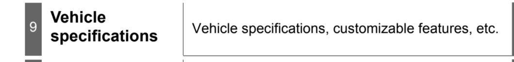

    The entire list of what can be customized is in Section 9 of your OM and is shown in a link directly under the TS step by step instructions.

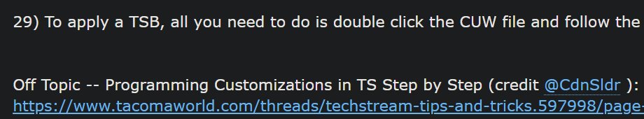

    Section 9 in my owner's manual? And I've been looking for a link directly under TS step by step instructions. My apologize, i couldn't find it at all.

    I don't know how I can be more clear?

    Got it! I found it.

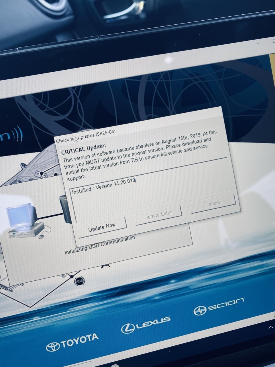

    also, I got the pop up on tech steam saying I need to update. It kept popping up over over over.
