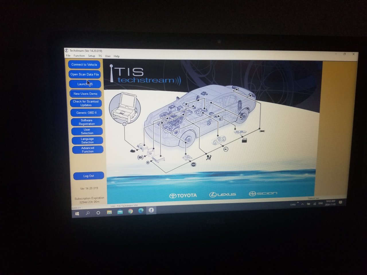

    Any idea why i get an error when trying to connect to my vehicle? Install went well, techsream seems to be working fine. Not sure what the issue is here. Thx guys.
  20. Nov 1, 2020 at 11:01 AM
    #360
    ktbell444
    ktbell444 One who throws exceptions
    Aug 8, 2017
    #226306
    2,969
    ᚺᛖᛚᚺᛖᛁᛗ
    Configure Techstream for the cable you have?
    Junkhead[QUOTED] likes this.
