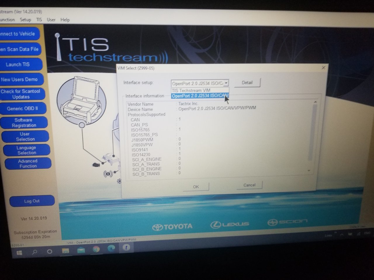

    Is this it?

  3. Nov 1, 2020 at 12:02 PM
    #363
    lapoltba
    lapoltba Full Bridge Rectifier
    Aug 28, 2014
    #137089
    3,347
    CT - 06076
    '17 Sport, ACLB, V6,MT, 04B14 OV-Tuned
    Yes.
