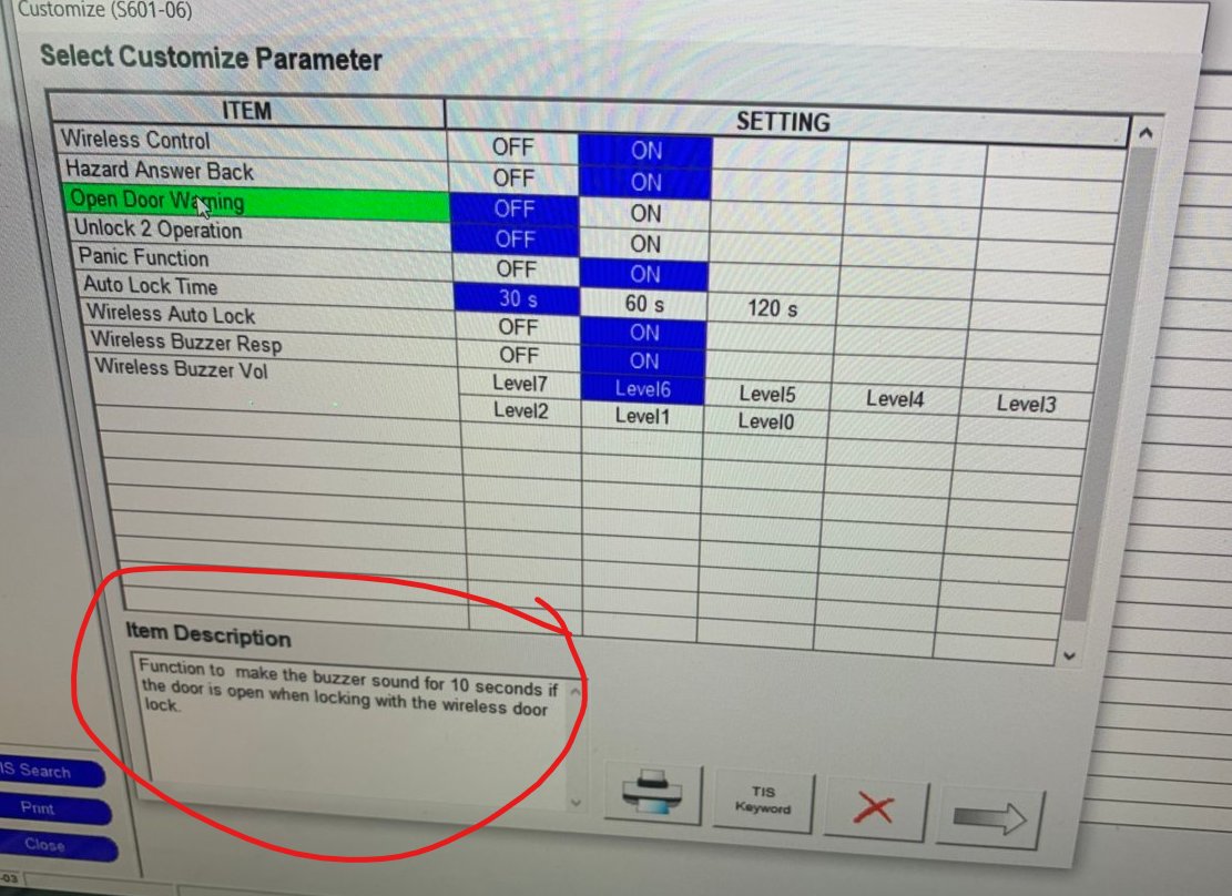

    Here’s the description for the 2019
    And I got all excited...:bananadance::bananadead:

    I believe this is in regard to the buzzer that sounds when a door is open and you hit the lock button on your fob.

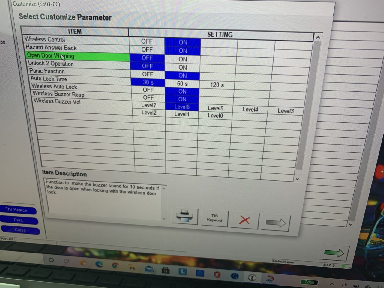

    Well then, maybe that is a different screen than I had with my 2020 (certainly looks similar from memory), but it definitely worked on my truck.
    Edit: I just compared the two screen shots and they do show different options.
    This one.
    And this one.

    On my 2020 I have both options. The third one down in that screenshot is for when the door is open in ACC Mode. The last option in that same pic is regarding the Wireless Lock Function.

    Just tried it on my 2018, the "Open Door Warning" controls the buzzer that sounds when you try to lock the doors from the fob or smart door handle when a door is open.

    Yep... If the elusive door open buzzer can be turned off, it isn't on that screen.

    Again on my 2018, "Wireless Buzzer Resp" controls the single beep the truck makes when you lock the doors and the double beep when you unlock the doors.
