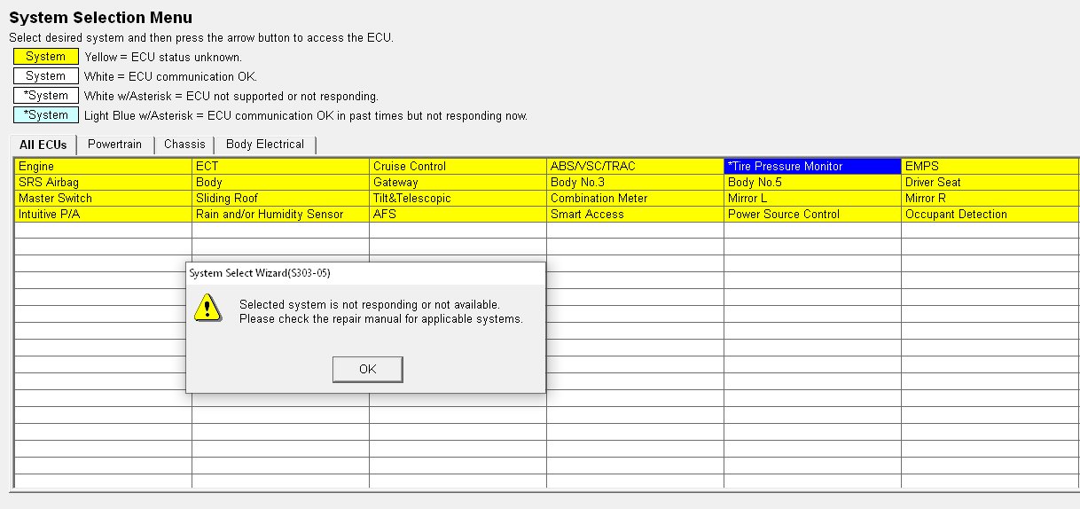

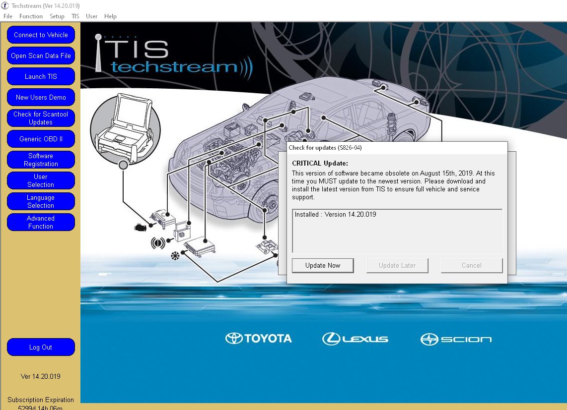

    How are you guys getting past this mandatory update?

  10. Jan 22, 2021 at 10:02 AM

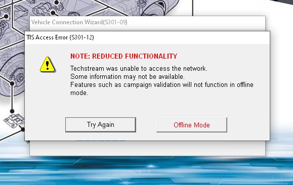

  11. Jan 22, 2021 at 10:08 AM
    #451
    cwtt
    cwtt New Member
    Dec 15, 2020
    #349760
    4
    It then puts the Techstream into a "Reduced functionality" mode. I'm trying to reprogram the TPMS sensors. It then says the system is not responding. I believe this is because of the reduced functionality because I used a real Toyota techstream/Mongoose cable at Toyota (Version 15.x) and I am able to configure the TPMS sensors. At home I am using a genuine Taxctrix cable with the version 14.2 and I'm stuck. Any ideas?
  12. Jan 22, 2021 at 10:11 AM
    #452
    dilbert
    dilbert AI Member
    Mar 14, 2016
    #181276
    2,861
    PNW
    2019 DCLB TRD Off-Road
    Offline mode is all we have without purchasing a subscription. I haven't tried to program TPMS. Is the ignition on?
    Edit:
    Follow the instructions in the first post of the link below to configure it. Make sure you have the drivers installed and choose the tactrix cable from the VIM select.
    https://www.tacomaworld.com/threads/ecu-tsb-update.562550/

  13. Jan 22, 2021 at 10:18 AM
    #453
    cwtt
    cwtt New Member
    Dec 15, 2020
    #349760
    4
    I am able to open the Engine module and scan codes etc. I just can't get to the other modules. So I don't believe it is a connection issue. I'm not sure if the "reduced functionality" mode takes some of the other modules?
  14. Jan 22, 2021 at 10:21 AM
    #454
    mattleg
    mattleg Well-Known Member
    Aug 31, 2018
    #264744
    921
    Kansas
    2020 OR DCSB AT 4WD
    V15 is different I think. It only complains about offline mode when I run the health check and it tries to validate if calibration updates are available.
  15. Jan 22, 2021 at 10:26 AM
    #455
    cwtt
    cwtt New Member
    Dec 15, 2020
    #349760
    4
    I should summarize this so I don't confuse people:
    At home
    Techstream V14.2
    Tactrix cable
    I can connect in "Offline" "Reduced Functionality" to the engine module (check codes, logs etc)
    I can not connect to the Tire pressure Monitor system (it says it is unavailable)
    At Toyota
    Geniunie Techstream setup
    V15.0
    I was able to connect and program the TPMS no problem
    Does "Reduced functionality" take away modules like "Tire pressure Monitor"?
  16. Jan 22, 2021 at 10:26 AM
    #456
    mattleg
    Aug 31, 2018
    #264744
    921
    Kansas
    2020 OR DCSB AT 4WD
    You can use a keygen'd version online like normal, you just have to setup the connection to the public server vice the dealer. It connects and shows if the ECU's have available updates.
