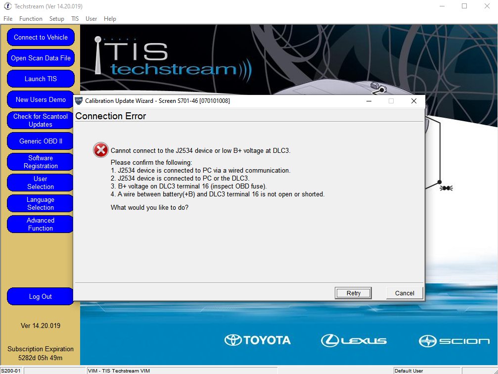

    Hello guys, I hooked up my computer and the flash cable. Ignition on. Run the cuw file. and here is the connection erro message i got:
    My batter is fully charged voltage reading good. Laptop plugged in.
    What else is missing here?
    Thanks in advance

    also turned off the wifi. and still got the same error message. not sure what's wrong.

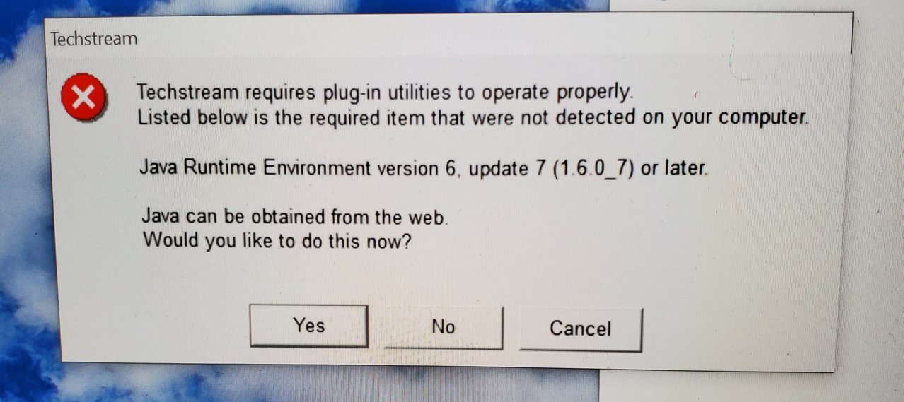

    There’s a free version of fusion
  16. May 21, 2021 at 2:03 PM
    #516
    Shellshock
    Nov 21, 2015
    #170338
    23,623
    Iowa
    I just hit no, you don’t need Java for anything

    Try a different USB port . Try connect to vehicle function 1st and see what happens
    Assuming you are using Tactrix OBDII .

    Yeah i did switched around and tried different ports and also unplugged mouse and such.
    and i believe im using the tactrix odb2. orded the stuff down below.

    Make sure you have downloaded and installed the latest driver from the tactrix website.
    In techstream, go to setup>VIM select.
    Pick the tactrix option from the dropdown menu.
    Also make sure your truck is on but not in accessory. 2 button presses if you have PTS.

    thanks guys. problem solved. i didn't download and installed the driver or properly select it. now all flashed up. thank you guys!!!
