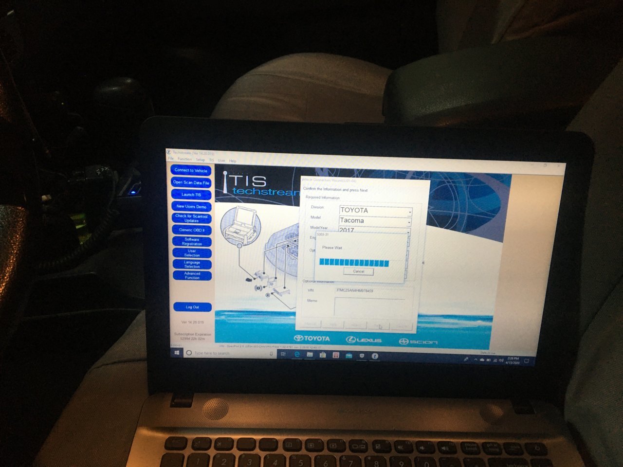

    Just got ver. 14.20.019 up and running on the new tuning laptop! Thanks @tonered
    PCM flash is working too.
