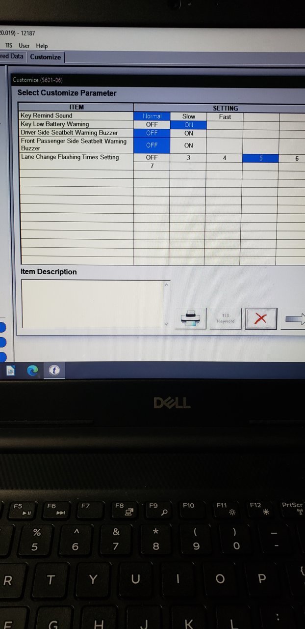

    Does anyone know if the "hood ajar" notification can be disabled/turned off on the 2020's with TS? I am considering asking the dealer if they can do this for me. Every time I air back up, my hood is open and I have to hit the back button to cancel the notification to get back to my tire pressure readings.
    C41n and tonered like this.
  8. Jul 28, 2020 at 5:46 PM
    #148
    tonered
    tonered bartheloni
    Sep 25, 2017
    #231055
    31,214
    tony
    Lynnwood, WA
    Sorry, but not that I am aware of. I could be wrong.

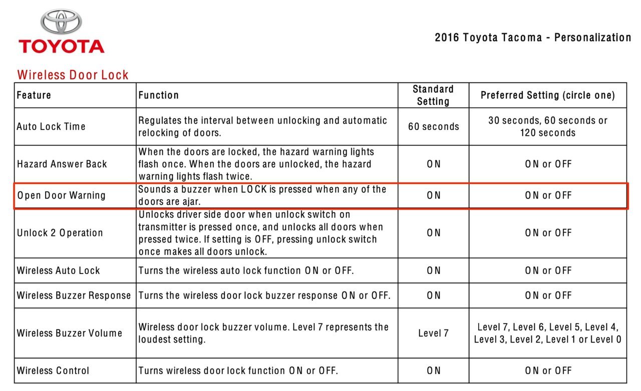

  9. Jul 28, 2020 at 6:09 PM
    #149
    cameleon50
    cameleon50 Well-Known Member
    Jan 14, 2014
    #120593
    203
    Weatherford, Tejas!
    YotaWerx'd 2017 TRD PRO CEMENT
    Hammer Hanger, Kings 2.5, ICON Leaf + UCA, Marlin, OEM Audio Plus, OVTune, Nitro 5.29, MESO, Victory 4x4
    This may help, but need to confirm.

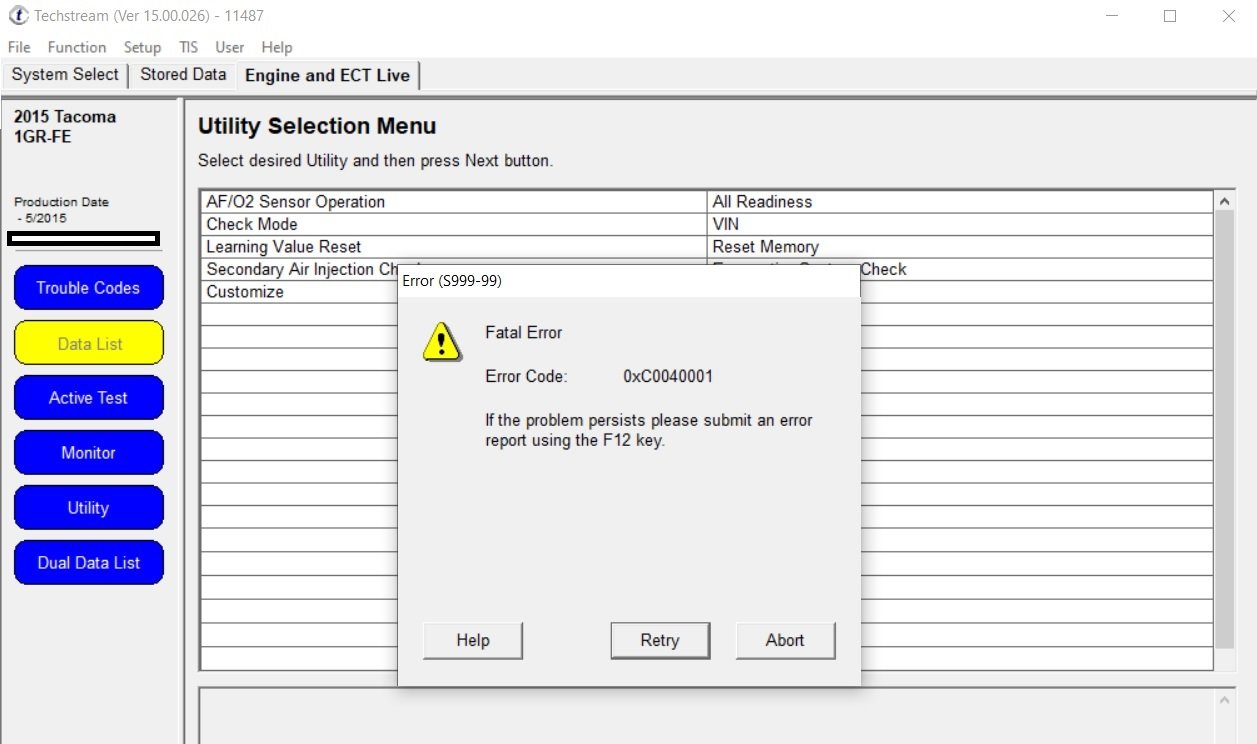

    So I got TIS to work. I can see TPMS data, I can select modules and activate them.
    I am getting an Error on Engine and ECT Live when I click on 'data list'. I believe this list gives me real time engine data which is pretty importation to diagnose issues. Everything else works but this feature.
    Anyone know why?
  12. Jul 29, 2020 at 9:26 AM
    #152
    tonered
    tonered bartheloni
    Sep 25, 2017
    #231055
    31,214
    tony
    Lynnwood, WA
    There is a data list in my share that you can import that gives a lot of the main PIDs.
    For you, my only guess could be a comms issue with the cable? You might try to find updated drivers since the clone often ship with out of date stuff?

    1,079
    Orange County, CA
    I do not think its the cable since I am getting repeated errors only in this field.
    How can I importat the data list? Thanks for the help.
  14. Jul 29, 2020 at 9:31 AM
    #154
    tonered
    tonered bartheloni
    Sep 25, 2017
    #231055
    31,214
    tony
    Lynnwood, WA
    I don't know what to tell you, but comm issues like that were noted in the past. Updated drivers or another cable would rule out the problem. It is highly unlikely that it is your ECU or OBD comms. It might be the particular PID might not be the right one for your ECU? TS is universal for all Toyotas / Lexus.
    The data list was just an easy import versus hand picking the PIDs from the list. It is all just diagnostics and monitoring. Nothing really to be gleaned unless there is a problem.
    4wdExplorer[QUOTED] likes this.

    Just for reference
    I emailed the person I got the sw from, lets see what he has to say.
    If I want a oem cable that TIS recommends. I know its pricey, what have people used in the past?
    tonered[QUOTED] likes this.
  16. Jul 29, 2020 at 9:35 AM
    #156
    lapoltba
    lapoltba Full Bridge Rectifier
    Aug 28, 2014
    #137089
    3,346
    CT - 06076
    '17 Sport, ACLB, V6,MT, 04B14 OV-Tuned
    I can almost guarantee it is a cable issue. The Tactrix cable works perfectly and is relatively cheap.
    tonered likes this.
  17. Jul 29, 2020 at 9:37 AM
    #157
    tonered
    tonered bartheloni
    Sep 25, 2017
    #231055
    31,214
    tony
    Lynnwood, WA
    The seller is a good starting point. Also, take a look at what is on the disk. You should be able to determine where the drivers are from and DL the current ones.
    Yeah. The default Toyota cable is too expensive. The only known, less expensive cable is the Tactrix one.
