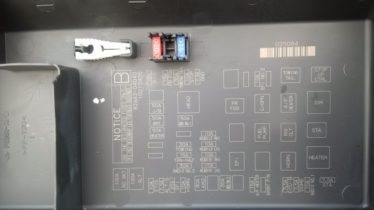

    just installed a Tekonsha Primus 2 brake controller.
    i bought the plug in adaptor to go with the controller which came with its own plug and wires. i spliced the wires from the adaptor to the controller plug to get the length i needed to install in the centre console. screwed the white ground to the truck body inside the wheel well. connected all the colour coded wires to match - 2 whites together, blue to blue, black to black, etc.
    it's not turning on. could it be as simple as a fuse and if so where would i find that.
    any other ideas thoughts are appreciated

    so it's an 05 prerunner no tow pkg. so i'm adding the brake controller and the 7 pin wiring harness. had the plug/adaptor for the brake controller hooked everything up as it should be. no power.
    so i've got it pretty nailed down to no fuses in the fuse box. just have to figure which size fuse to install. so i'm missing the 30A towing tail fuse, and the Towing Tail box fuse and the STOP LP CTR box fuse (just don't know what size they are and assume the dealership can tell me)
    i previously installed the class iii/iv tow hitch with a 4 pin connector so that's all good to go and works.
    so i haven't tried with a trailer connected. gonna get the fuses and then go from there. hopefully that's all it is.

    If you look in the two slots you will see there is only one contact in each one. To be able to put a fuse in they need 2 contacts each.
    As seen here

    perfect. thx.
