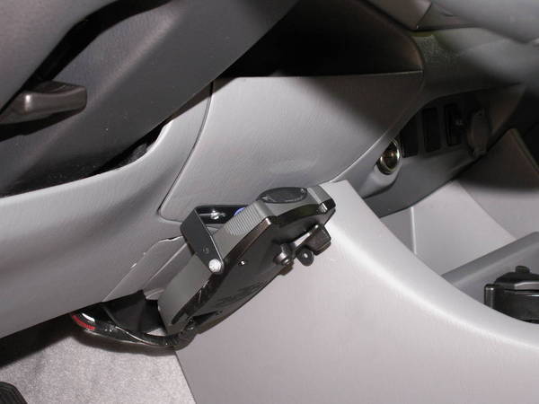

  4. Oct 21, 2009 at 10:19 AM
    yhiki
    yhiki Active Member
    Aug 15, 2009
    #21237
    34
    Atlanta
    09 PreRunner
    This is where I mounted mine. Unit was mounted ofset in the bracket so controler is level.
    [/url][/IMG]

  6. Oct 21, 2009 at 5:22 PM
    K5423
    K5423 [OP] Well-Known Member
    Aug 26, 2009
    #21828
    116
    Mesa,AZ.
    2010 Tacoma Double cab V6 SR5 TRD Offroad
    K&N air filter
    Please post pic again.

  8. Oct 21, 2009 at 6:32 PM
    yhiki
    yhiki Active Member
    Aug 15, 2009
    #21237
    34
    Atlanta
    09 PreRunner
    repost of pic

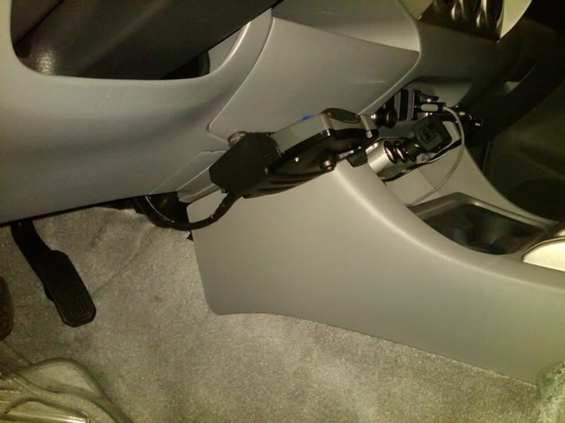

  11. Oct 24, 2009 at 3:44 PM
    K5423
    Aug 26, 2009
    #21828
    116
    Mesa,AZ.
    K&N air filter
    Well........here it is installed with the only logical place I could think of:

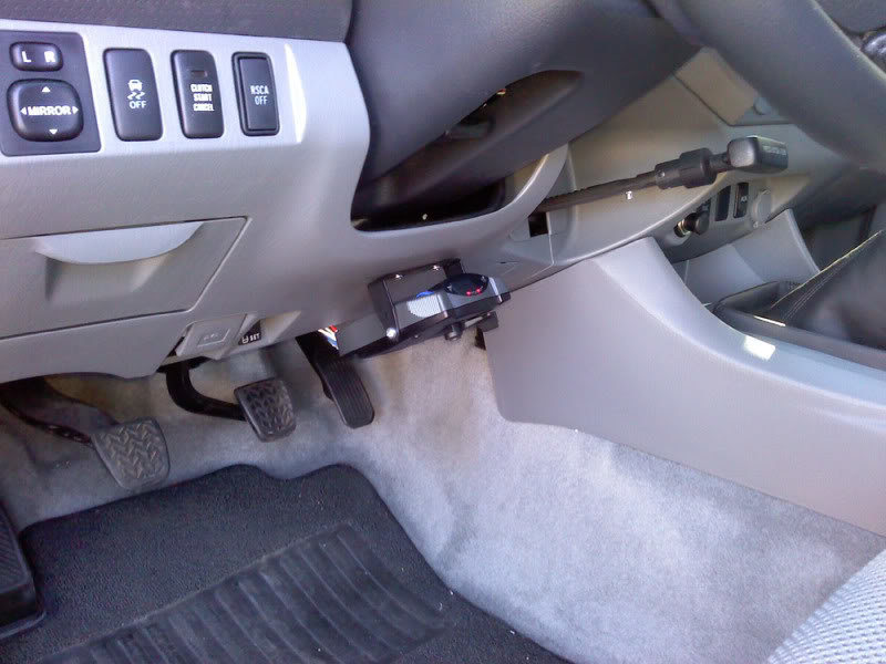

  16. Apr 14, 2010 at 6:08 PM
    #16
    roy826
    roy826 Well-Known Member
    Nov 10, 2009
    #25738
    147
    Mississippi
    2010 Prerunner TRD Sport DC
    Finally got around to installing my brake controller. I took a slightly different approach. I still used the bin to the right since it can be easily replaced. Only I felt it was a bad angle according to the instructions. So I used a rubber shim on the left side facing forward to bring the device horizontal with the front of the truck. Not 100% horizontal but better than simply mounting the thing flush with the panel. I also used the pocket. I like the idea of removing it when not in use and plus a thief won't be eying it. The trucks plug was easy to locate. The wiring was super easy. I don't have a trailer yet that uses trailer brakes but hopefully that will change come this weekend when I go look at a 18' Coachmen blast 150 toy hauler I plan on buying.
    No interference with my leg as far as I can tell. now if I were 5' tall and had the seat all the way up yes it might become an issue. BTW that is a GSXR rubber fairing grommet I used for a spacer.:D Perfect fit.
