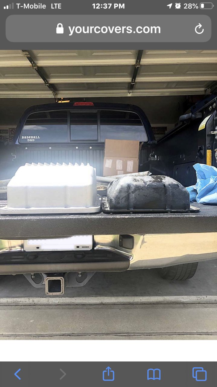

    You can always add a bigger pan for a little more fluid capacity. This pan game me 2.5-3 qrts of extra fluid. Pml covers. This one was a proto type before they sold them to the public. Temp wise I’ve only monitored it while cruising. Hasn’t hit 190 while cruising. A47490DC-B139-4653-AE8E-AC6E278A616C.jpg
