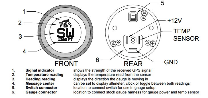

    I am today. I'm simply gathering and reading all the preliminary information that they have already provided concerning the product. I figure before chatting with them, it doesn't hurt to be familiar with what I'm talking about. :notsure:

    You know, it's been a LONGGG time since I've mounted standard 2" gauges, but it sure seems to me that this alt/temp gauge is really made for a standard 2" mounting hole, and they're saying 2-3/16" is the gauge's widest point (outside the bezel). Guess they can tell you that when you call them and see if it would drop into a standard 2" mount.

    Got in touch with Wes at Dakota Digital. Nice, helpful guy.
    Here's what we discussed:
    -Unit is, besides the temp sensor, completely self-contained and requires no additional hardware. Just power, ground and the included selector switch.
    -He said it will have to use the HD temp sensor to work properly, echoing what a few of you have mentioned concerning the temp-to-voltage/resistance.
    -He wasn't sure how well it would receive GPS reception in a cab; he's never seen it done, but heard from other co-workers that there can be issues depending on placement.
    -If I bought one and it didn't have reliable reception, he'd have no problem accepting a return and refunding.
    I'm definitely still interested in this. My phone GPS and Garmin GPS both get fast and reliable satellite reception in the cab, so while I don't know the particular GPS chip capabilities in the gauge, I imagine it should be at least somewhat comparable.

    Oh, forgot to mention: The 2 3/16" measurement is for the body, not the bezel. So unless there's a good bit of wiggle room, any standard 2" gauge mount is going to take a little work to fit.

    I'll be purchasing it in the net few days. Exciting to get this project going and see if it works. I'll certainly keep you all posted.
    For those interested in doing this themselves, I think I found the proper ambient temp sensor: part # 74419-96A
    Haven't had much luck finding the 3-wire bundle that goes between the sensor and the gauge, so I'm guessing that's probably part of the main harness and not separate. Not hard to make one, though.
    Wes also emphasized that the inaccurate temp readings on the bikes from the factory are often due to the sensor placement, as it is under the fairing and too close to the engine. Should be a lot easier to find a better spot away from heat/sunlight on the truck.
    I imagine the A-pillar would be a good spot, but I'm still undecided on that location. May be odd to have a single gauge there, and I'd lose the grab handle in the process.
    Or maybe I need to hook up oil pressure and trans temp gauges, too. :boom:

    I have a grab handle on mine. Maybe some years didn't have one on the driver's side?
    Didn't think about on the steering column. I'll have to look at that spot and make sure it's not blocking anything. Appreciate the suggestion!
    I'm gonna wire it up and test how well it does before I commit to a particular mount and area. If it looks like it's getting reliable satellite reception, the next step will be ideal functional placement.
