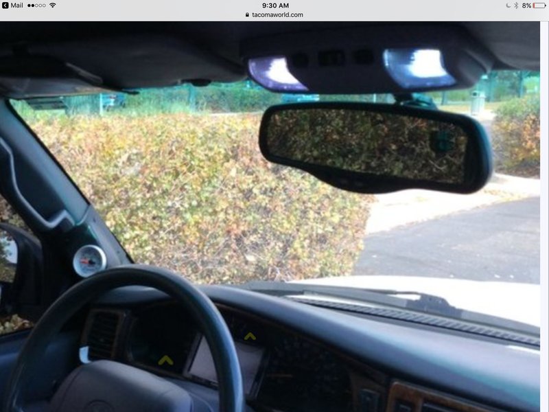

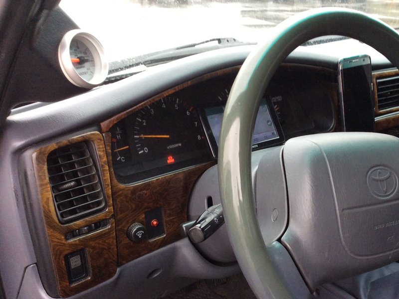

    Single pod will fit the bill for u if you don't use a gentex mirror like I did and gps
    has the altimeter built in
    WileECoyote and McMash[OP] like this.
