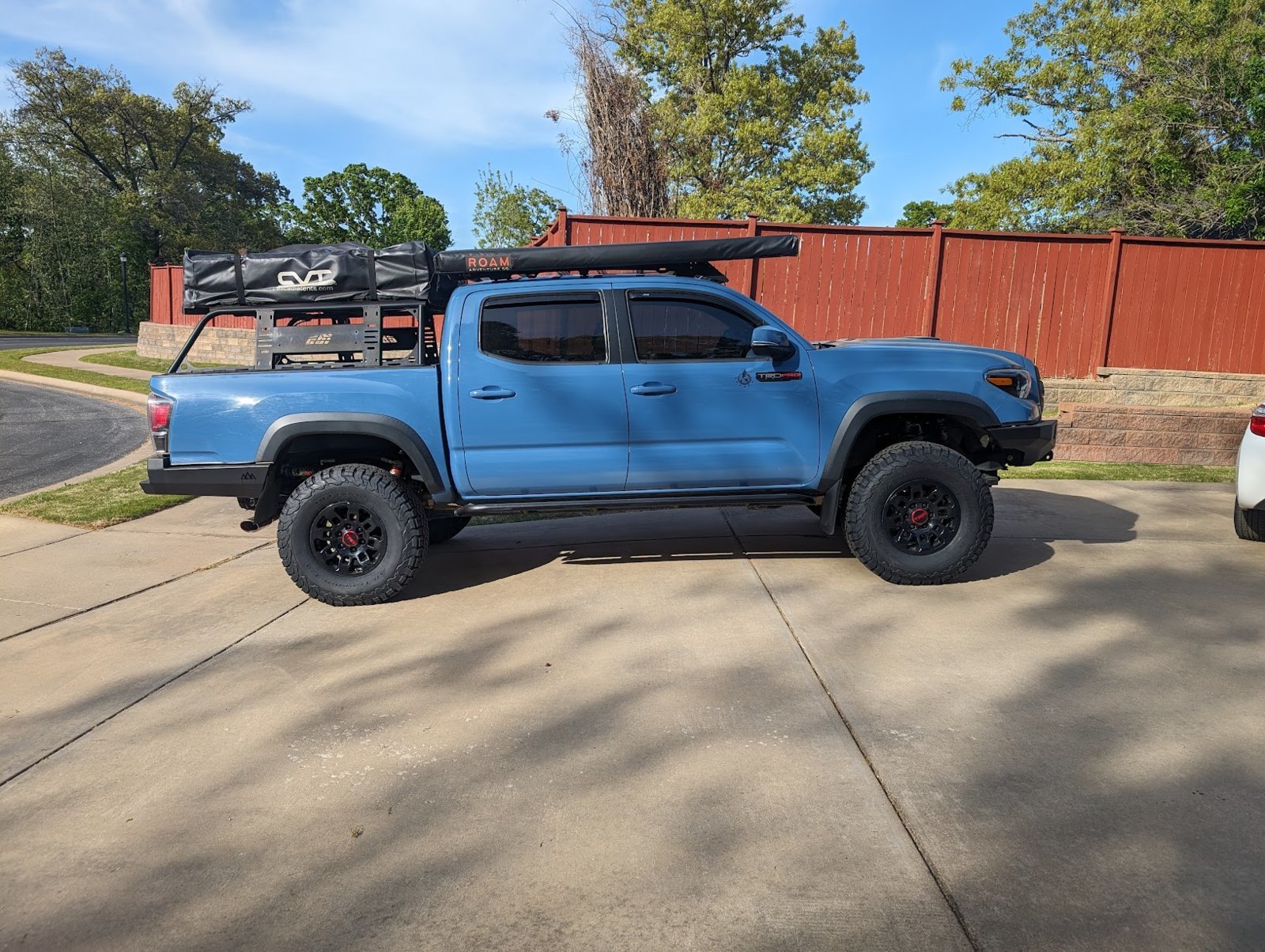

    UPDATE 2024/04/26
    Tires still had about a year of life left, but I could get new ones in 285/75 R16 for $229 each. Here's Bumbles now:

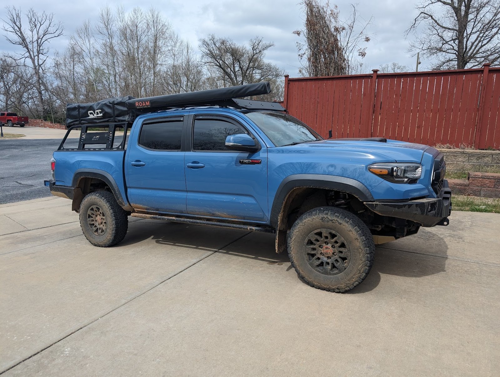

    UPDATE 2024/04/04
    So a few changes since the last update. It was getting close to time to rebuild the TRD Pro shocks, and considering what I've done to the truck I decided a full suspension upgrade to better handle the weight would be more appropriate. I went with a custom Accutune Stage 4(A?) kit with the following additions:
    - Accutune UCAs
    - Fox 2.5 Performance Elite front coilovers (custom tune)
    - Accutune front reservoir mounts (to avoid damage to the reservoir from the sway bar)
    - Deaver Expedition Stage II leaf springs
    - Accutune u-bolt flip kit with bump stops
    - Fox 2.5 Performance Elite rear shocks (custom tune)
    Other ADDITIONS to the long list below:
    - Decked drawer system
    - Backwoods Adventure Mods rear high-clearance bumper
    - Prinsu Roof Rack
    DELETIONS from the list below:
    - OEM roof rack (replaced by Prinsu)
    - OEM bed mat (replaced by Decked)
    - Firestone RideRite Airbags (yeeted, appropriate springs installed, weight less variable)
    - Plano bins (replaced by Decked)
    - Hi-Lift Jack (never needed)
    Loving how it rides and handles with the new suspension, and the Decked system is much more convenient.
