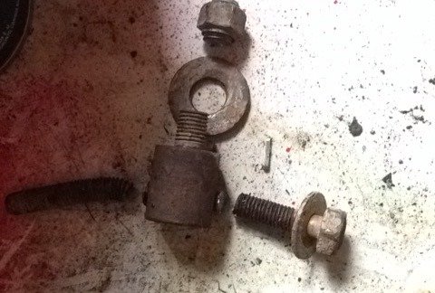

    your problem look a little like this? CF0F9DBF-D8C9-46AF-A2C8-FE5E65BDD080_zps_43293f67c0ffdd245565ccf011ca7c8af00a6daf.jpg

    wellll... thats why i asked what kind of vehicle. cause if you have a single belt. your alternator will not be working and you WILL kill your battery. and youll be just as screwed. you shouldn't drive without a belt unless it's an emergency. plus your water pump may not be working either, easily overheating your engine. so to be safe, you you can't just "drive w/out the f^@king belt attached". what's the belt running?

    OK, no driving w/out belt attached. Well I just fixed the truck tonight. Took off the pulley, unscrewed the rest of the broken bolt, replaced it then put the pulley back on. Not easy, barely any room to work in. Thanks for the help, couldn't do it without you guys.
