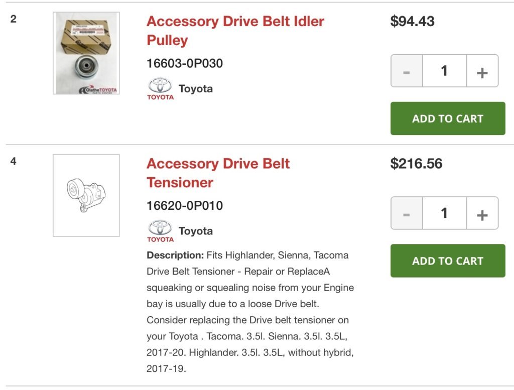

    Usually the bearing element wears out before the physical pulley or tensioner.
    $20 - $50 for replacement bearings vs:

    Plus the brg is a simple 20-30min repair compared to a Pita 2-3 hr tensioner swap.

    but that's only if you can find a bearing.
    i'd just rather be done with it, and order the $100 assembly than spend crazy amounts of time to save $50.
