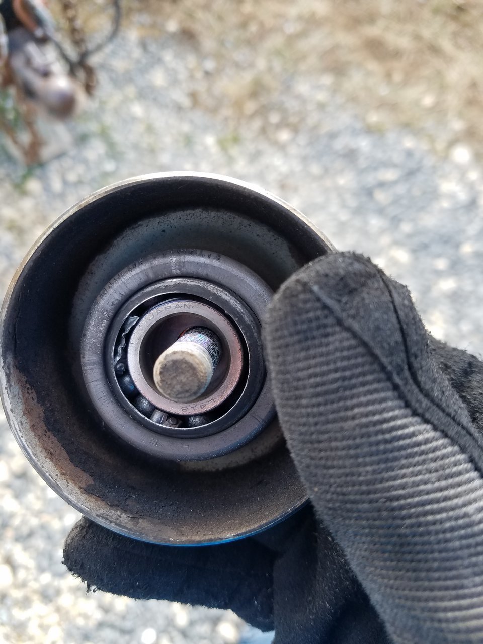

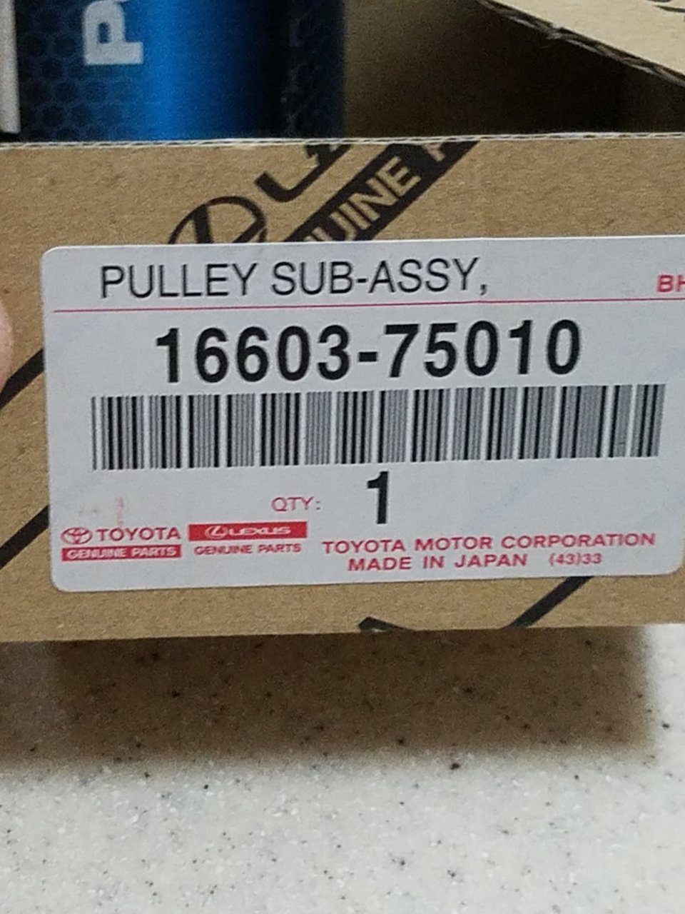

    20171229_112809.jpg 20171230_114221.jpg So below are the pictures that show the original pulley with bearing (or rather what's left of it) when I took it off. I also included a pic of the replacement pulley that comes with the bearing (made in Japan)
    Remember that this is for the second gen 4cyl engine...i don't know if it works for the 6cyl...but I suppose it's possible.

    Thanks for the part #. If you press out that bearing and replace it, you'll have a good back up. Get me the the bearing size if you can - for my bearing thread. Did you replace the idler pulley while you were at it? It's # 16603-0P030 - same as for the V6 idler pulley #1.

    I thought about that but I if you see the other side I think it ate through the race pretty good.

    @kidthatsirish Yes, you may be able to press it out. A chisel can be used to remove the race if it stays in place. The pulley should be ok.
