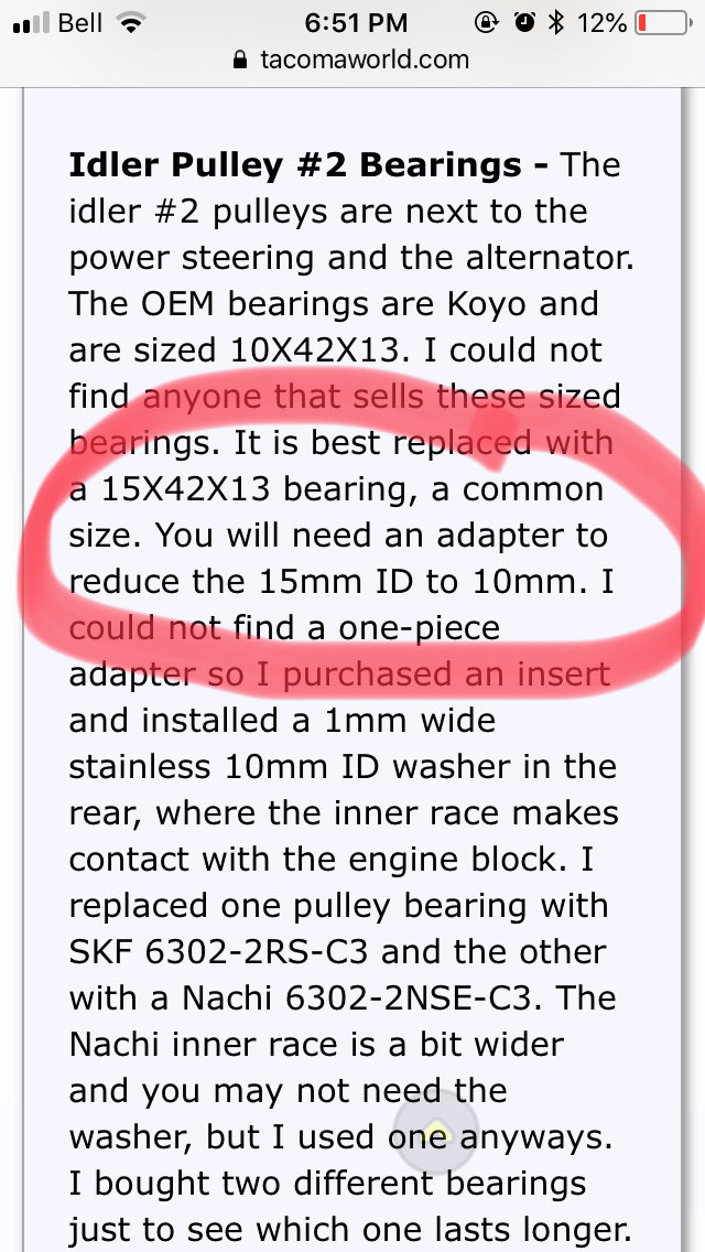

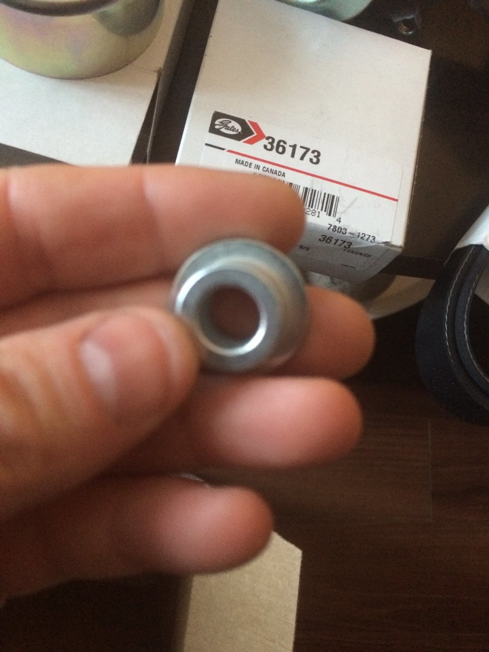

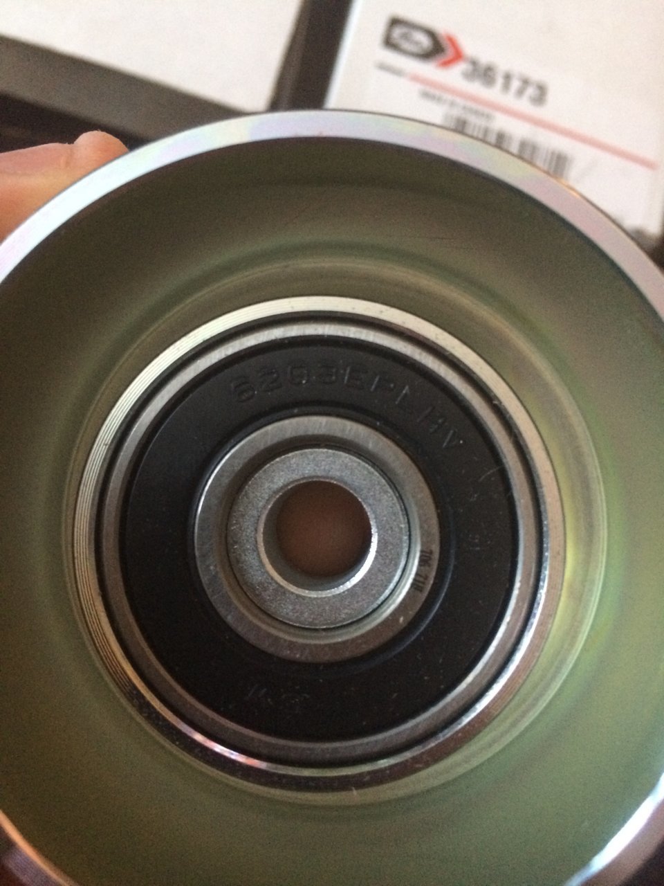

    The correct sleeve for the upper, should be around 0.405" ID from link above, i also know a guy who took the center out of his old bearing and put it in a drill and ran it up against a file to cut it down so it would act as a sleve in the new bearing
    i just bought the kit as my truck has 380 000km and i am sure it is all in need of replacing

    @Jon G so will these part numbers for the bearings I bought (I listed in the quote) not be direct fit if I press them? That's how I read it in this forum...
    https://www.tacomaworld.com/threads...arings-in-the-idler-tensioner-pulleys.480961/

    I ordered the OEM size listed at 10x32x14. Looks like I'm good to go! Thanks for all of your help! Means allot! Replaced my #1 pulley today but I still have that darn whistle. I am more sure now it is the idler pulley....
