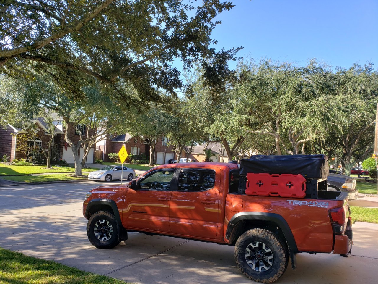

    are those the rotopaks?

    Yes, 4gal capacity.

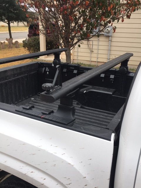

    its the Thule Xsporter Pro. i cut about 1' off each leg so it'd sit low profile like it is now.

    Did it clear the wheel wells when down

    can u take a inside the bed pic please ,I'm about to order a rack soon

    it sits just right above them, i'll take a picture this morning and upload them how they look after i cut them. Also, the hardware they give you with the rack wont fit the tacoma so you'll have to buy their separate mounting brackets. It was something called X4S...something along those lines.

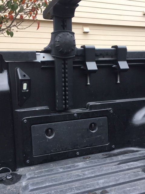

    @Ayeele

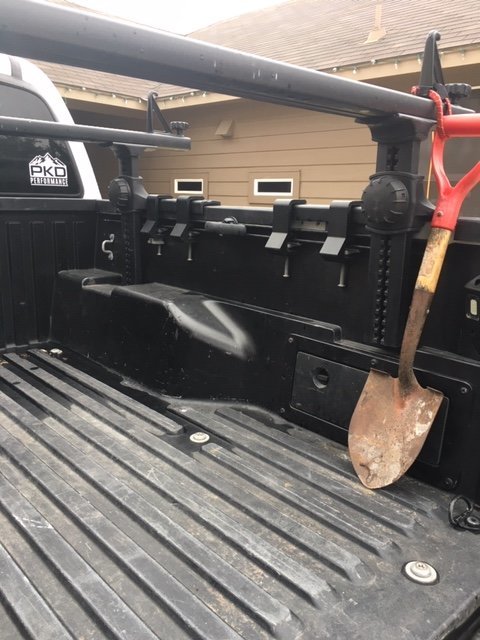

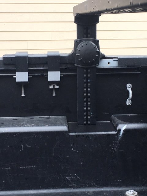

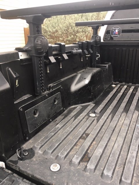

    Here is the inside. the brackets holding it to the bed you have to buy separately.

    Damn that takes up a lot of the rail space

    yea its got its cons, but pro's for me out weigh them
