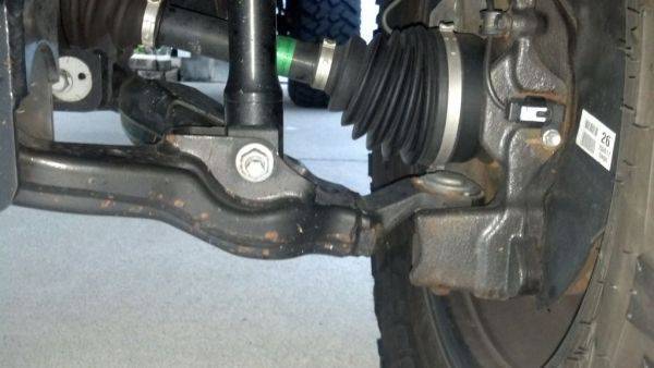

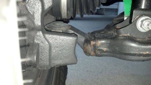

    A little lift & some extra steel....
    Grind your stops down until they look more like the pics I just put up.

    I would just grind a 1/4" off the stops at a time till it's acceptable....

    Mine looks exactly the same, just took these pics for you. Can take measurements if needed to compare to the pro comp guys. Before grinding I'd make sure nothing else is going to bind. Has to be a reason they designed it like this.
    I also recommend ditching the sway bar, much better ride without IMO.
    Edit: I'm at ~2.5"from the stop to the LCA stop at full lock, opposite side metal to metal. Any more and it looks like the tie rod end will begin to bind??

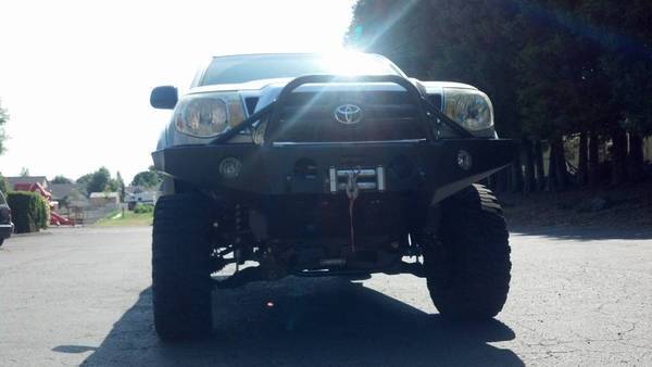

    Also from looking at this picture:
    It looks like your ABS line is just hanging loose, instead of being routed in the brackets that came with the kit. Not related to the turning issue but, definitely needs to be looked at.

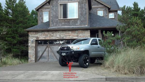

    which sway bar were you talking about? this one?(look at pics)

    Yes, that's the sway bar, will be 4 bolts on the center drop bracket and one per side on the spindle. You can always put it back on but most like the ride /added suspension flex without. Plus with the bumper on there it looks out of place dangling

    Is it just me or is the OPs sway bar upside down ?

    Wonder if that could cause exaggerated loss of turning radius...i thought it was an optical illusion with the front bumper:tinfoilhat:
