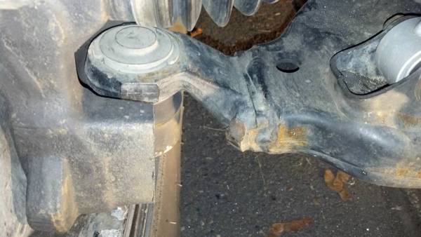

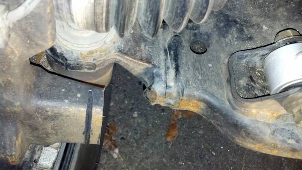

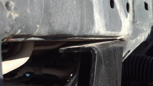

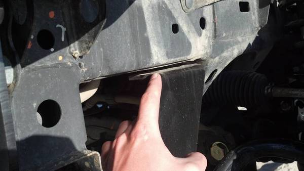

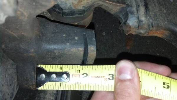

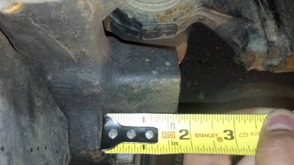

    so after all your feed back and answer about my problem i decided i'd pull the trigger and just start cutting sh*t left and right :D
    i added some pictures of my entire process for those who decide to follow my route
    i measured to show how much i cut off on mine, if you cut your stoppers, you dont have to cut off as much as i did.

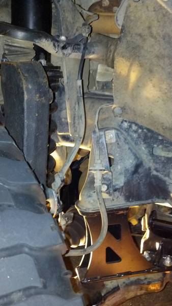

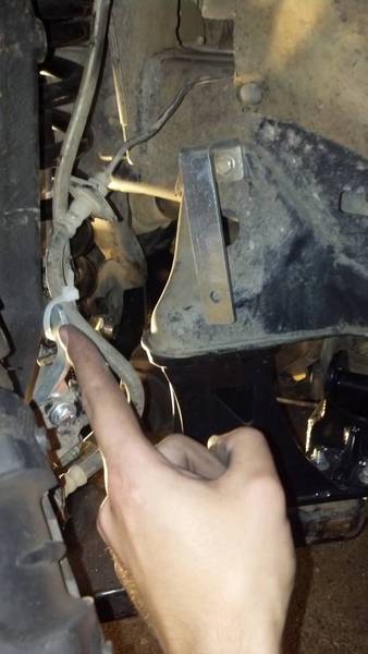

    this is after cutting the stoppers i ran into a little problem on both driver and passenger side next to the coil spring the i had to move over so that my tire did not rub when turning
    Its a brake line extension after getting the 6" Fabtech Lift
    Had to do the same thing on both sides (driver and passenger side)
    ---Thats where i moved the brake line i attached it to the arm-----------
    This is something i found in the shed, came with a free diamond blade which i used
    now i can finally turn normally like how i did before the lift.
    thank you again for all and everyone's help, hope my problem ended helping somebody with the same issue

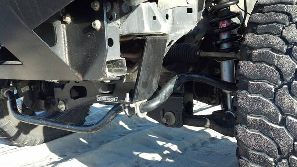

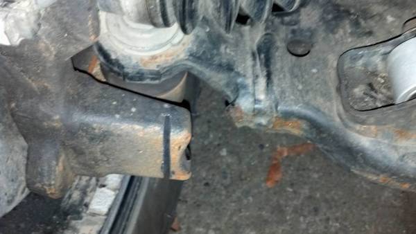

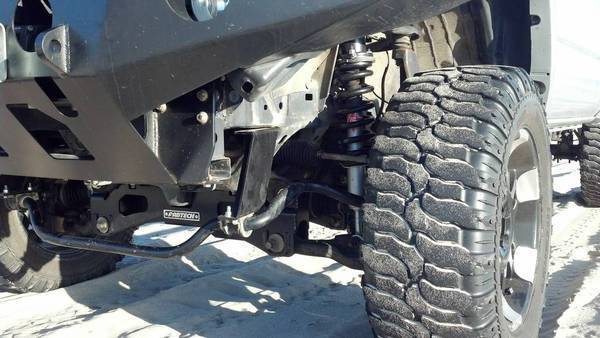

    also for those who have a sway bar in the front after a 6" lift, rip that f**ken shit off and toss it before its too late!!!!!!!!!!!!
    cuz i went to the beach and went off-road.
    30mins in i start hearing and weird thumping noise under the front end
    once i decided to check it out this is what i find....
    it was so much force that 2 bolts that hold the sway bar were ripped out with no thread left at all to rebolt the bolts
    had to drive home with a strap holding the damn thing up so it wouldnt hit my CV joints

    wow this thread is a god send,,just bought a truck with a 6" fabtech lift and holy cow you cant even turn the damn wheels its that bad..i was wondering what the problem was and what a solution might be and this thread covers it all
    hey OP if your still around i was wondering you mentioned you didnt need to cut off so much off the stoppers,,it looks like you cut it back to 1 3/4 if you had to do it over what would you say would be adequate like maybe 2 1/4 overall length?
    by the way nice truck
  7. Jun 15, 2017 at 9:04 PM
    #47
    ShOwStOpper
    ShOwStOpper Well-Known Member
    Oct 11, 2016
    #199525
    99
    In case this helps anyone else you dont need to hack off the stops to 1 3/4 you'll just rip the sway bar off i cut mine to just a tad under 2 1/4 long and if i turn hard the tires will just barely brush the sway bar not hard enough to do any damage and the turning is much better..
