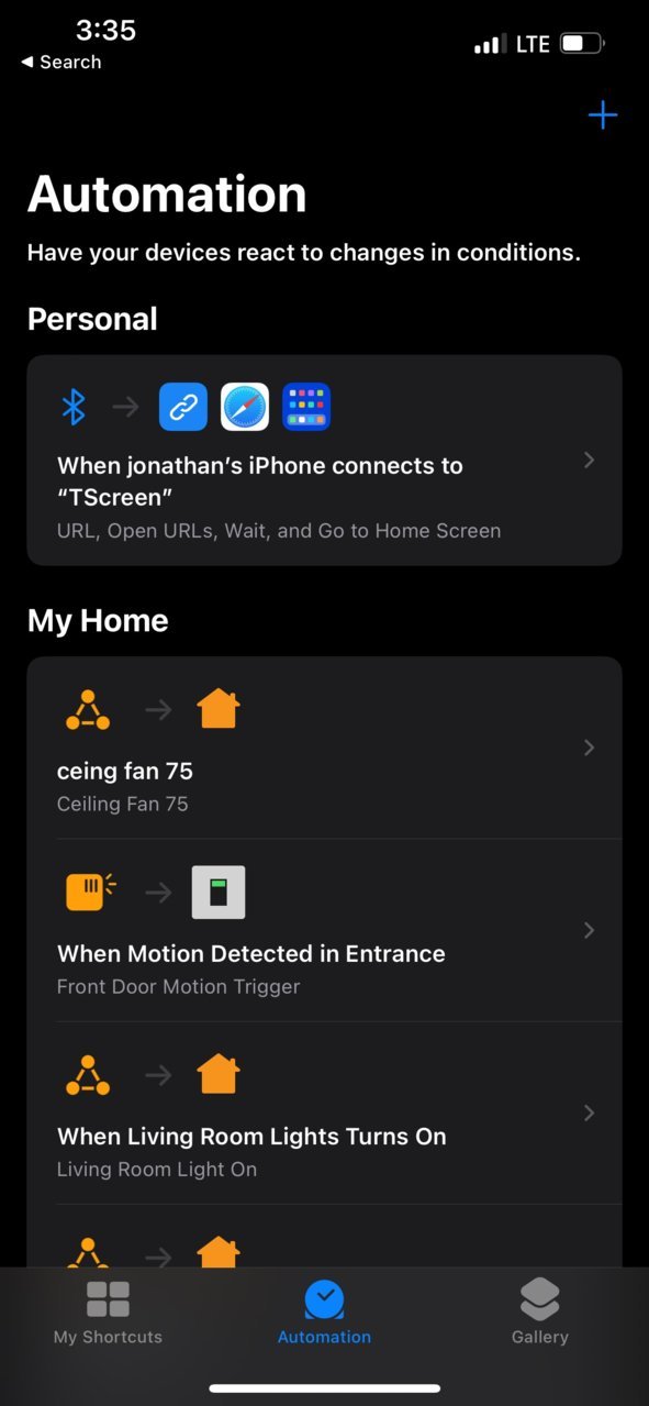

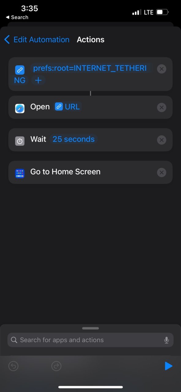

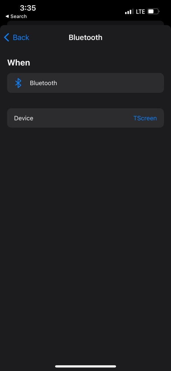

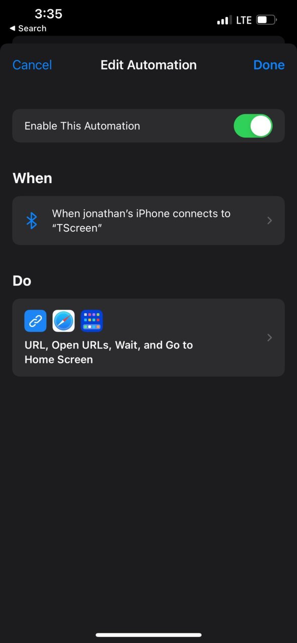

    You can also make a personal automation to run when Bluetooth connects to the android radio. Apple does not let them run without asking so there is still a click involved.
    It is the same as the shortcut above but will ask to run anytime it connects to the radio. In my case, it's called Tscreen.
    I cant share it but this is what the settings look like.
