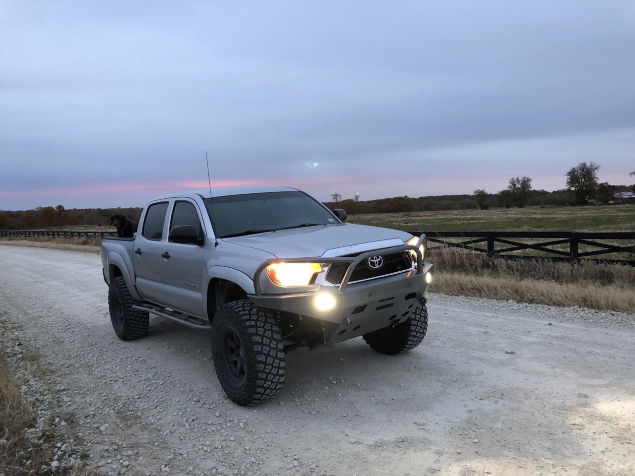

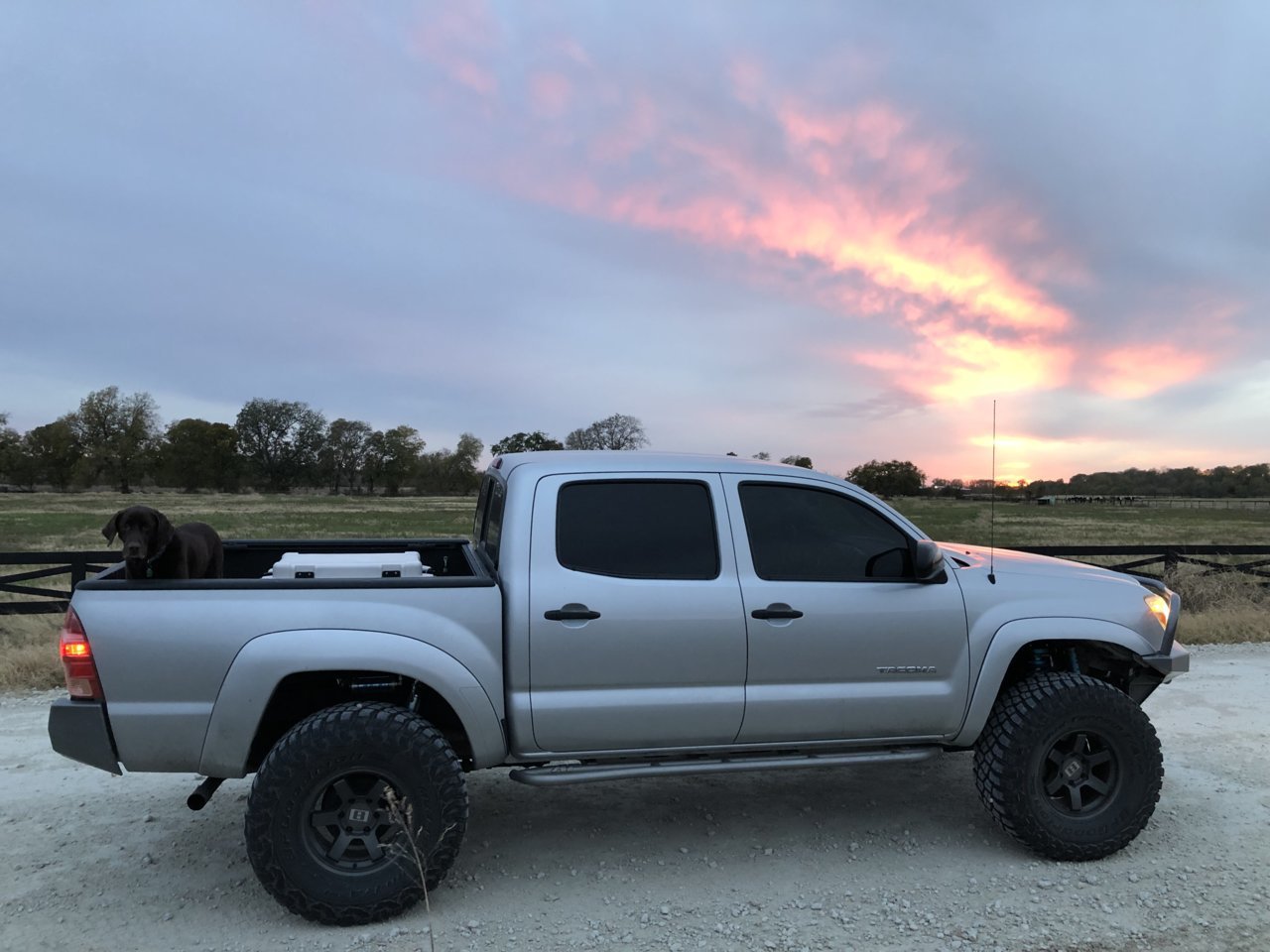

    How it sits today:
    December 2018
    Suspension:
    700# King 2.5 w/ resi Front
    King 2.5 w/ resi Rear
    Wheeler's 2" AAL
    Bilstein 5100's Front(Removed)
    Bilstein 5125’s Rear (Removed)
    OME 886’s (Removed)
    Wheeler's Superbumps Front
    Timbren Offroad Bumps on Rear
    Sway Bar Removed (rides so much better!)
    Wheeler's extended brake lines
    Wheels and Tires:
    Level 8 MK6 16x8 0 offset Matte Gunmetal
    BFG KM3 315/75/16

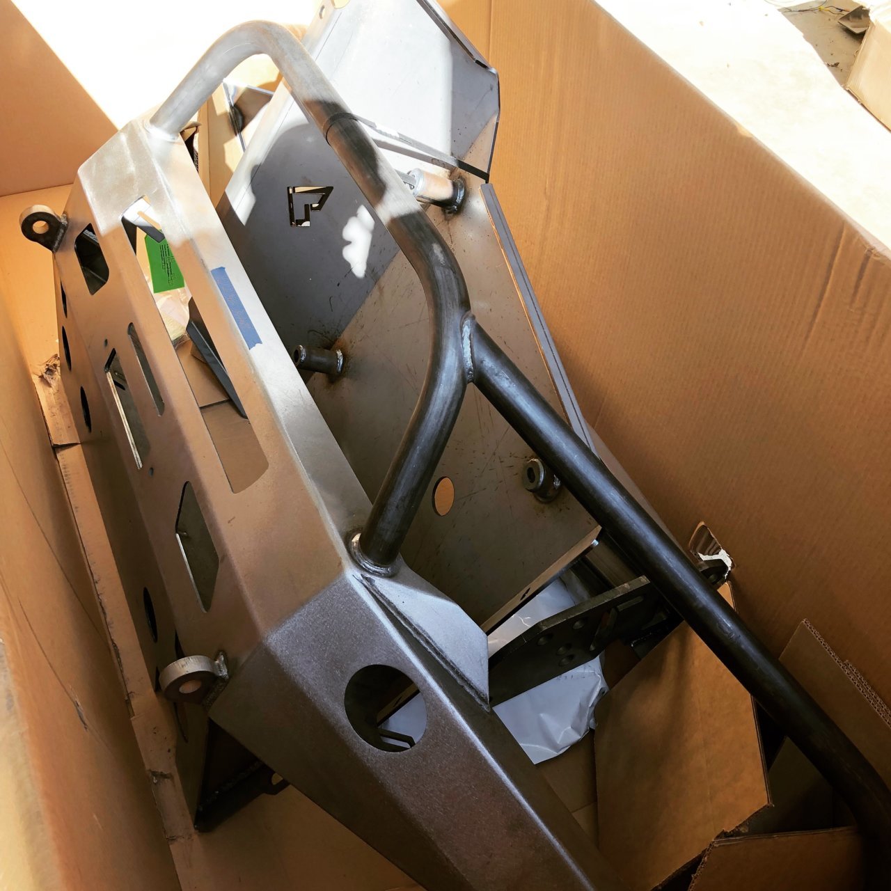

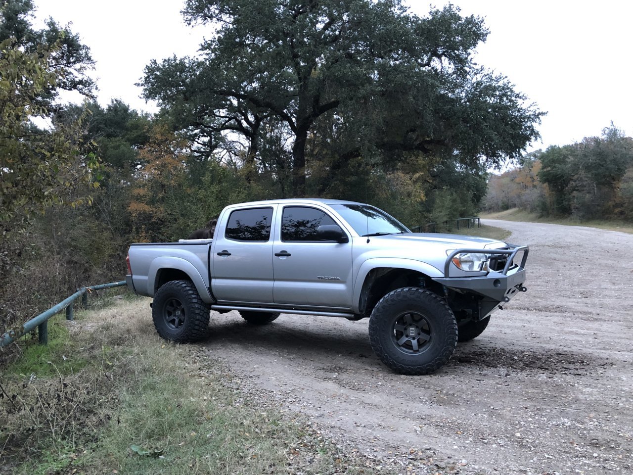

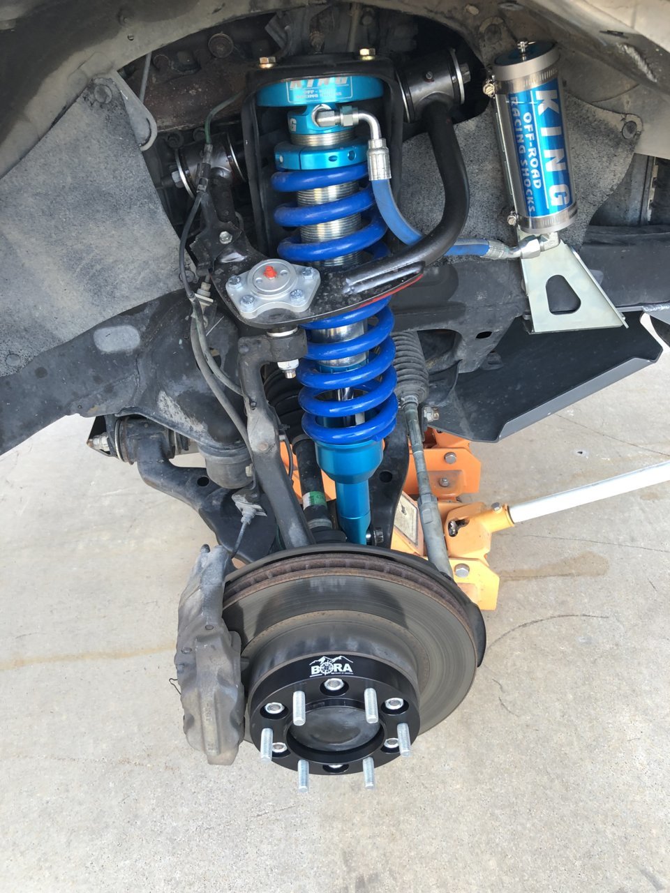

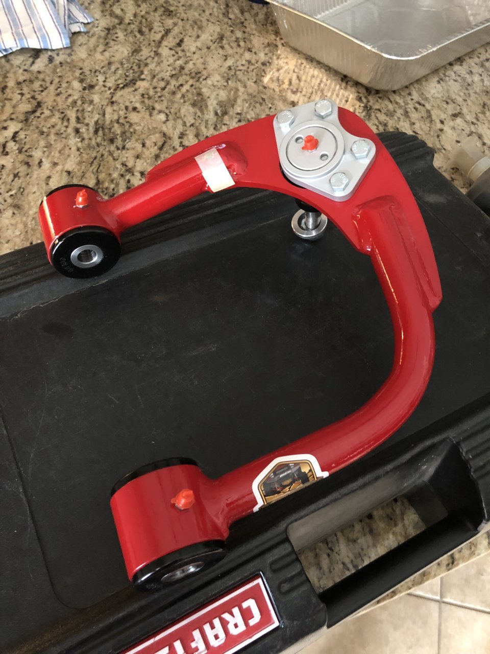

    10F7B033-26F2-4A91-96D4-95EB387A5412.jpg 7BAC24F6-A6F4-45FB-A2DC-404769AB8150.jpg I figure it’s time to update some of the progress made on the truck. Got my new Pelfreybilt bumpers and skid plate in December of 2017. Absolutely amazed at the build quality and how well the design was thought out.
    Once I got them back from getting powder coated it didn’t take me long to install them. Then it was off to Hidden Falls to try them out. Wasn’t disappointed in the slightest with the new bumpers.

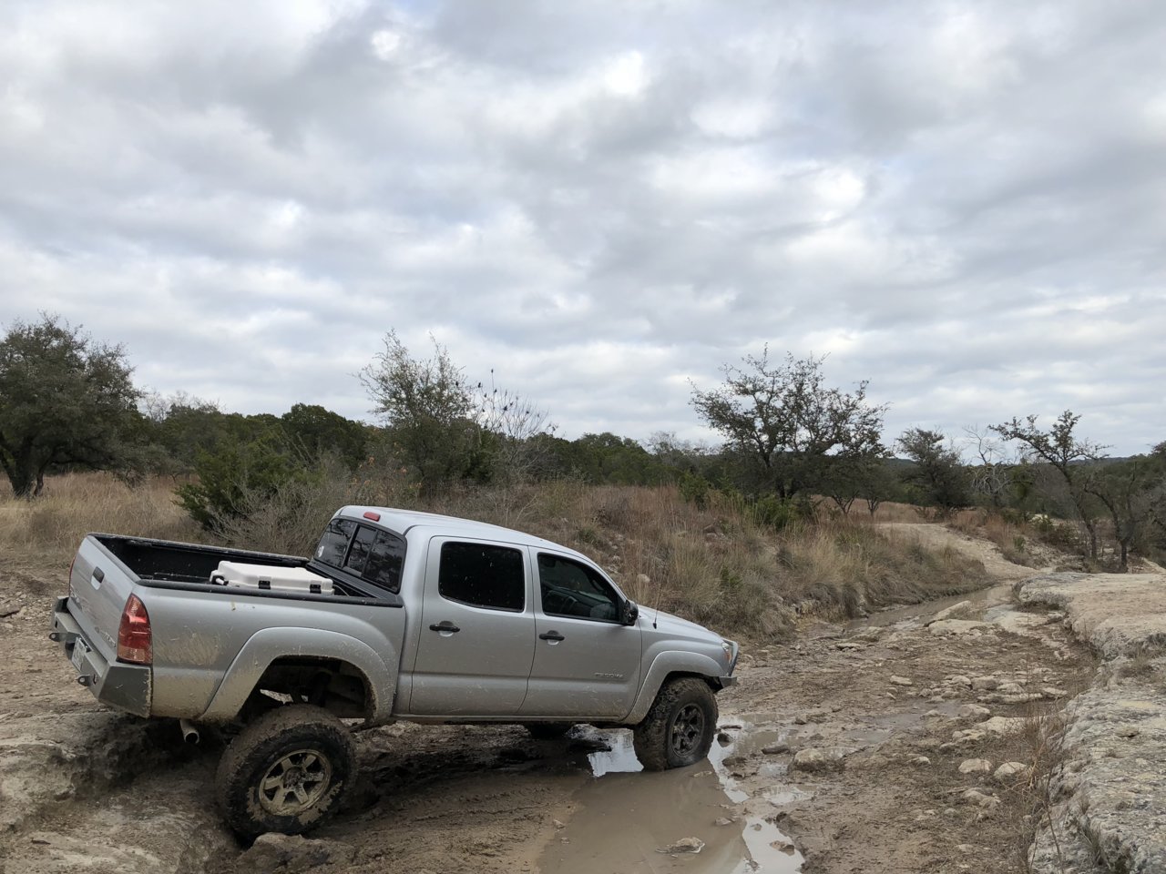

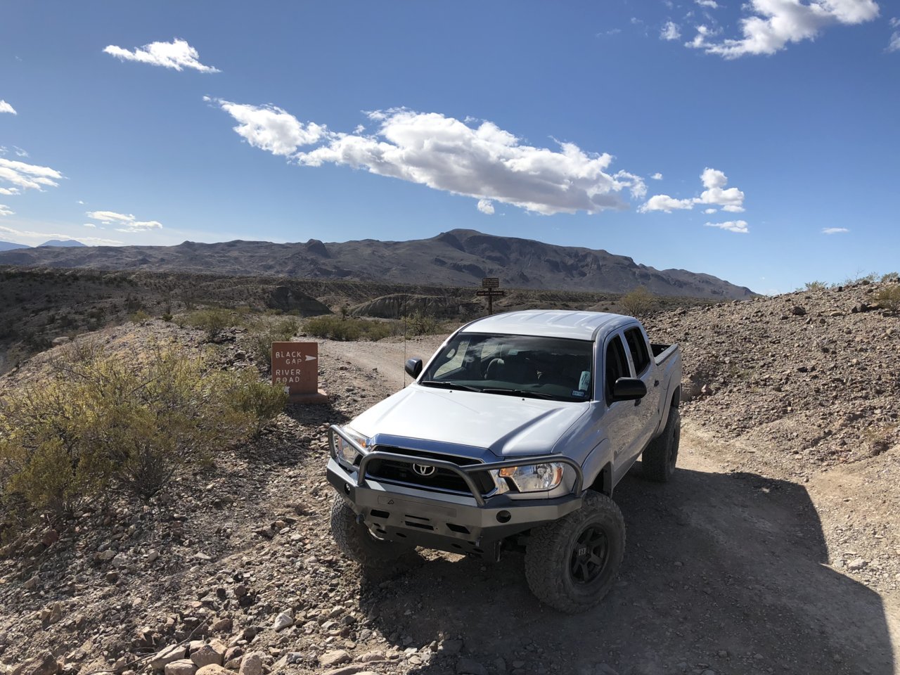

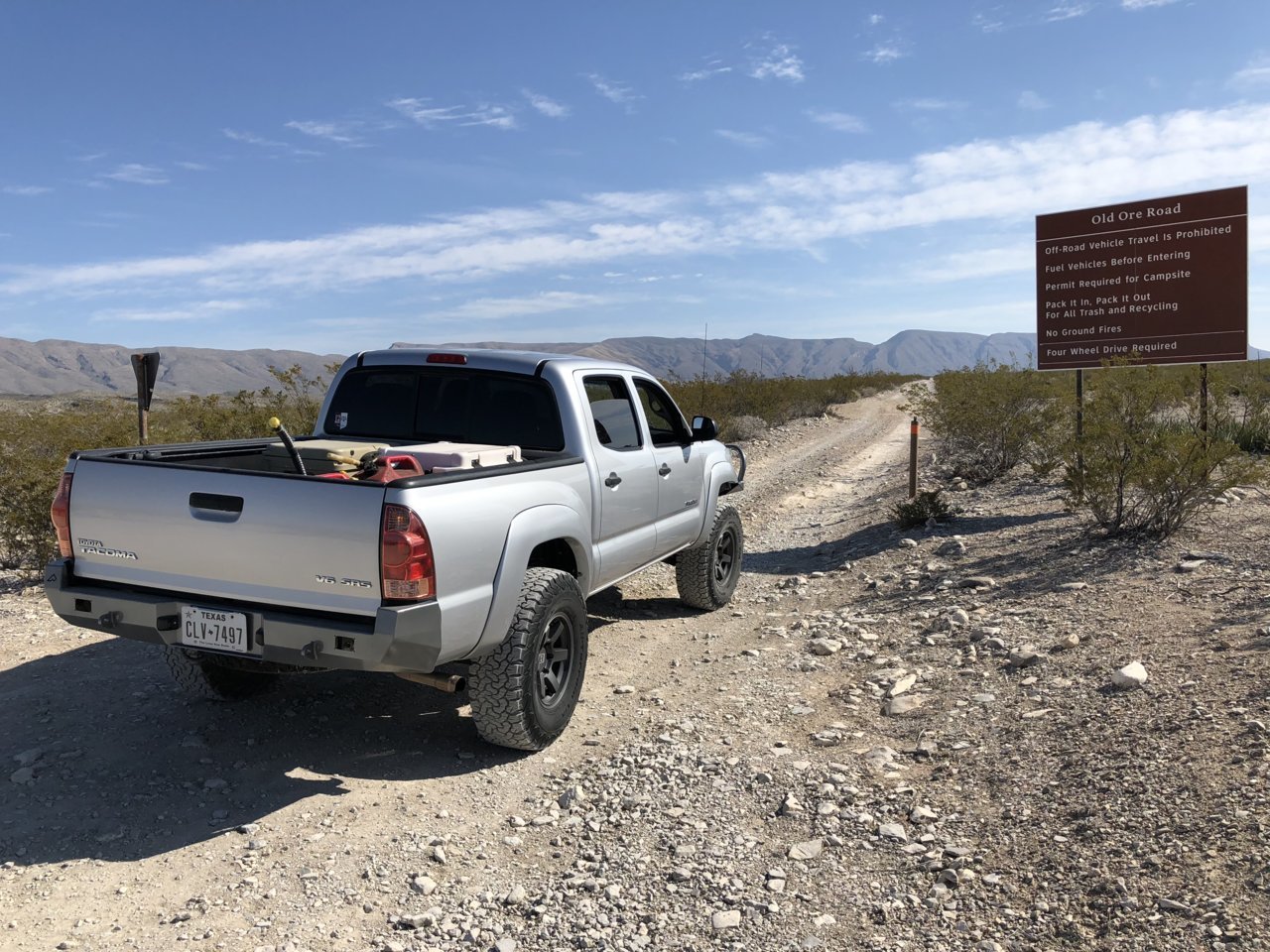

    Then it was off to Big Bend National Park. Went out there with no set plans other than driving every mile of trail out there. This trip just made my love for the Tacoma platform grow even more.
    I ended up liking it out there so much that I went back a few weeks later for another few days. I highly recommend doing a trip out there. Just be sure to bring tons of food, water and fuel. I would go an entire day out on the trail and not see another person. Most people you run into just had a water bottle and no supplies.

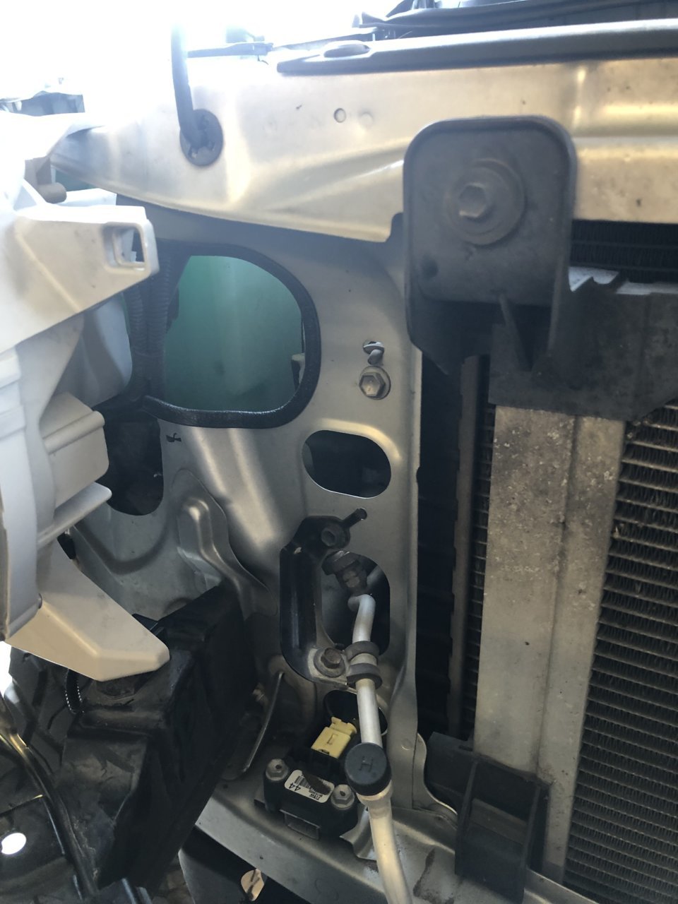

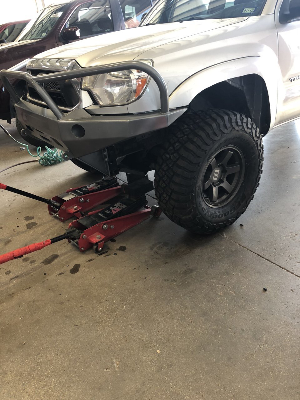

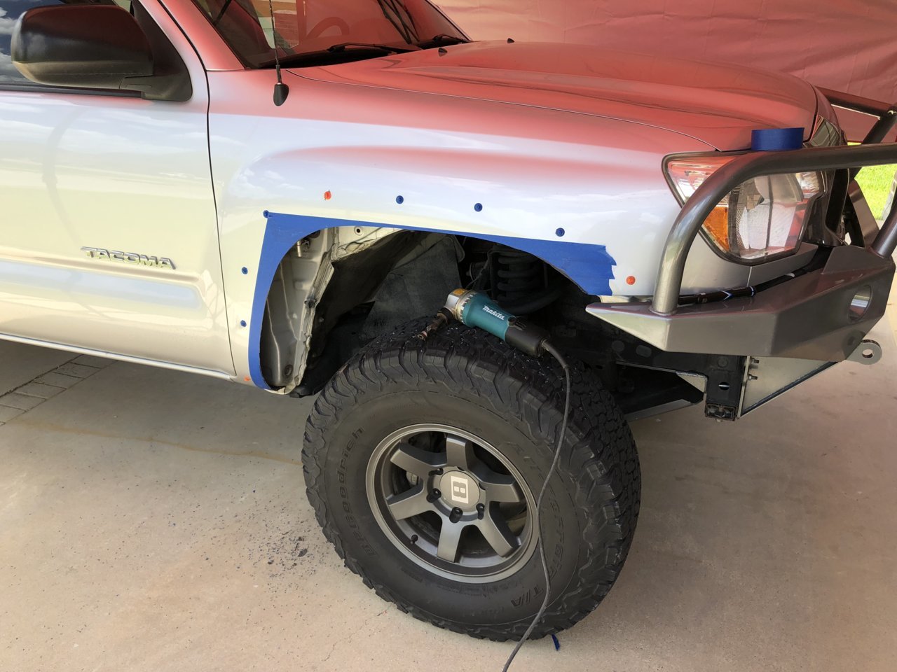

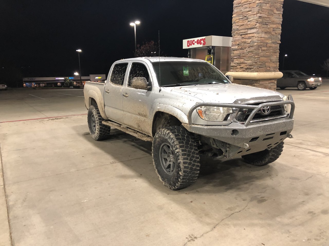

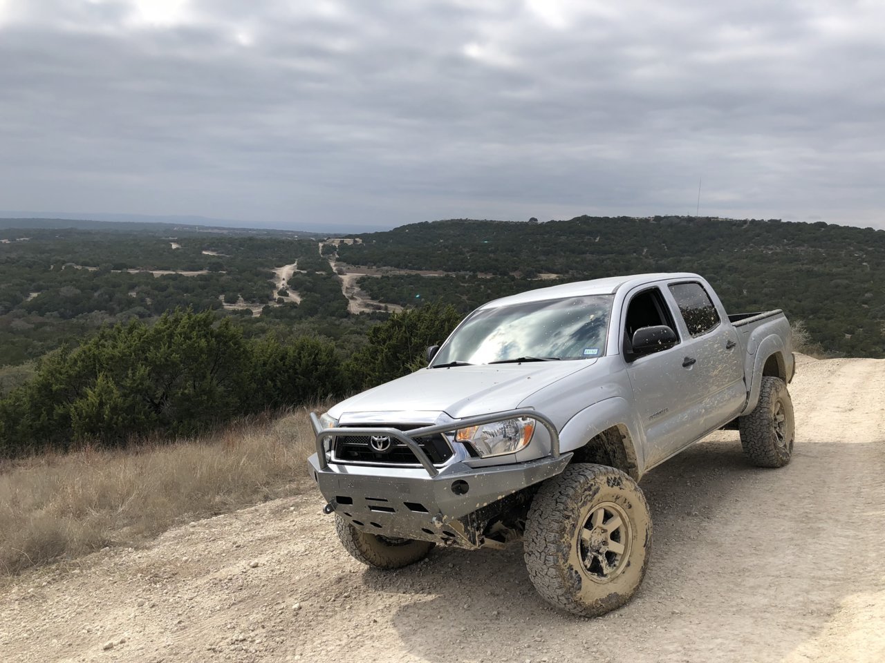

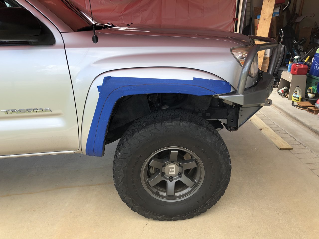

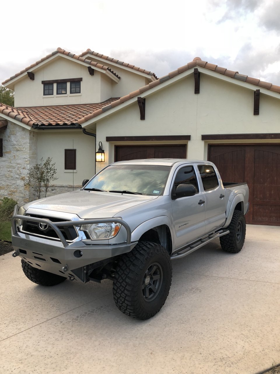

    Well, decided it was time to do some trimming on the truck. It wasn’t an easy decision to cut into the fenders on my truck.
    Obviously the trimming was for a reason. BFG had just released the new KM3 Mud Terrain, so I got the first set of 315/75R16 in Texas! I’ve since put over 10,000 miles on these tires and have zero complaints.

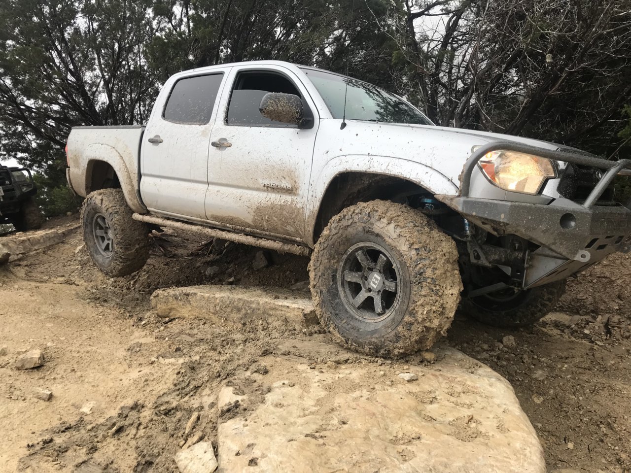

    Next mod was a set of All Pro “bolt on” sliders that I got from a fellow member here on the forum. Just because they are called bolt on sliders doesn’t mean they are an easy install. Drilling the holes in the frame was a major pain in the butt.
    Yes, I fixed the washer location on the UCA ball joint before tightening them up.

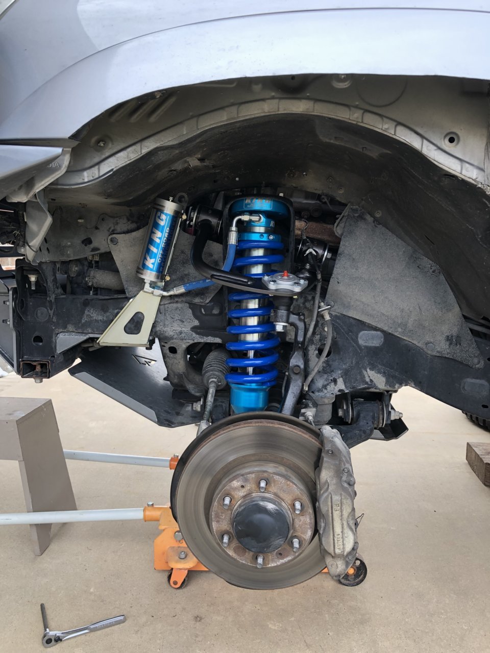

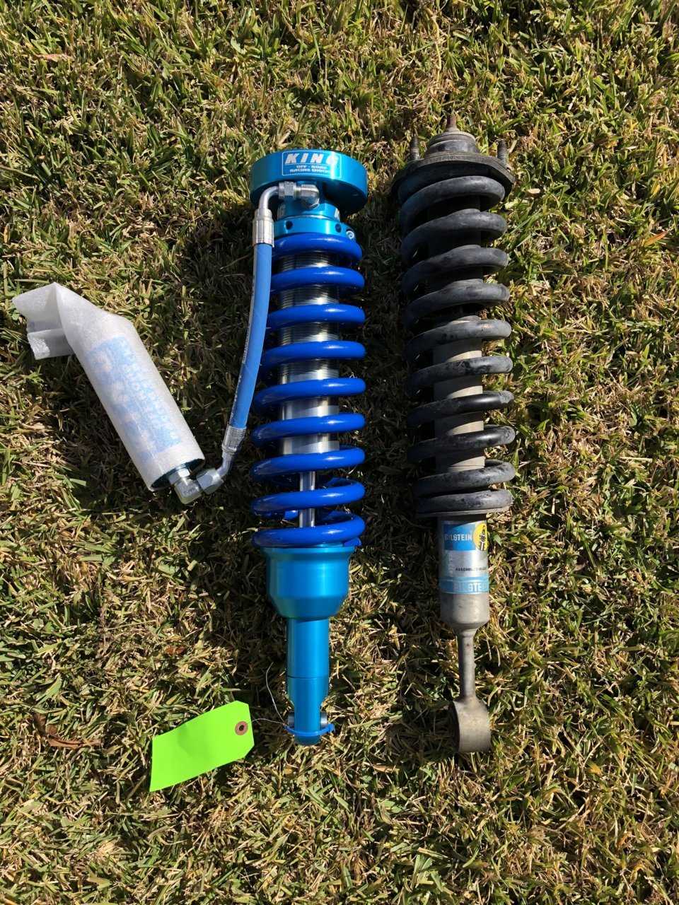

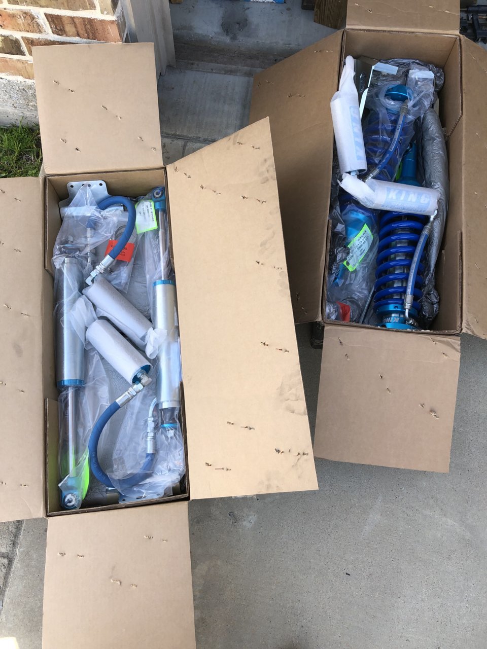

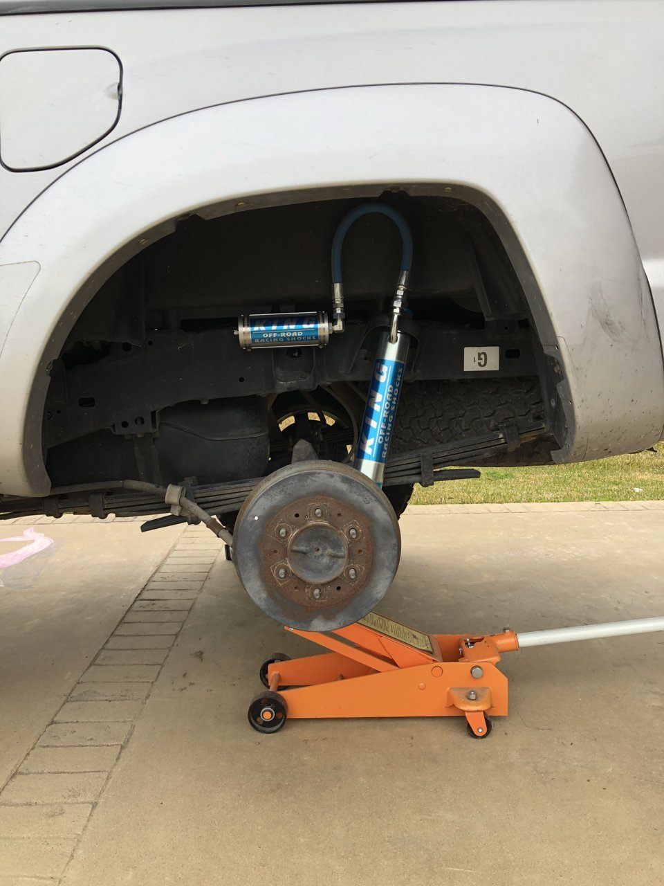

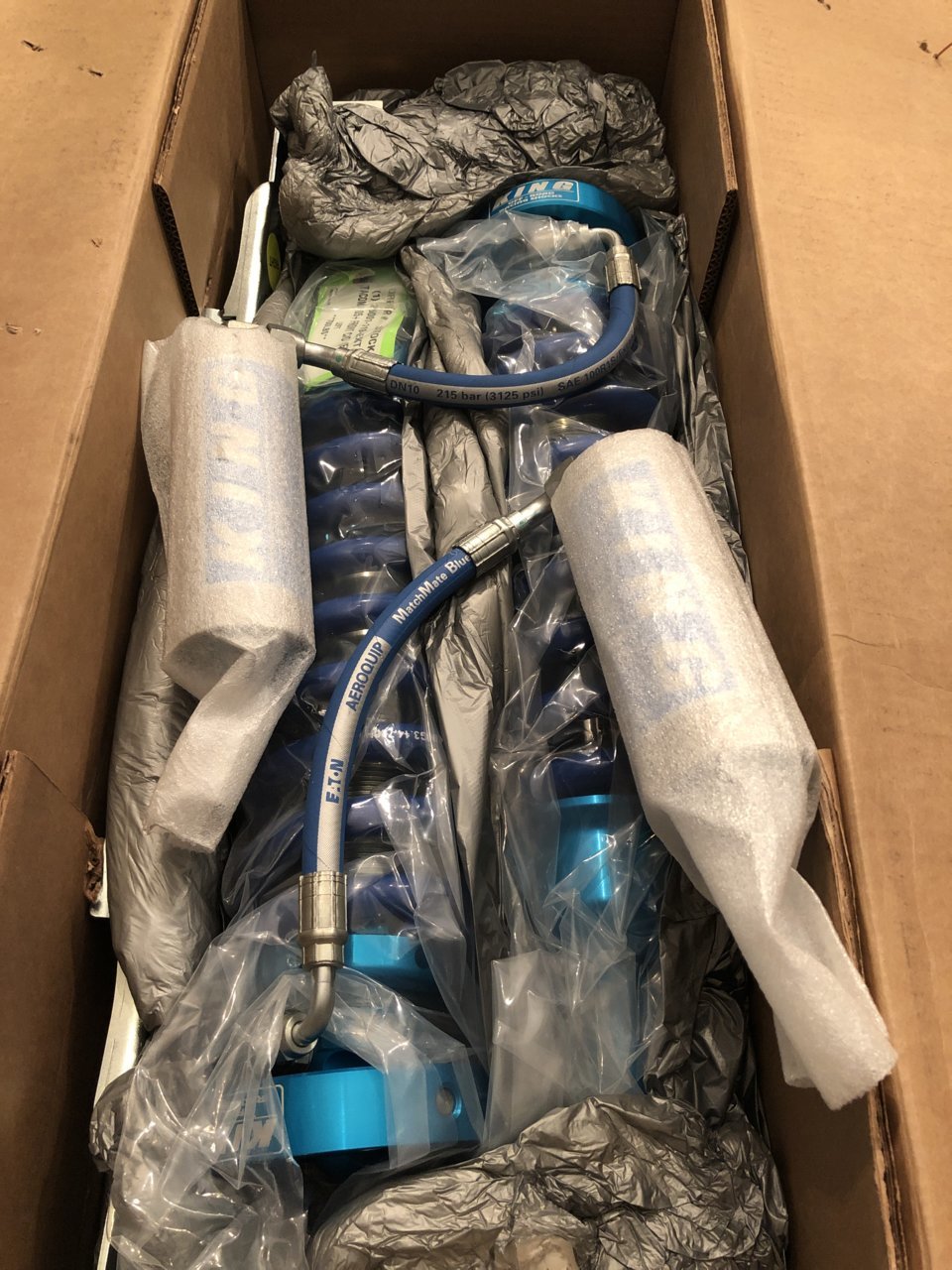

    After a recent trip out to the ranch it was painfully apparent that my Bilstein shocks were done. I’ve been putting off upgrading my suspension for years, and now it was time. I would have gone back with the same thing, but honestly the Bilsteins don’t cut it when you drive 75+ miles a day off-road (when overlanding). The Kings were my dream setup, so I ordered the fronts from Down South Motorsports and the rears from JBA. The JBA upper control arms come powder coated red, but that looks horrible when paired with Kings...I almost didn’t buy them for that very reason! A little spray paint took care of that problem. I honestly didn’t really need to go all out and buy the Kings, but the ride is truly amazing!

    Crippling Debt
    With the coil overs, is the ride softer? Or does it feel floaty? I am not sure what coilovers are like compared to billy’s.

    I would not describe the ride as being floaty. It still has a planted feeling on the road and corners better with less body roll and nose dive under heavy braking. The King shocks have made dirt roads feel like fresh paved asphalt which was unexpected. They did not make my truck feel like riding a modern dirt bike that feels like riding on a cloud however. I'm currently slightly over sprung till I add the weight of a winch in the front bumper and carry my camping load out in the bed...meaning that the ride will only get better. Honestly, high end coil overs are one of those things you have to feel to understand. You can do normal driving and wheeling without them, but you won't want to be without them when you cover miles of trail without stopping...shock fade is a real thing. Kings made my truck ride better than my dads new Yukon Denali both on road and off...hope that answers your question some.

    King 2.5's Front and Rear 700# coil, 2" wheelers aal, 315/75R16 BFG KM3's Pelfreybilt Front and Rear Steel Bumpers, All Pro Sliders, 4.56 Gears
    Had to add some 1” Bora spacers to prevent rubbing at full lock. The Bora spacers are an impressively well made product. I remember when bolt on spacers first started coming to market and they were nowhere near this quality level.

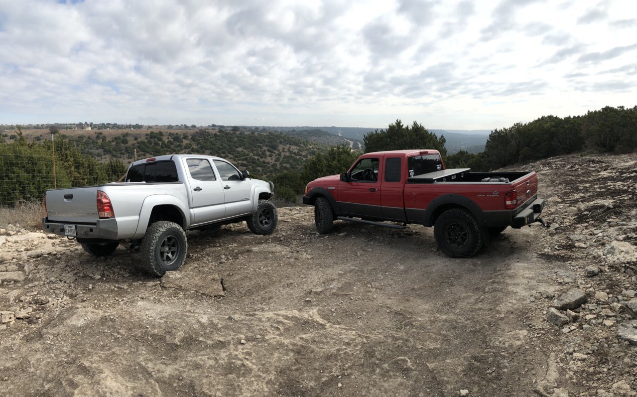

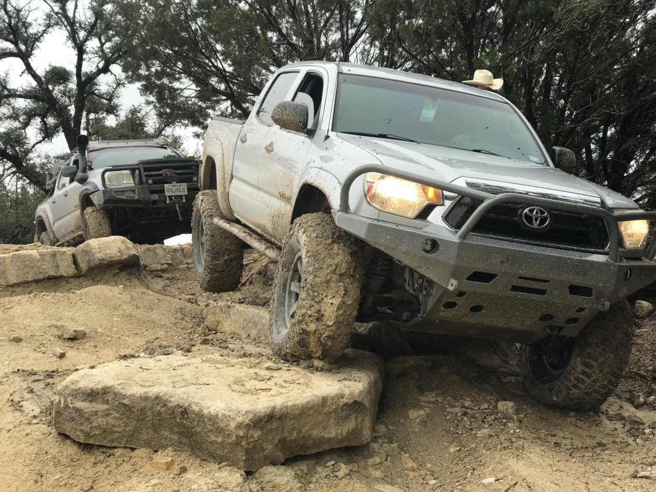

    Had a great time this weekend wheeling with several of the central Texas guys. The shake down run was pretty successful, and only minor modifications are needed. Going to redo my alignment to get a little more caster, then some more hammering on the front fender pinch weld.

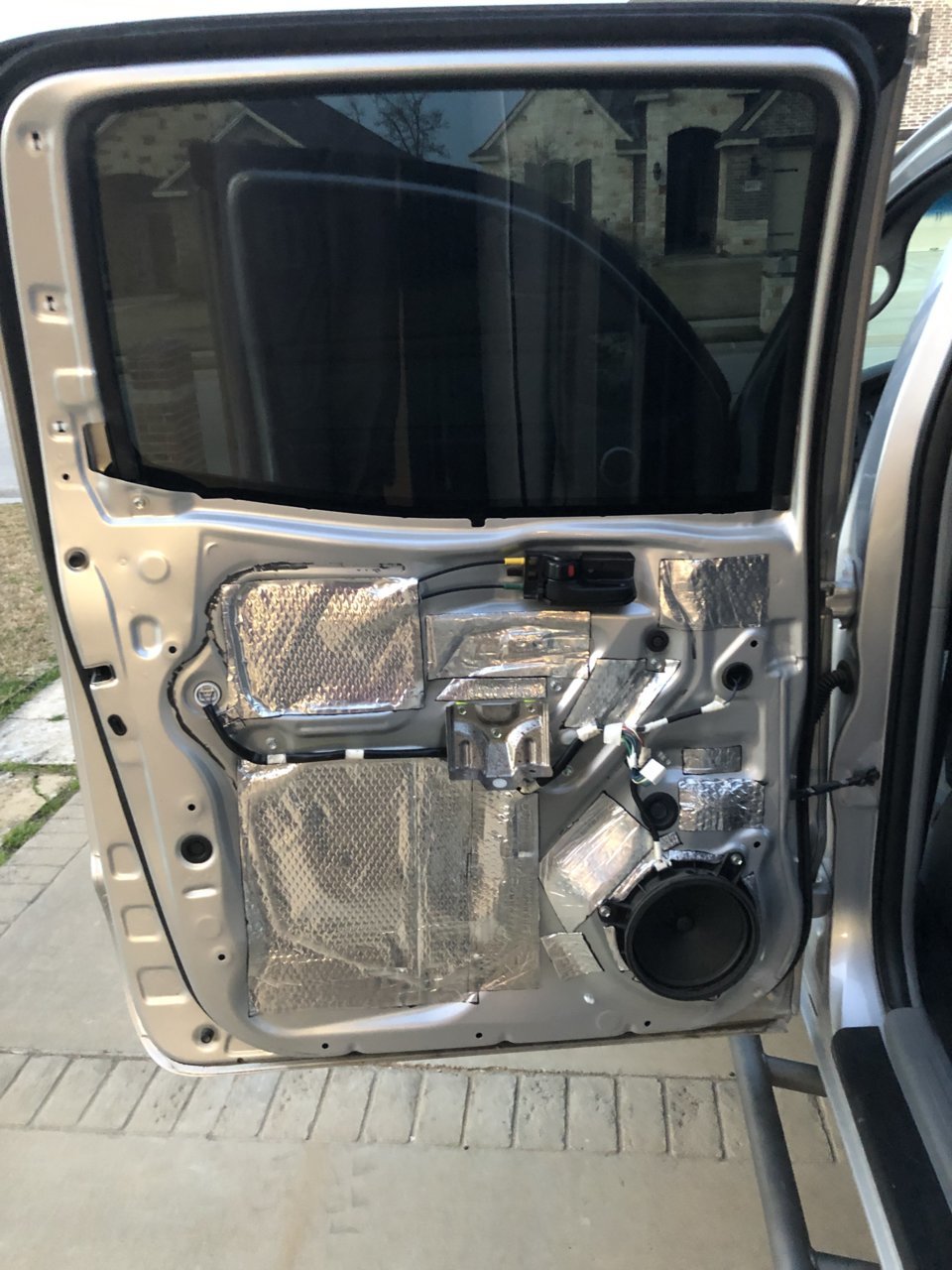

    Broke down and sound deadened the truck. I swore I would never install this in another truck, because it’s not a fun install. Pro tip is buy disposable rubber gloves...avoided the thousands of cuts from the material this time. Installed the Noico butyl and foam insulation on the inner and outer skins of all the doors, the cab floors, rear cab wall and the entire roof. Made a noticeable difference in the cab noise levels, and even made the factory speakers sound better. Used 54 square feet of butyl and 36 square feet of the foam sound insulation. I meant to take tons of pictures, but I was focused on just getting the install done.

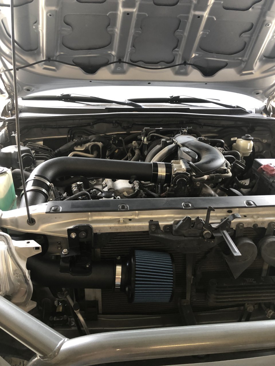

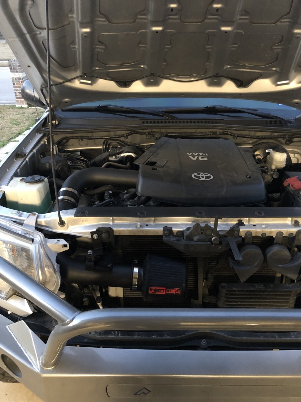

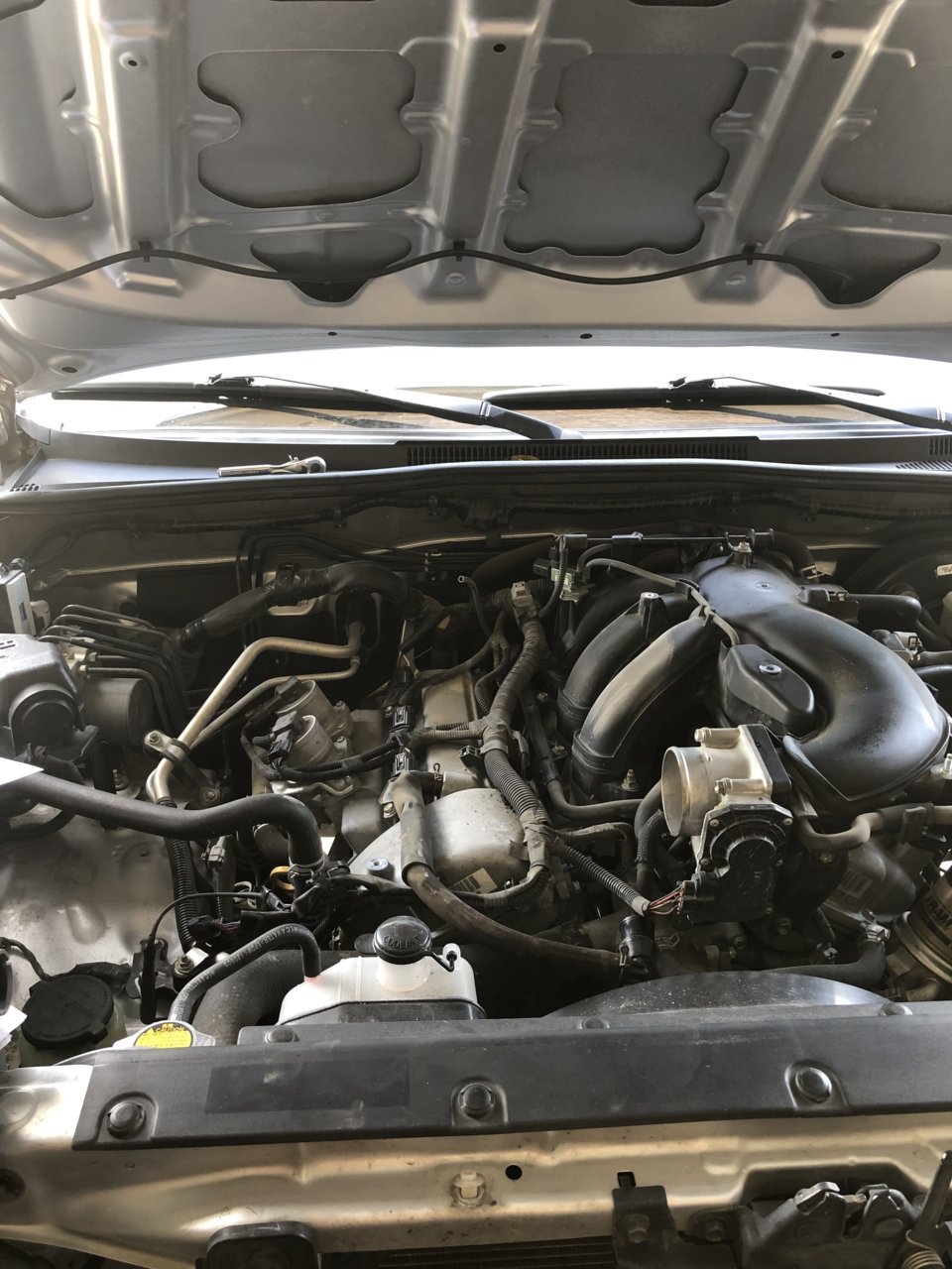

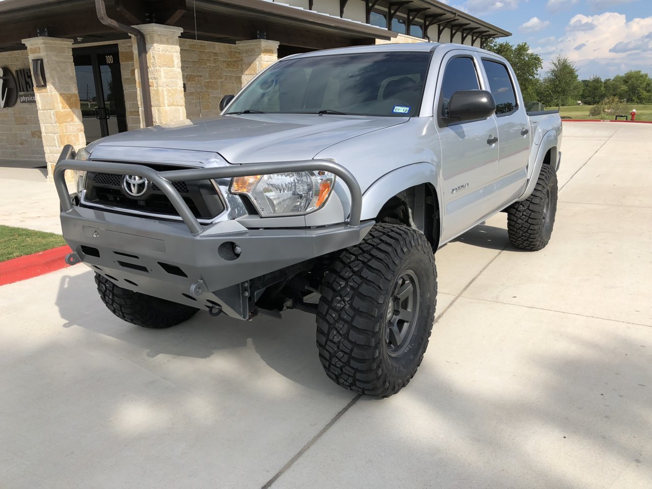

    I’ve put a couple hundred miles on the truck since installing the URD intake and can’t report any significant gains in MPG. The cab noise is less though during regular driving. No regrets with the purchase though...I no longer worry about my truck on dusty or muddy roads.
