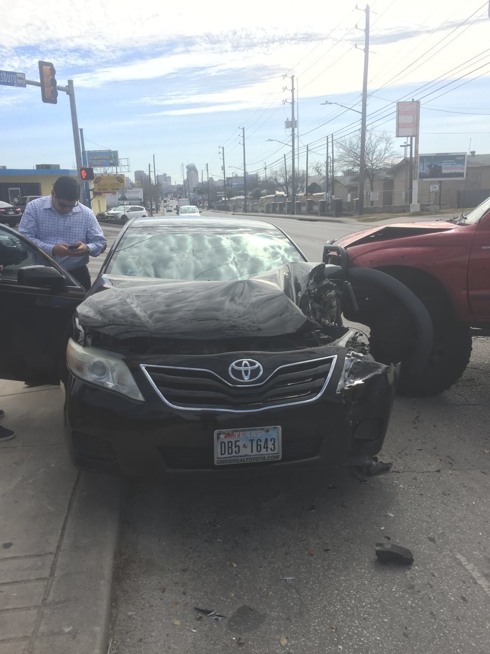

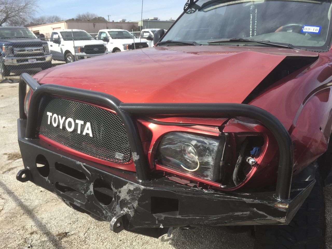

    IDK man this bumper saved a lot of things here. Stock bumper wouldve been fucked, airbags, destroyed everything.
    https://www.tacomaworld.com/threads/plate-bumpers-after-impact-with-pics.379600/page-3#post-10556815

    So what you're saying is that if I bolt a steel I-beam to the front of a Prius, it'll ram anything like an tank and not damage the rest of the car? Sorry, but I actually paid attention in Physics class and the energy from a crash has to go somewhere. If the steel I-beam doesn't absorb it - which it will not - then it gets transferred to whatever the I-beam is connected to.
    As for the HD front bumper in those pics, notice what part of the Camry it impacted. Again, it was the "soft tissue" and a nice air filled left front tire. What might be very interesting is to see that exact HD bumper and truck impact an identically prepared truck at maybe 10 MPH - head on. I think you'd be astounded at the force (energy) transferred to the frames and even the drivers.

    The energy went to the hood obviously that's why it folded along with the fender. My premise is that had it been a stock bumper on the truck the engine bay would've been compromised as well, along with the supercharger, aprons, etc. But guess what, not even the radiator (plastic POS) cracked.

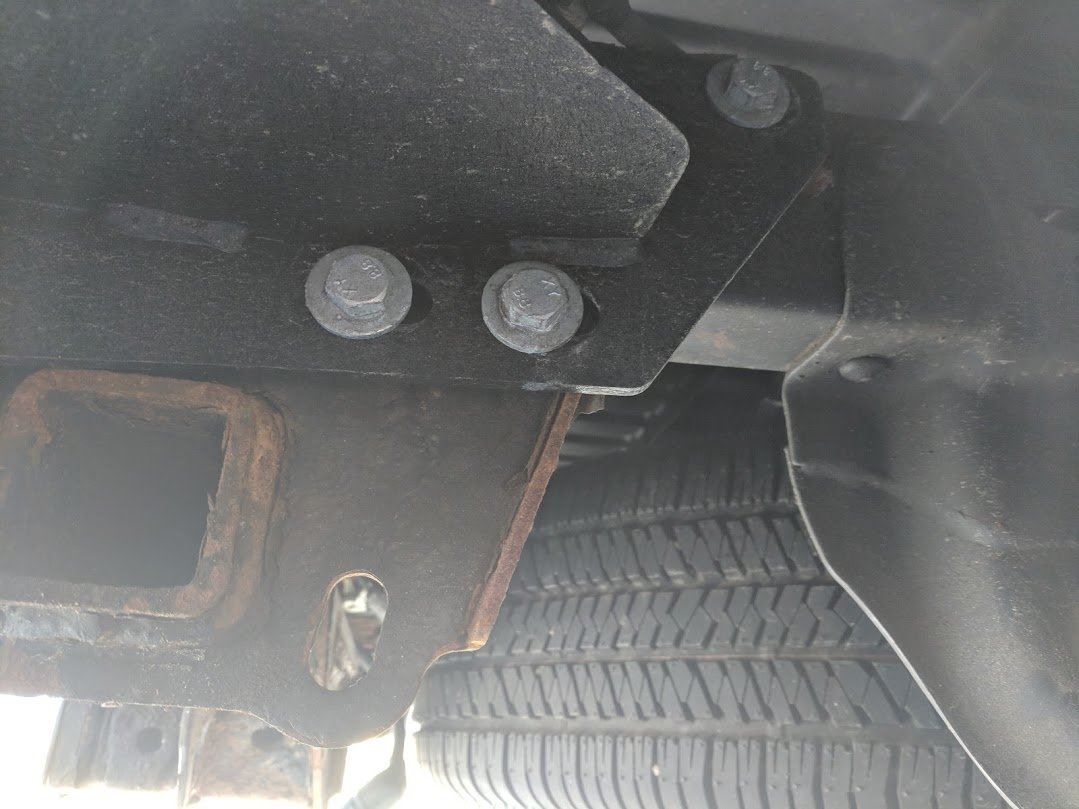

    The bumper did move a bit according to this photo. Note bolt position. So slightly forgiving i suppose.
    br6OoStVSFNOcNZl9qc-mo_as6IVM6qGSOLB__S2_c1775fb010ebe82391f64431eea69f542c22b346.jpg
