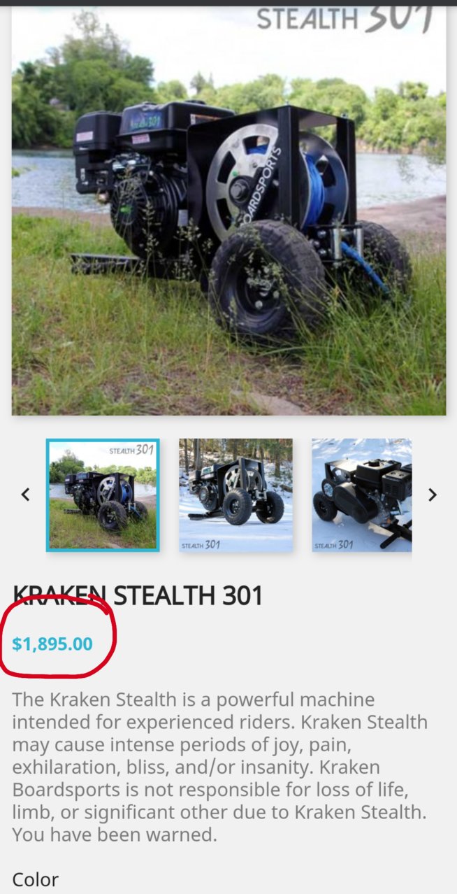

    Maybe he plans on using a wakeboard winch. >26 fps and 1200 feet of rope. And it comes with its own motor, no need to tap into a power source.

    You cropped the pictures wrong. We need to make sure everyone can see how much money they're saving. :rofl:
