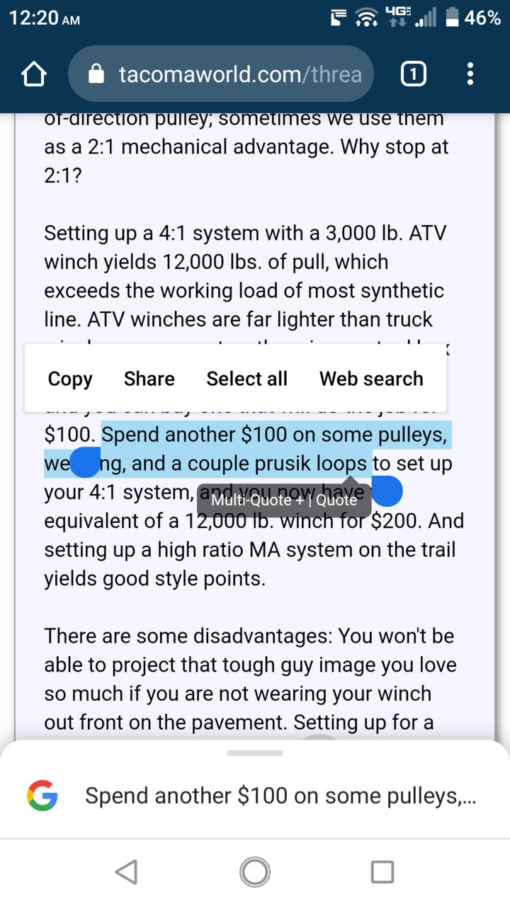

  1. Sep 15, 2020 at 8:52 PM
    #461
    Skierrichy
    Skierrichy MadRad
    Jun 10, 2018
    #256051
    5,397
    Richard
    Willington
    2011 TRD
    To many, but never done
    :rofl:
    I can't exactly pull from the neighbors yard.
    And that uprooted tree was wanting to drag my truck off of 2 snatchblocks
