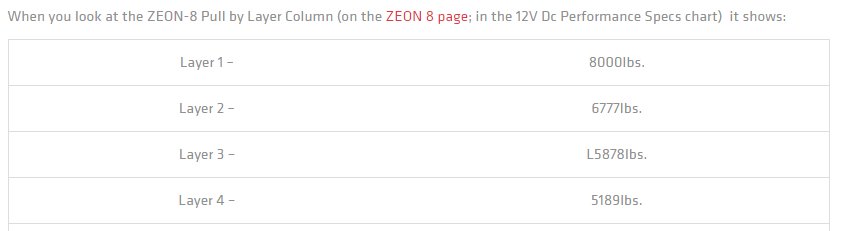

    OP's math also doesn't figure in that your winch's 8K, 12K, etc rating only applies in a certain configuration, such as line only covering the first spool of the drum.
    Per the below math from Warn, if you have 4 layers left on the winch pulling to a close obstacle, your 8000lbs winch is only pulling 5200, but your 12,000lbs winch is still at 7,800 which would still give you a good ARR/AGR margin to factor in slope and mud stiction
