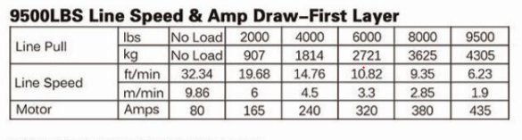

    Let's compare line speed too. Using no load as a consistent point of reference.
    ATV winch 13.3 feet per minute. Now add 4 pullies. That gets reduced to 3.32 feet per minute.
    Smittybilt XRC Winch 32.32 feet per minute.
