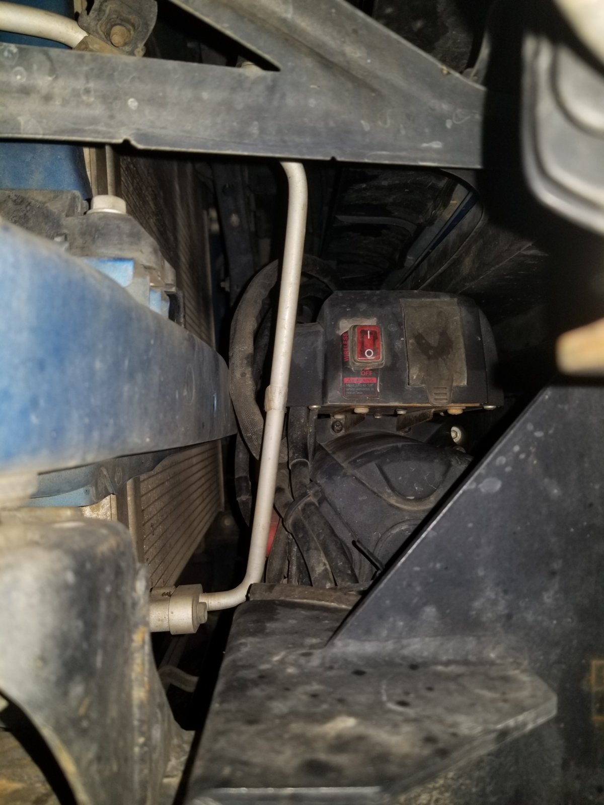

    My smitty let's me mount the solenoid box offset to the right/left keeping it low enough to jam in my bumper. I don't know how much tighter a low pro bumper is, but I didn't want to relocate my solenoid either.

    It's an x20 in a victory 4x4 bumper. Its really crowded in there, so I only have some side shots, but mounting the solenoid on the side let's it sit under all the front end bracing. I've only had to use it a couple of times, but 2.5 years of sitting in montana winters and it still works just fine. I also like having the wireless remote too. My only gripe is it's kind of hard engage the free spool, but that's only because I buried it in the front end. I guess if I thought ahead, I could have clocked the free spool so that I could get to it from the front. I imagine with a stealth bumper you can't get to it anyways.
    CLVol1255 likes this.

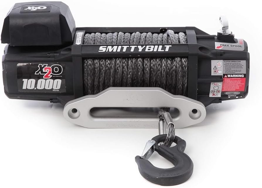

    The ones I’m really researching at the moment and am most interested in are the smittybuilt X20 Gen 3
    Open Road Panther 2
    Warn Vr Evo 10s
    Super winch 10 synthetic
    Rough country 9500 Pro Synthetic
    does anybody here have any real life experience with these good or bad and have info on the control box or solenoids being relocatable? Thanks for your input

    Oh nice! That looks solid and you didn’t have to relocate the control box as far as I can tell by the pics?

    Yeah, it comes with a bracket that lets it sit over the left side of the drum like the pic shows. I really didn't want to relocate it to the top of the bumper or under the hood like a lot of guys do. That way I didn't have to do custom wiring or brackets or anything.
