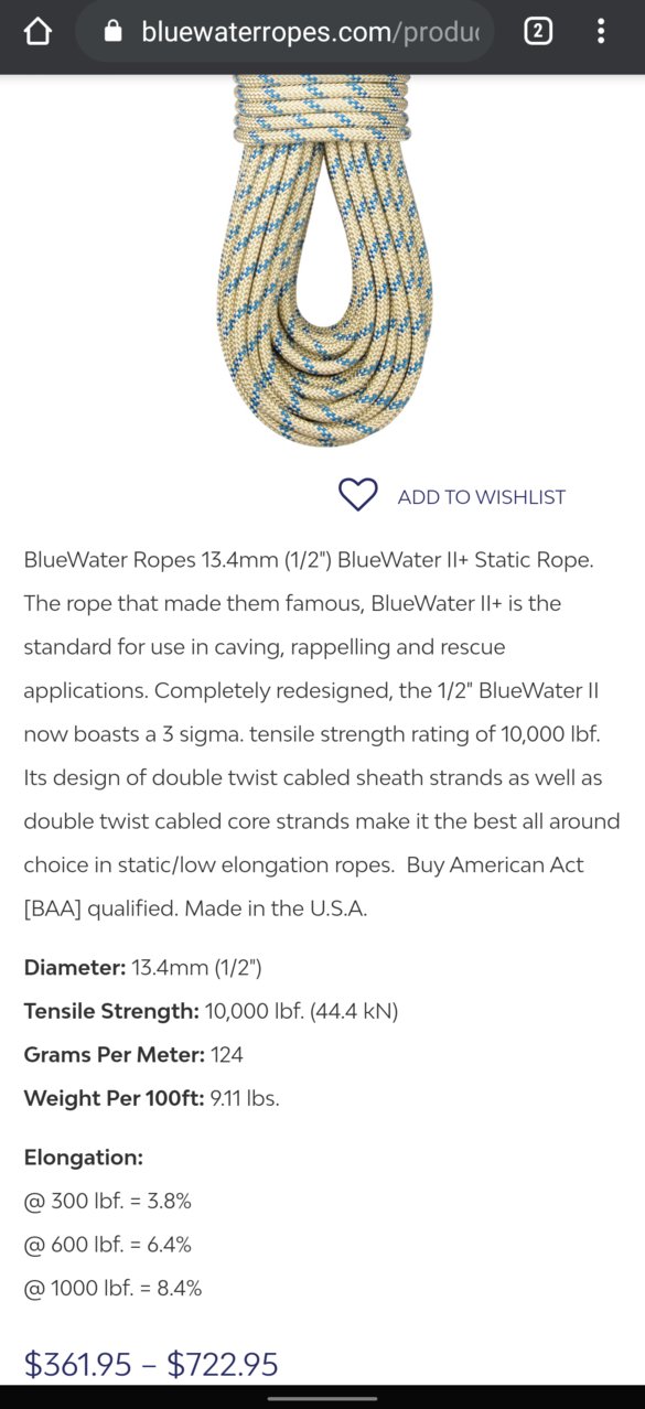

    How about that? A rope with 10K working strength is well over $300! There goes your cost savings!
    Edit: and it weighs about 10#/100', so the concept of 5# of gear is out the window.

    Yea climbing rope is expensive. I guess if you are going to hang your life from it then it had better be high quality.

    Holy crap look at the stretch too!!!! That's rediculous amount of stretch for recovery pulls you'll run out of which before it becomes taught enough to pull you out

    It’s crazy how this is considered “static” in climbing and would likely result in an injury if you fall on this. But in vehicle recovery it’s like a rubber band.

    Exactly! I didn't even consider the little stretch in climbing scenario since this thread is about recovery I was just thinking that context. But you're spot on.

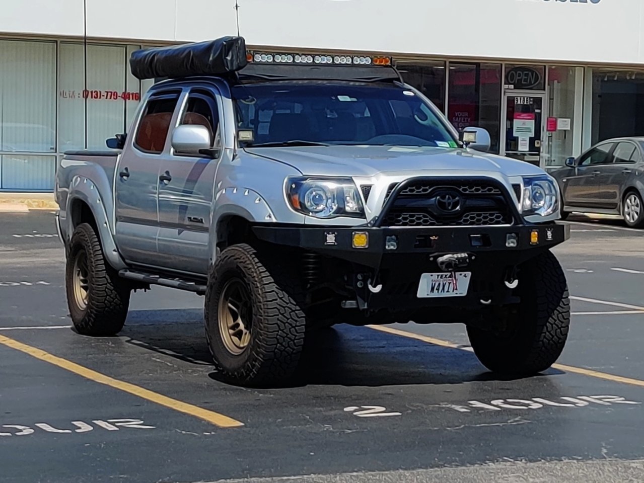

    Good valid points for sure. Alot of weight savings as well!
    But the weight savings vs having an immediately available recovery method is negligible to me. You have to set it up, ensure the snatch blocks are in order and then go. I just pull out my line and I'm good to go!
    I did buy a cheaper winch, a zesuper 9500lb for $280 as I don't need much recovery. Most of the time all I need is a strap and a buddy pulls me out.
    Spent $600 on the bumper kit, $280 for the winch, I'm $880 out on the cost of the winch and an additional 180lbs. Bumper is 118lbs, winch is 65lbs.
    Edit: I lied, the ultrahook and rope guard negate any kind of savings... Lol
