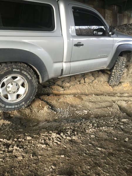

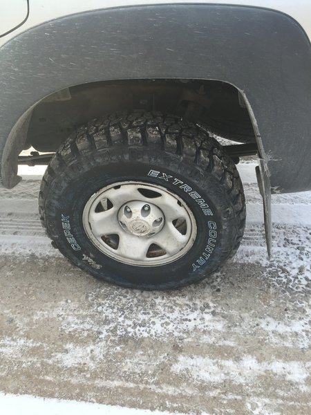

    The stock rim isnt wide enough to fit a 285 tire its way to close to the top control arm. Got the 265 DC extreme countries on the stock rims and I have plenty of room. I eventually want an aftermarket rim that's wide enough to fit a 285 tire.

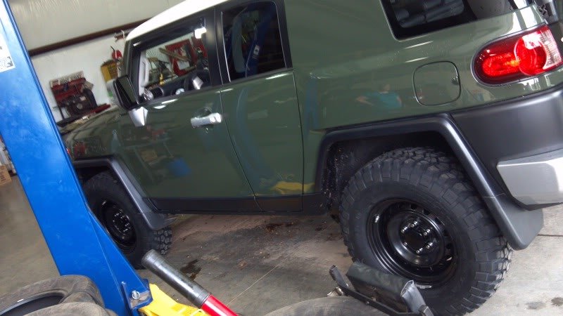

    You have a picture?

    i found those at a junkyard..they are 16x8 steelies mounted on 285/75r16's

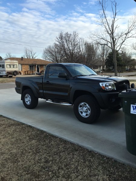

    I'm running 285s on stock wheels and don't have any rubbing on control arm after adding 1 1/4" spacers
