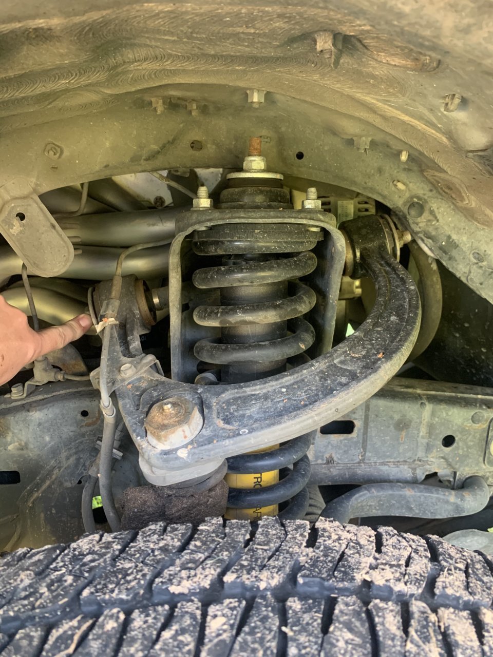

    Also wanted to add a little trouble the shop ran into while installing my OME lift:
    You’ll see in the picture, where my finger is pointing, the head of the bolt that holds the back of the UCA in place. Before the install that bolt head was over on the right hand side, and there isn’t enough room there to remove the bolt — it had to be cut. They ordered two new bolts from Toyota which delayed them completing the job for a day or two.
    They put the bolt heads on the other side, so that in the future, should I choose to change anything or need to replace something, those bolts can be removed then reused.
    It’s worth looking up in your front wheel-wells to see if you’re going to run into the same issue.

    You can "manipulate" the metal enough to get the UCA bolts out and back in without cutting them. Did it on the 05 and will be doing it again, this time on the 08. I did the +1 degree of caster position on the ball joints and had no issues. Will be going with that again this time.

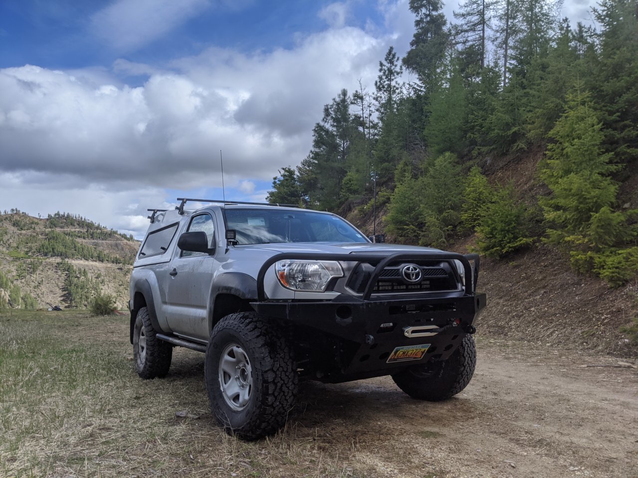

    Got them on yesterday, found some time to take it out today. Need to trim more :headbang:
  13. May 13, 2020 at 7:39 PM
    Taco505
    Taco505 Well-Known Member
    Feb 15, 2009
    #13659
    3,570
    Alex
    New Mexico
    2011 4cyl 4x4 5 speed
    OME 884's/90021, MD Dakar/Nitrocharger.
    Looks great, what all did you have to trim? I know some RC guys have gotten away with the stock steelies and 285s with minimal rubbing at full lock or flex.
  14. May 13, 2020 at 8:10 PM
    ryfox0276
    ryfox0276 Well-Known Member
    Jul 13, 2017
    #223928
    1,252
    Montana
    2013 RC 4x4
    Thanks!! So far cab mount, pinch weld, and a bit of the fenders. Already removed all the front with the bumper install. I need to trim more of the fenders near the cab mount. I think I'm having issues because of the spacers I was told I needed to fit these. Going to try and see if I really need them as it looks like they might clear without them.

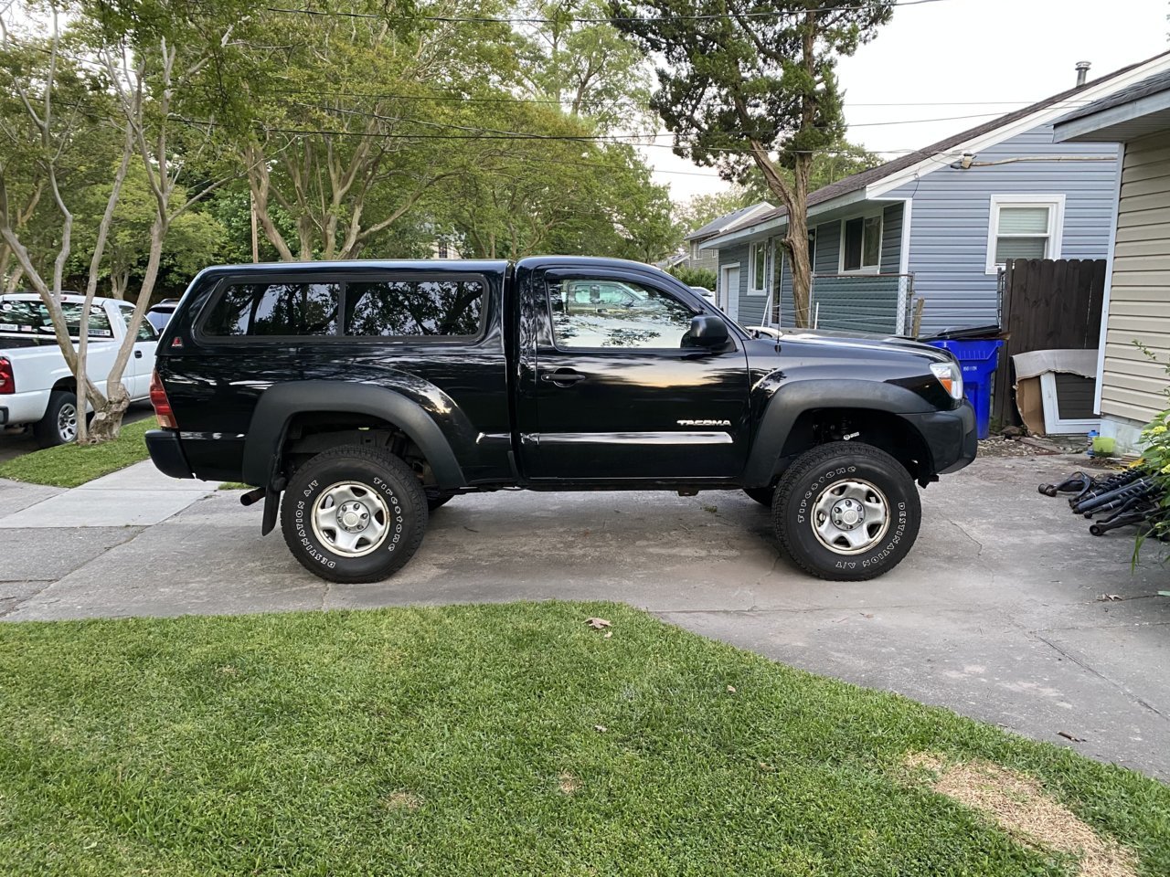

    Looks awesome dude! Just finished mine this weekend. A good start, I thinkFA94A2C0-8BFF-4C15-A46F-763EAD0D51DE.jpg
  16. May 17, 2020 at 9:02 PM
    ryfox0276
    Jul 13, 2017
    #223928
    1,252
    Montana
    2013 RC 4x4
    Hell yeah man! Looks sick!
