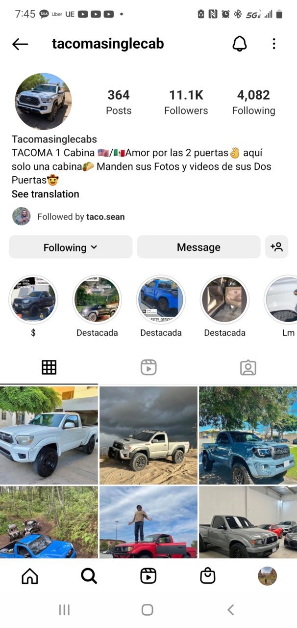

    There's a pretty neat ig page called tacomasinglecab a lot of 3rd gen conversions on there

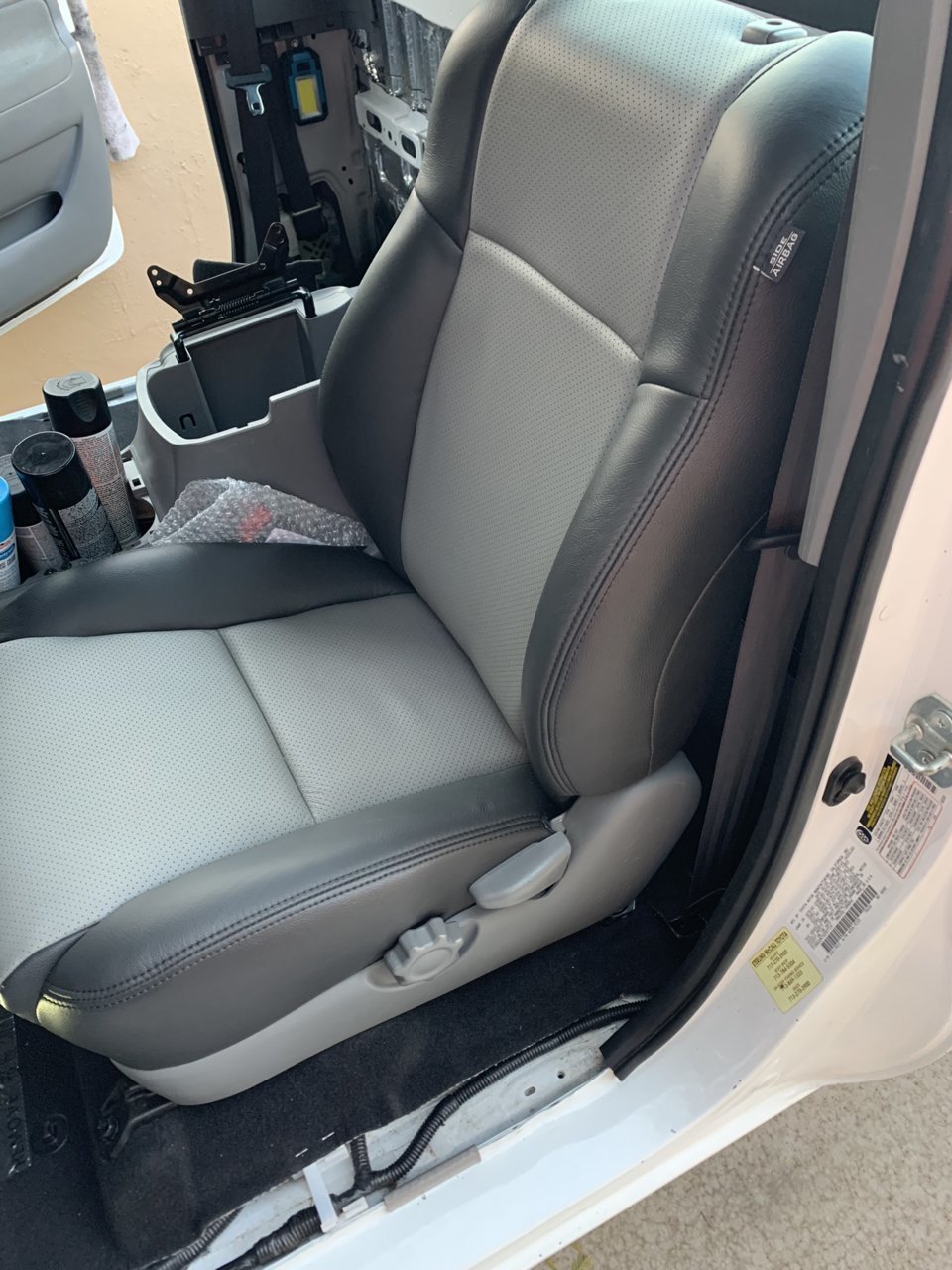

    Yes there’s a kit. It’s called get all new exterior sheet metal & parts along with a complete new bed. The cab and doors are the same and I’m willing to bet you need to keep the Gen 2 interior as I was told the seat mounts are completely different from a wrecking yard when I was looking high and low for a set of factory bucket seats for the 05 we inquired. This was half way through gutting the interior just to clean & replaced broken parts of plastic dash including the clear instrument panel bezel. Ours was cracked and at employee cost it was $27 & tax just for a piece of clear plastic. Trust me Toyota plastic and parts are not cheap! That’s because they rarely need to be replaced.
    I guess if you found an double or access that a tree fall on the cab or a flood truck. But it’s NOT going to be cheap!
    Just started going back together with all new Toyota foam and Katzkin. Katzkin is about half the price of Toyota cloth seat covers…. :eek: :der: :crazy: Then when you transfer the seats you need to pull and transfer the seat sensors and wiring because *I think* the seatbelts changed or updated almost every year. :notsure:
    Oh, had to have the old seat belts re-webbed with new male latches and buy new female buckles for the seatbelts. And I have close to $2k in a pair of bucket seats! :frusty: I had no idea that the seats set outside in the rain for years in Portland. The foam was full of mold = All new foam!

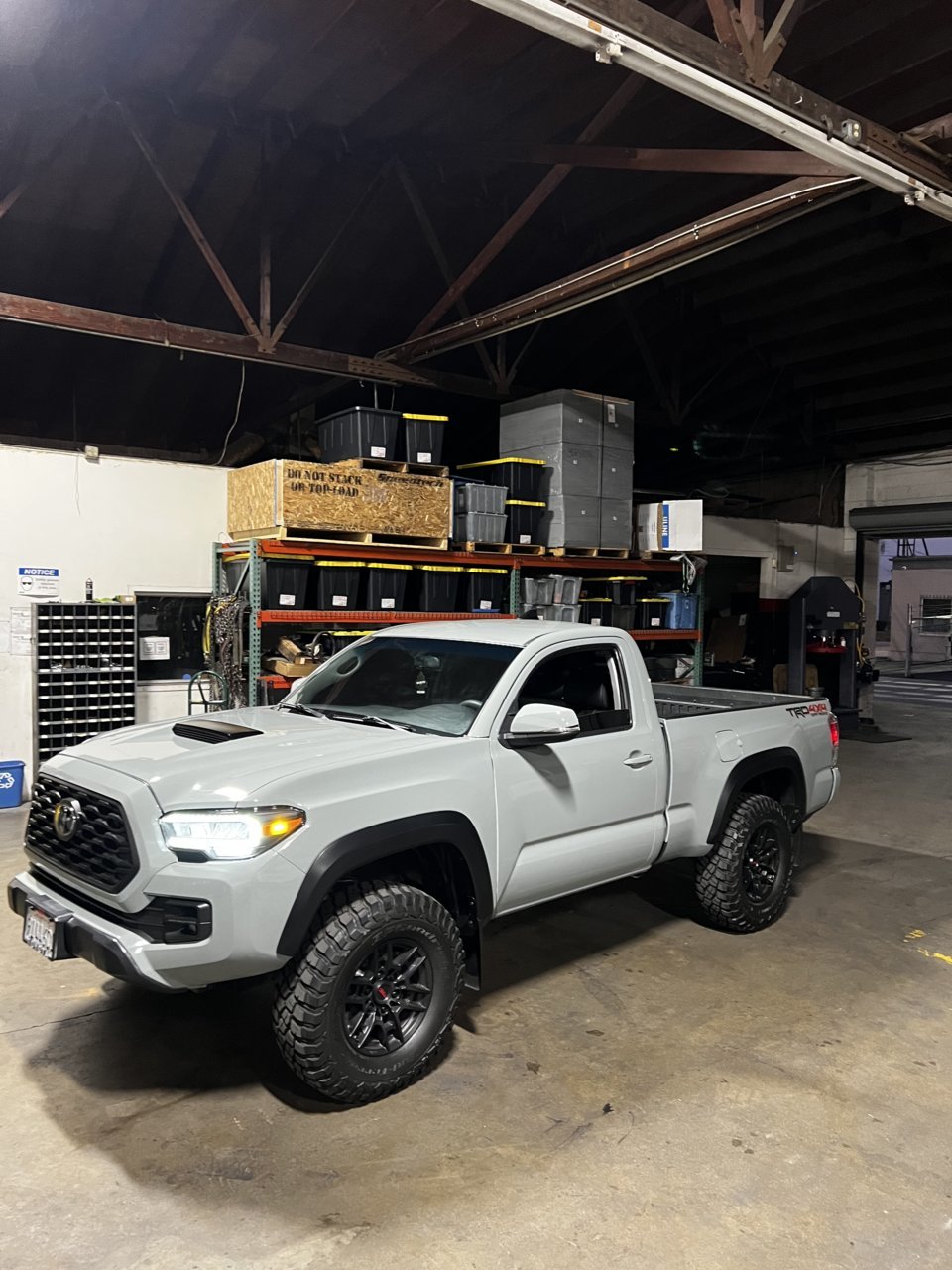

    Regular cabs look really good as 3rd gens, they look even more like a Tonka toy!

    I live in Downey too! Surprised I haven’t seen this truck around. Looks amazing.

    Is this one yours? If so I saw it the other week

    nope
    Mines is lunar rock

    Hey !
    The new 6 foot bed bolts right up no mods needed
    Frontend you will need to fab up some taps
    To hold up fenders other than that just buy Oem parts and everything will fit perfect. Feel free to Dm i can help you
    Doors will need to be body work to match fenders

    no i didn’t purchased
    me and my brother build it together

    That one is lunar rock as well but yall both have very nice trucks

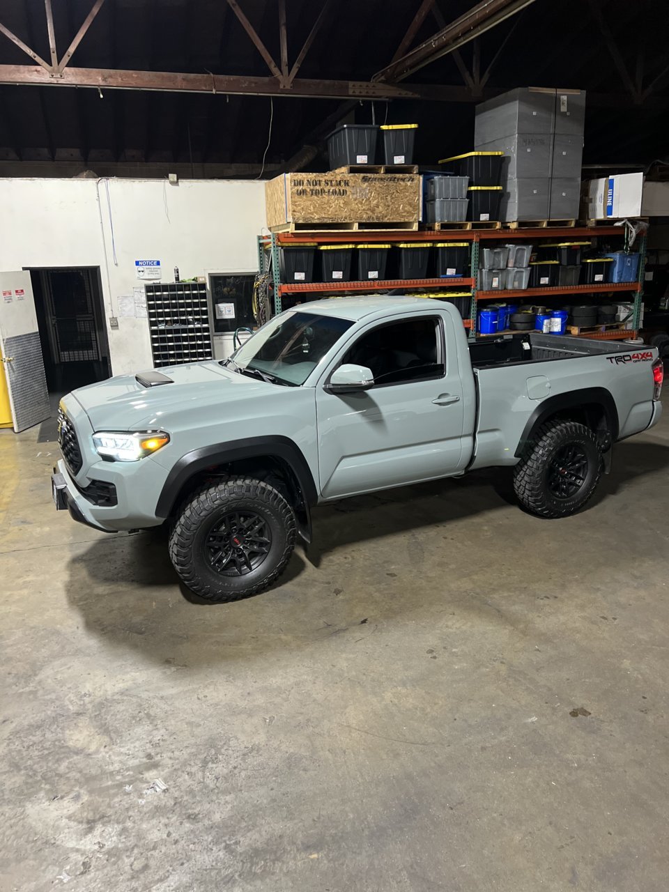

    that one is cement grey I seen it
