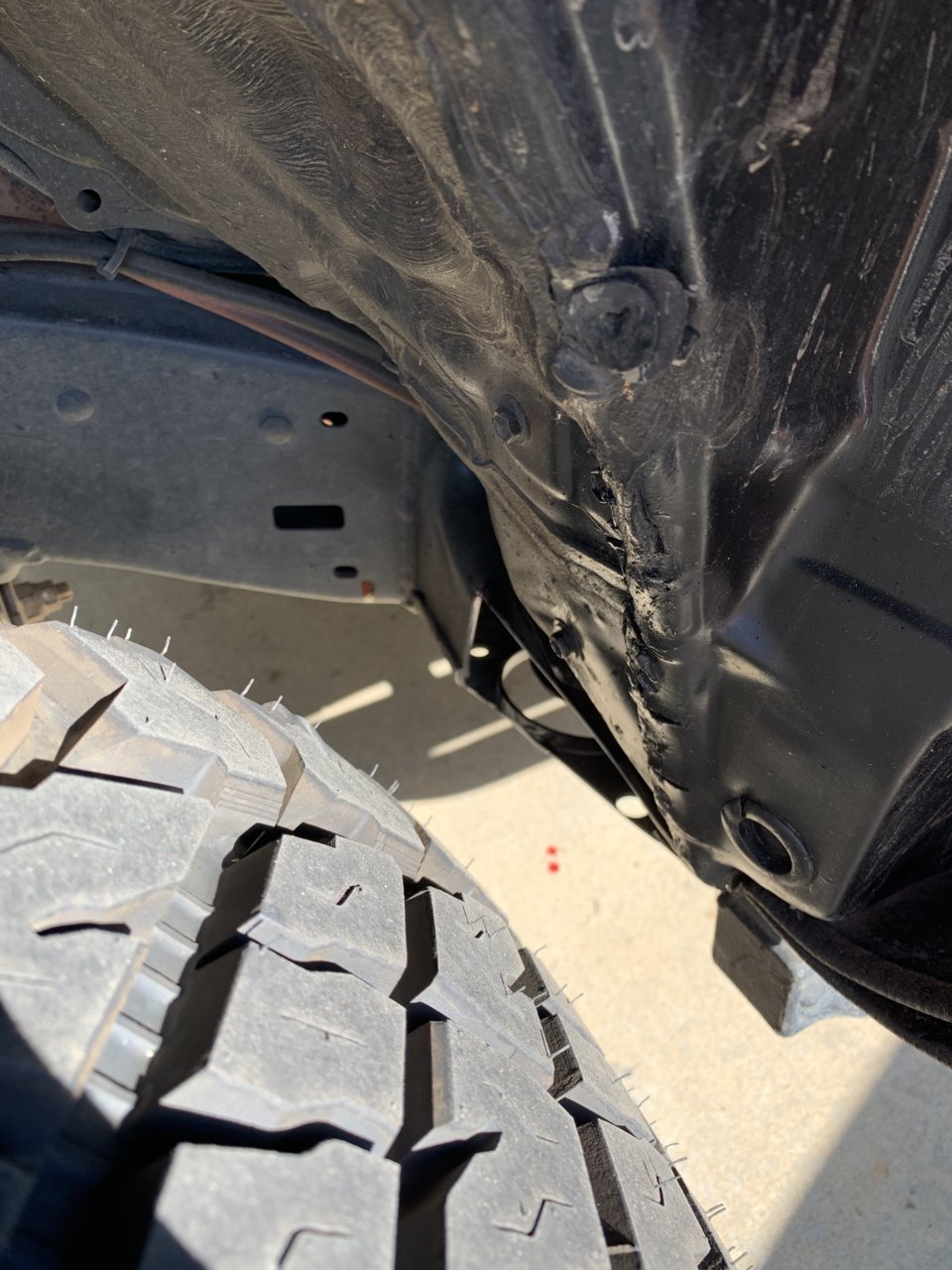

    Dang I just purchase these 16s XD rims I’m not switching yet... But 315 holy cow how much cab mount did yo have to chop and do you have to replace the front bunper

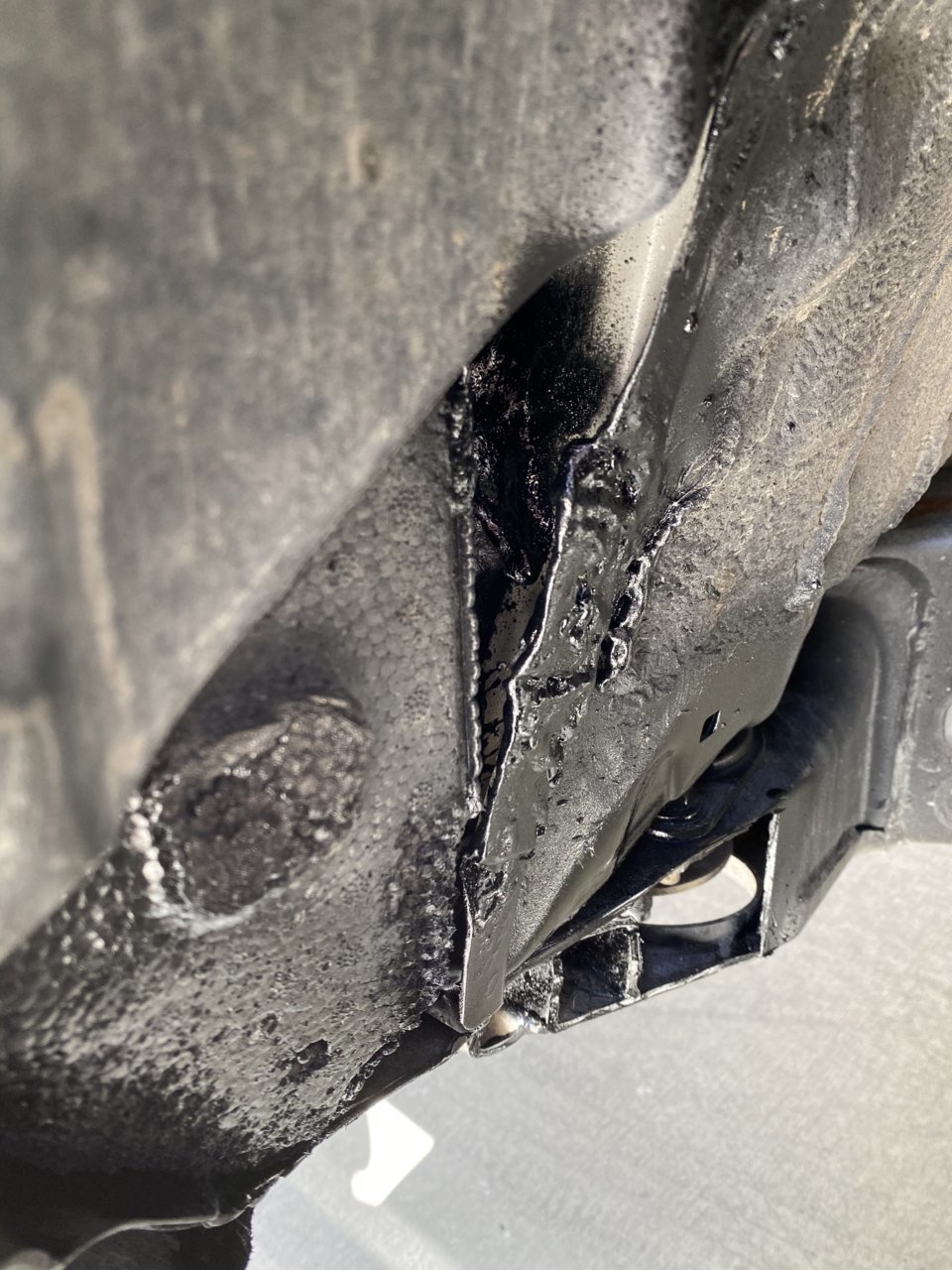

    just need to check clearances and get an alignment before I plate it back up. But a lot. I could hammer the pinch weld a bit more too.

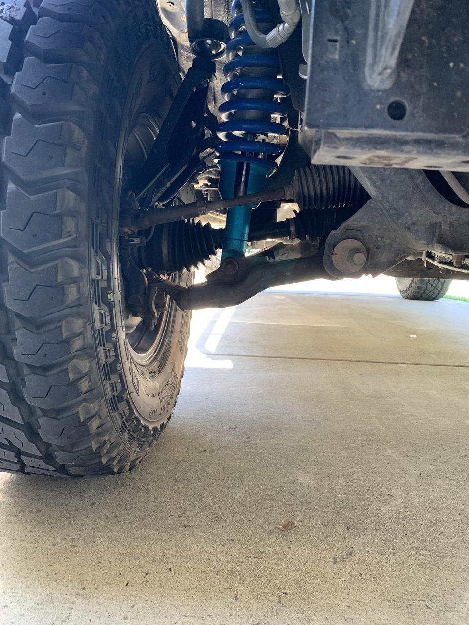

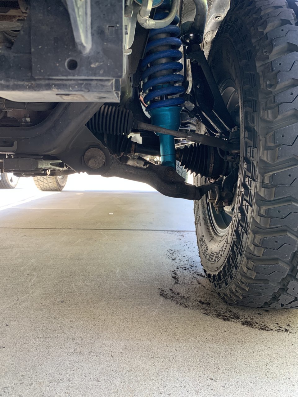

    I cut 2” but probably came to 2 1/4” off the fender trim after rounding/sanding the edge straight (plastic seemed to ‘goop’ up and the line ended up being more of a guide)
    just measured and I’m at 25.5” roughly. 23.5” if they weren’t cut. I’d like to lower it a tad, maybe 1/2”.
    CVs look okay to you?

    The inner cv boot fins are touching a little more than I’d like. I don’t think it’s an immediate concern though. I’d lower a little until you start to see a gap between those fins.

    Good to know. Thanks man. Still learning the 4x4 stuff. Technically still prerunning. Doing a swap, just need to install the trans and xfer case. I have a new boot kit for both CVs I’m going to install when I get the truck up on stands for the rest. The passenger boot slipped and started throwing grease 2 days after I installed the front end 4x4 parts.
