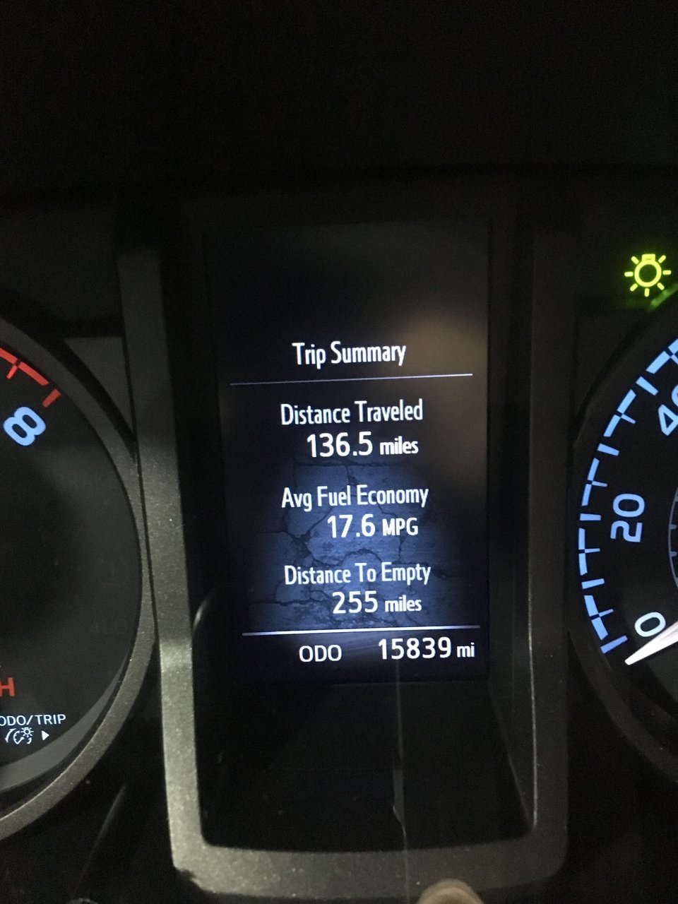

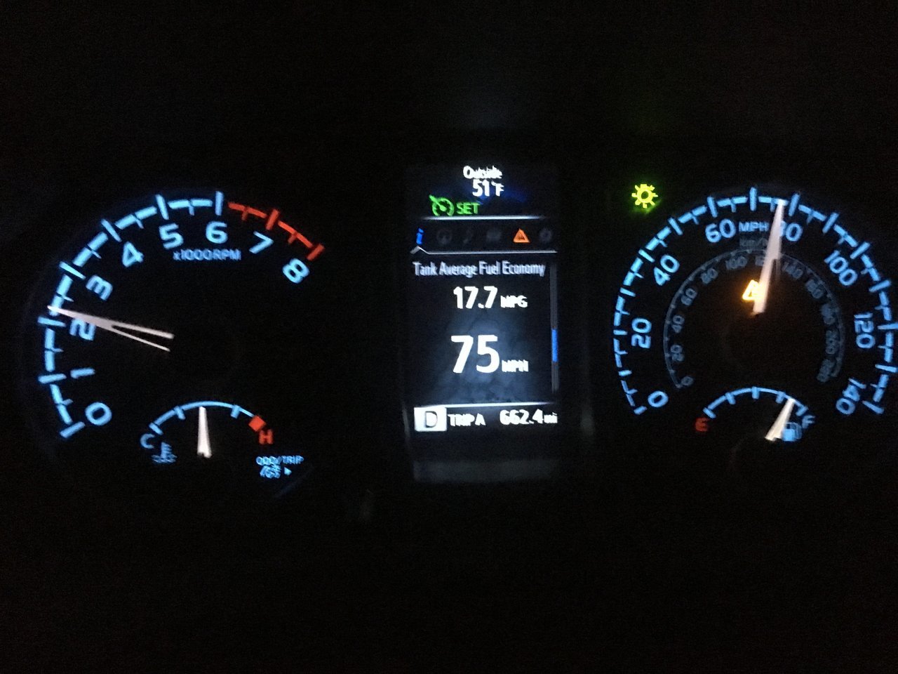

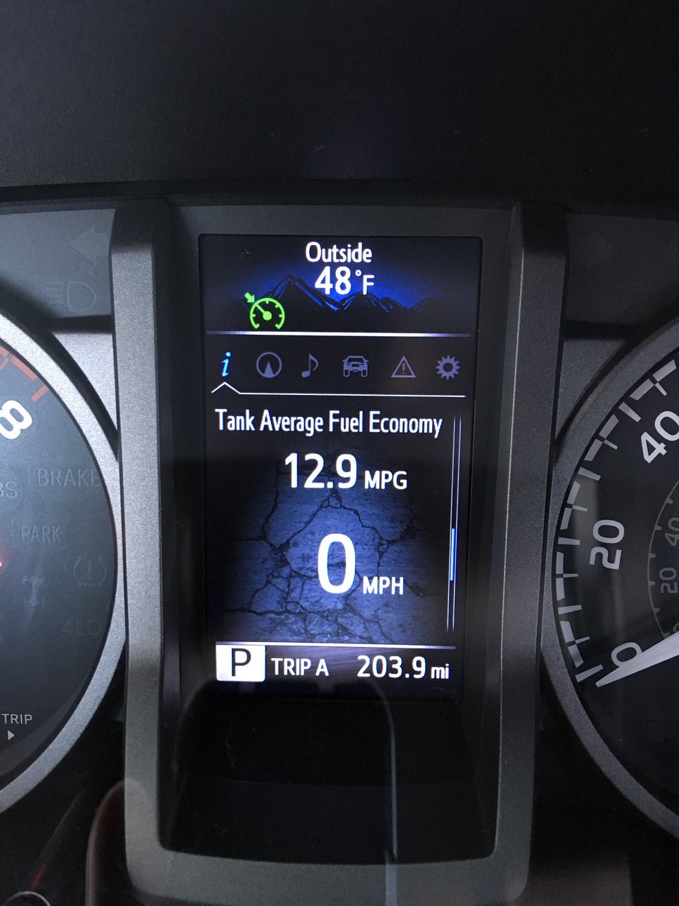

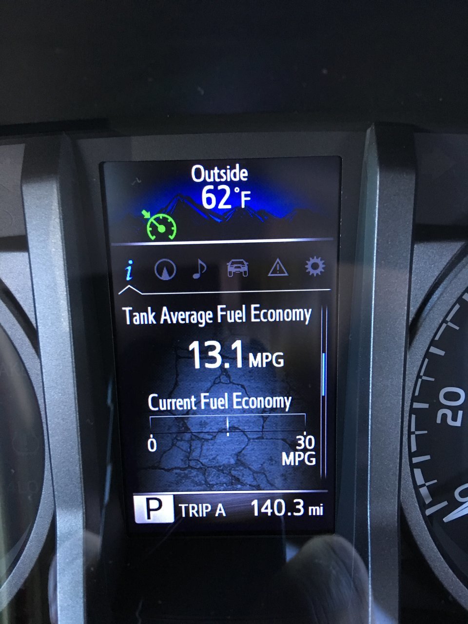

    Your gas mileage before photo, that's before the speedo calibration right? Regearing send to be the ticket for these trucks especially with bigger tires. I wouldn't mind those rpms at that speed
