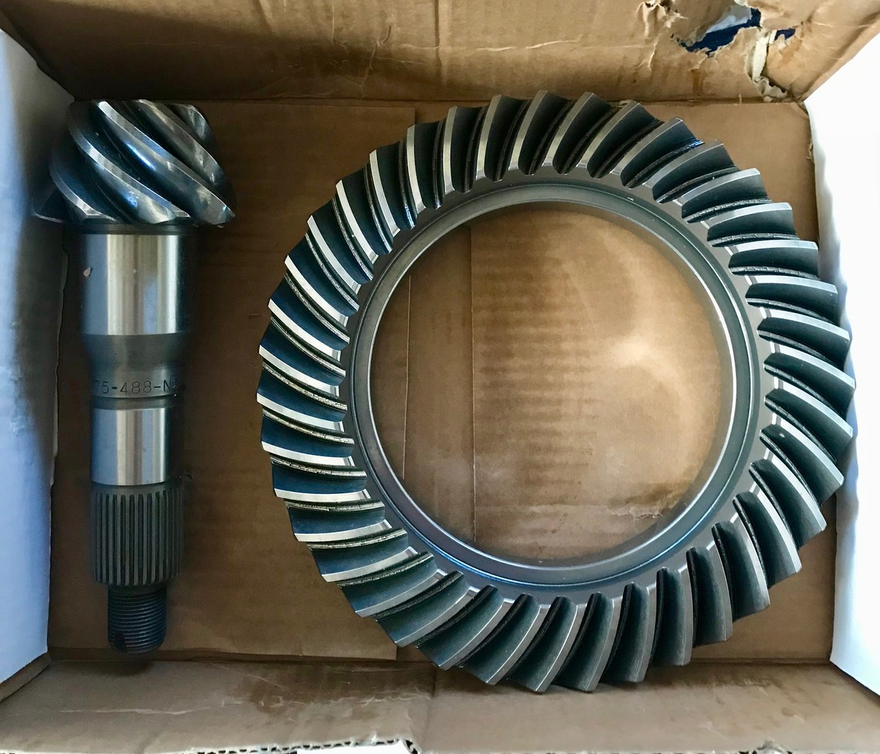

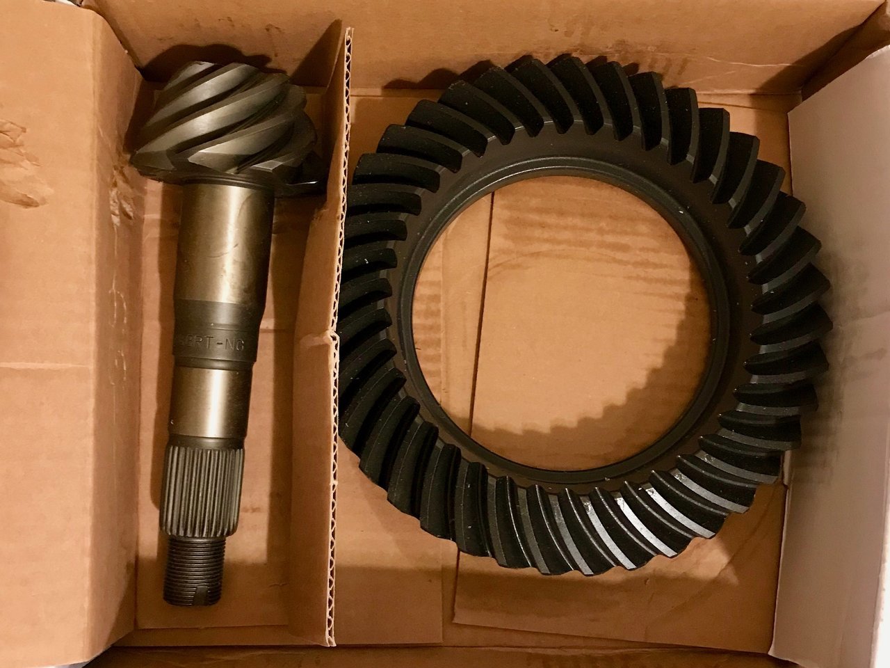

    Oh hell yes. Install on Thursday :headbang:
    BEFORE REM Resurfacing:
    AFTER REM resurfacing:
    BT17, BassAckwards, riz_atx and 4 others like this.
