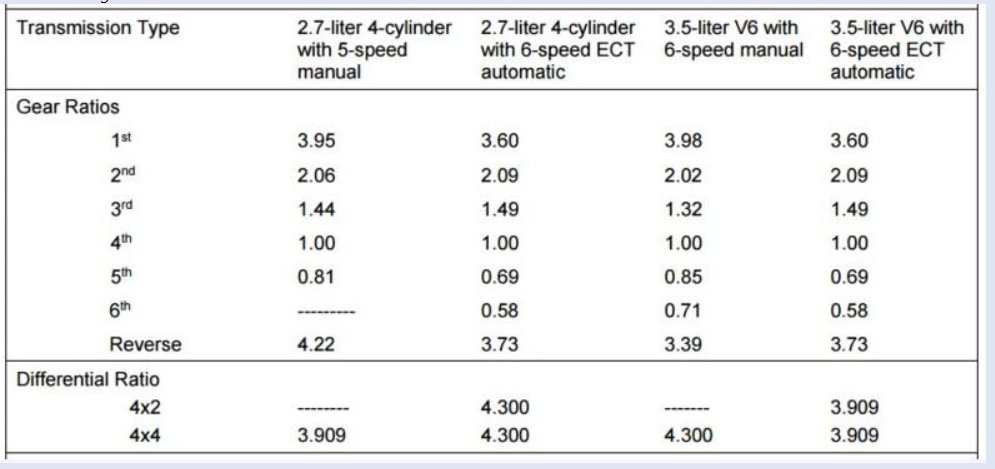

    Why would an auto and a manual with the same gearing have different engine rpms? If they both have the same engine, the same gearing and the same tiure size, wouldnt they have about the same engine rpm speed on 4.88's?

    WZ00R2
    WZ00R2 Well-Known Member
    May 18, 2018
    #253814
    980
    TN
    2020 Cement OR
    6112/5160, Deaver U402, 255/80r17, SCS BR6
    Different gear box ratios.

    So the trans gearing and the diff gearing provides a final drive ratio... i think, if I have this figured out in my head.

    JoeCOVA
    JoeCOVA Well-Known Member
    Nov 15, 2016
    #202463
    9,657
    Joe
    Colorado Springs
    Ford F350, Lexus RX450h, FZJ80, Jeep YJ, Jeep LJ
    Yes but also dont forget the transfer case gearing when in 4WD

    riz_atx
    riz_atx #bigpermtaco #teamBP
    Jan 5, 2017
    #206621
    10,674
    Sohail
    Spicewood Texas
    ‘16 4x4 DCLB GFC Locked, Geared, Tuned
    C4Fab/RCI/BAMF, ADS, 4.88, Lockers, OVTune
    Word. Its starting to make more sense. I have 4.88's currently in my AT '16 with 265/70/17 and even though its pretty wound up (overgeared), it drives real nice. Ill be adding some 34"'s here pretty soon and it should decrease the engine RPM at hwy speeds some more.

    WZ00R2
    May 18, 2018
    #253814
    980
    TN
    2020 Cement OR
    You got it! The engine speed is first reduced through the transmission gearing. Next then output of the transmission is reduced by the transfercase gearing and then a final reduction through the axle gears.

    JoeCOVA
    Nov 15, 2016
    #202463
    9,657
    Joe
    Colorado Springs
    I'll add that our transfer case is 1:1 in high and 2.57:1 in low. If you add a dual transfer case you can get the Japanese 4.7:1 ratio.
    So you just keep multiplying.
    (e.g. 1st gear transmission * 4WD Low * Dual 4WD L * Axle = final)
