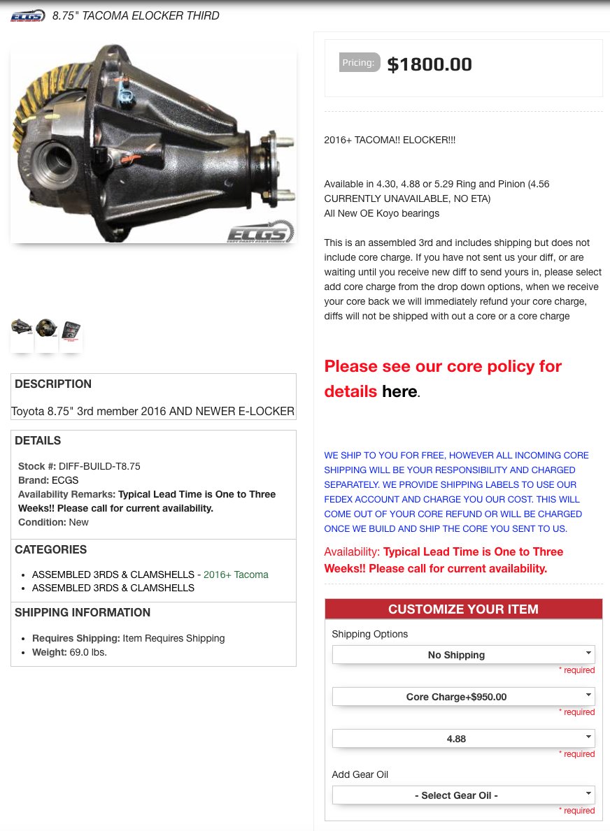

    I am considering going to 4.88 gears and am a noob when it comes to figuring out what I need. Is it cheaper to just get the pre-assembled or is it better to find a reputable shop and just pay for the gear kits? I am assuming my diff size is 8.75" on my rear diff and 8" on the front diff on my PRO?
    How do I go about getting the front/rear combo on their site? Is this the correct combo?
    Rear: Stock #: DIFF-BUILD-T8.75
    Front: Stock #: DIFF-BUILD-T8CSB
    What customization options are necessary? New bearings? Add CV bushing? Sorry new to all this.
    Do you get it with the added gear oil or put in your own?
    Also, any preference between ECGS, Nitro, or Yukon?
    Is it relatively easy to just do the front/rear diff swap if you purchase the ECGS 3rd member assemblies?

    Man thats a loaded question. The cost for labor and parts is about the same. You can also use .
    @ZUK
    New bushings and bearings will depend on the miles. For Diff fluid, just buy your own.
    Personally, I did not want to deal with core charges and shipping and removing the diffs myself so I purchased the gears and master install kits myself and found a local guy to do it.
    Some shops will require you to purchase gears and kits through them.
    I'm sure there is a local 4wd shop that does differentials in Oregon
    mcharfauros likes this.

    I'm hoping to go your direction soon. The shops around here are shying away from building those up for a Tacoma, they only do Jeep diff builds around here.
    I was quoted $500 by a 4wd shop to just swap out the clamshell and 3rd. I'd rather have the experts at ECGS build it and get their warranty then have a local shop install.
    I don't plan to add new bearings since I'm still under 10k miles, but I might get their diff oil just in case there's any warranty issues.

    Go with ECGS prebuilt units and install them yourself if you can. If you can't install yourself then it's still WAY easier to find a shop to swap out the prebuilt units then it is to find someone to set up gears.
