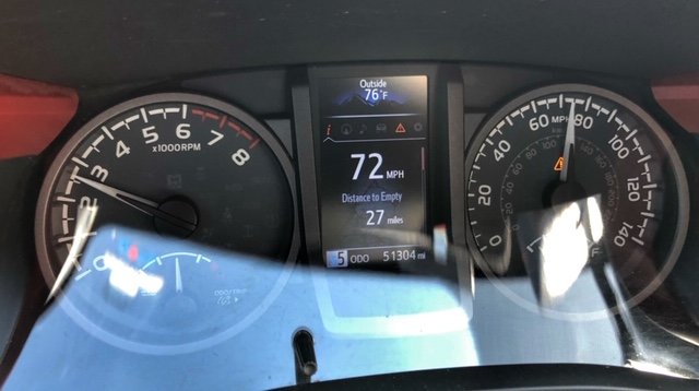

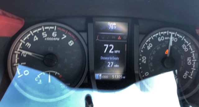

  12. Sep 13, 2019 at 10:37 AM
    #992
    jholc21
    jholc21 Well-Known Member
    Sep 27, 2015
    #165286
    652
    Colorado
    2017 White Tacoma TRD OR
    Bilstein 6112/5160 w/Dakars Leafs 255/80/R17 Cooper ST MAXX Skinnies 4.88 Gears TRD Pro Fog Lights Cali Raised 5D Combo Leather Seats LED Bed Lighting ARE Overland Shell
    RPM in 5th and 6th gear at 75 mph (GPS) on 33 inch ST Maxx skinnies.
    TnTuna, SpeySquatch and Wixo like this.

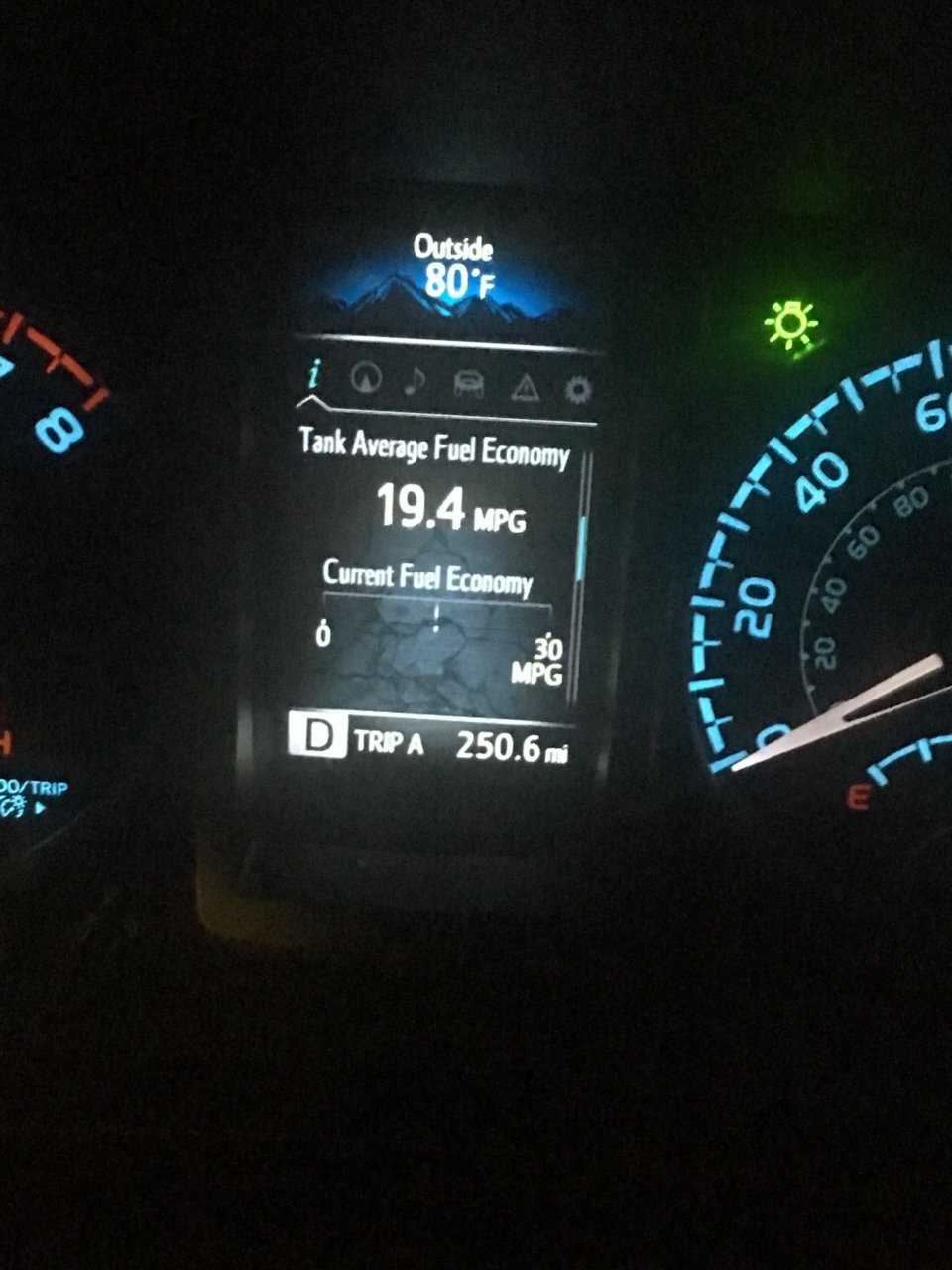

  19. Sep 22, 2019 at 8:37 AM
    #999
    Doomsday
    Doomsday Well-Known Member
    Jan 13, 2010
    #29290
    637
    Cypress, TX
    2017 TRD Sport 4x4 DCSB MGM
    Lights, Tires, Wheels,...more to come!
    A little under 250 miles to complete break in. I’m getting better mileage with 33’s and 4.88 than stock gears with 32’s. I think I could get over 20 mpg highway, I’m still doing city & highway driving. Also, speedo is off about 3-4 mph. So realistically, 20 mpg don’t sound impossible with conservative driving.
    RyanDCLB, Semper_Fi and SpeySquatch like this.
