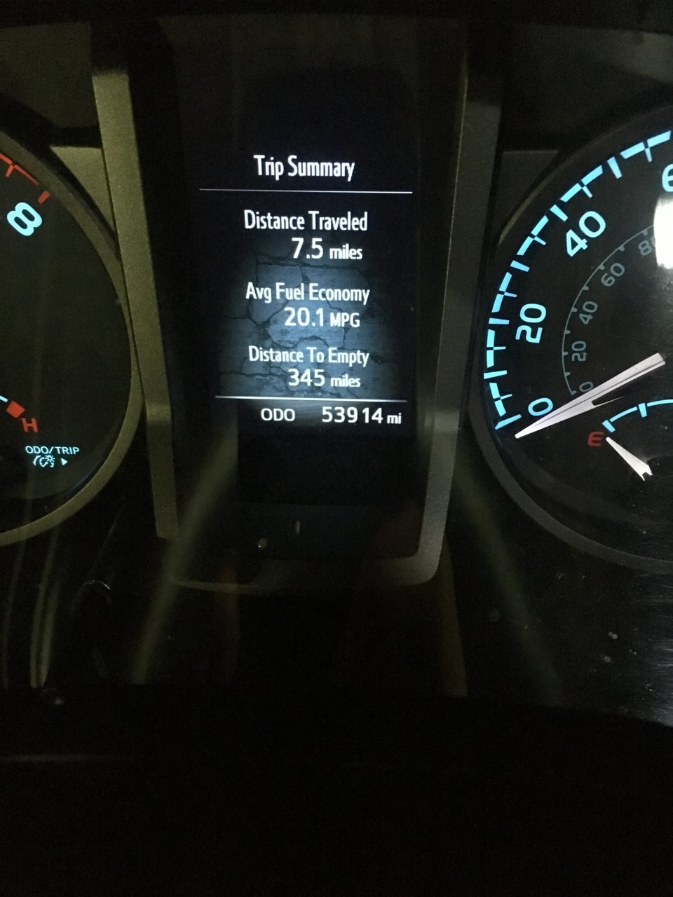

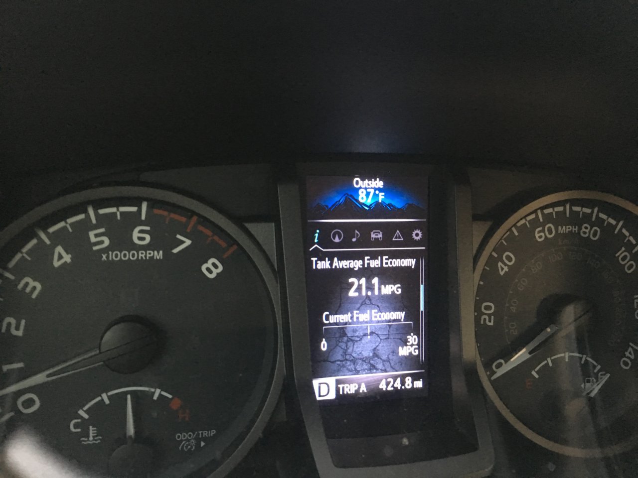

    Took a drive out on the road after work to get some more miles in. Almost there. Fuel mileage @ 21.1 mpg driving on highway on 33’s about 65 mph. Noticing trans temps are also down about 5-10 degrees lower about than normal, need more time with regular driving and 90+ degree day to confirm reduced trans temps. CF103244-ECB7-4C23-BFAE-109D3AF77A71.jpg9C3A253F-BF25-4A38-BBB8-8B1AE0C3746A.jpg6328B3A9-67AA-4DFF-88D0-E0FE07B3D943.jpg

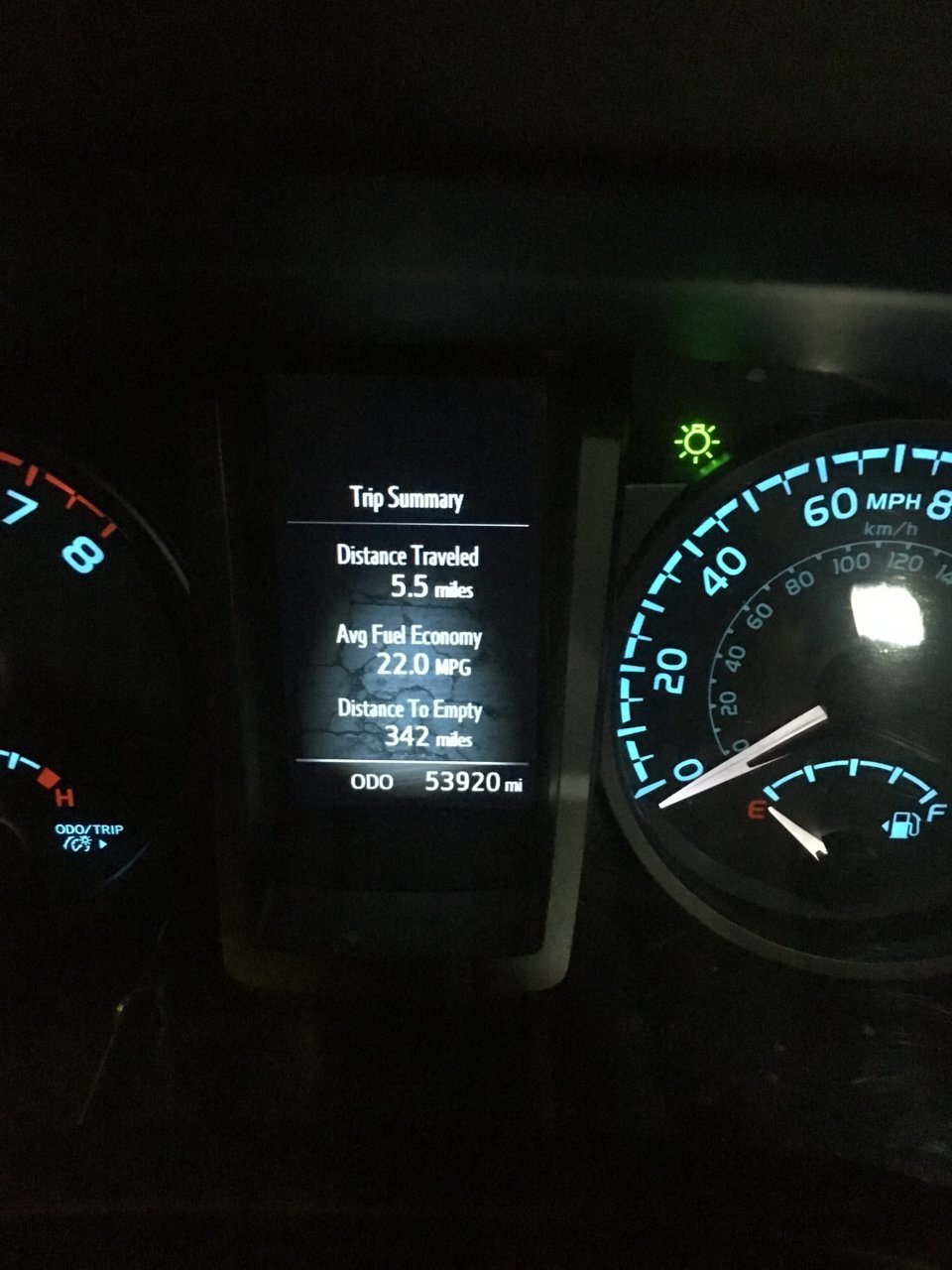

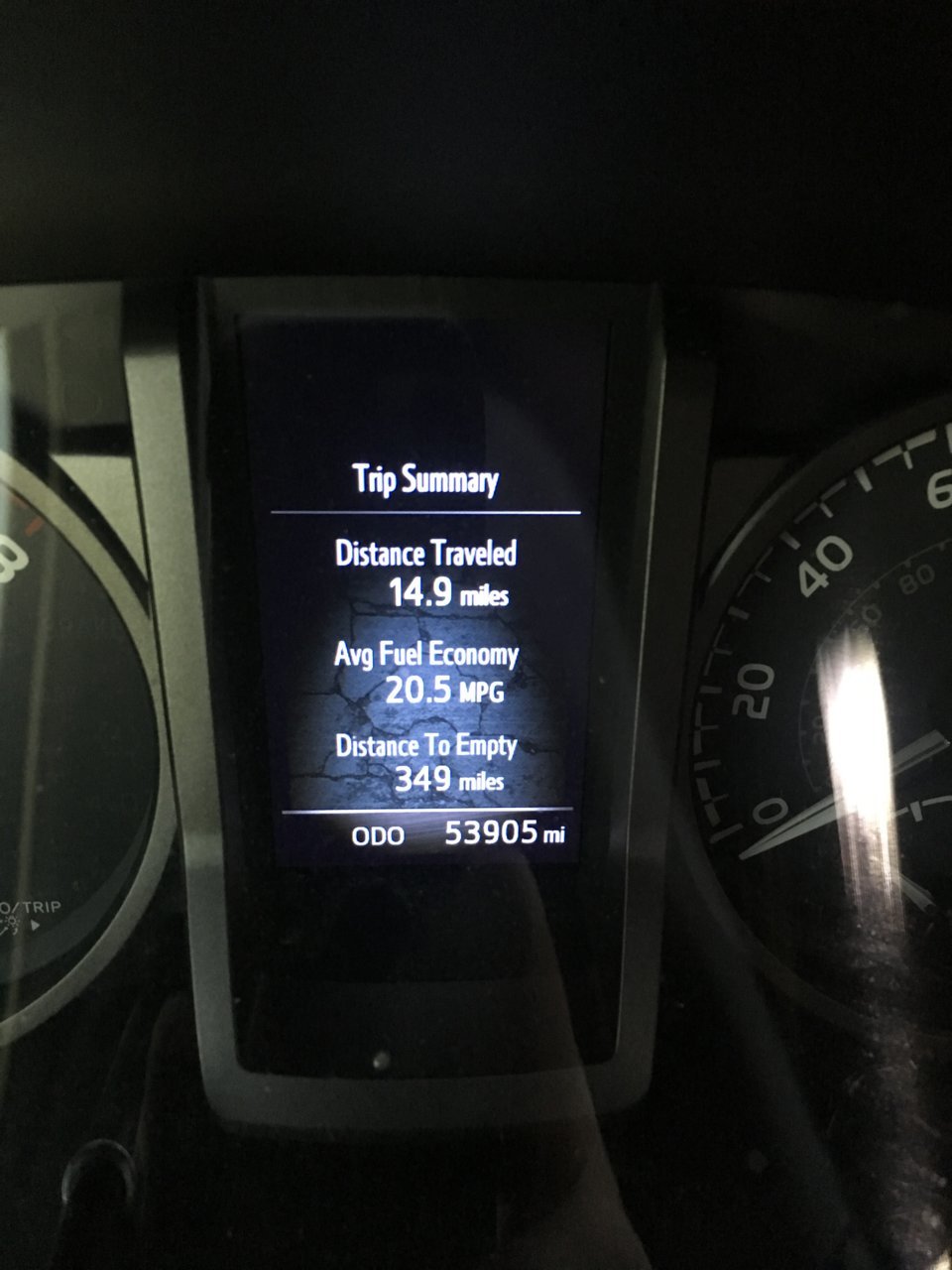

    So went and picked up Lucas dinosaur oil for the break in. Had to go make two trips at two different Autozones to get enough oil. My last 5.5 mile trip home avg 22 mpg. Yes, my A/C has been on the entire time. Noticing the mpg bar drops coming up to speed, but once I’m at cruising speed the mpg just starts to climb. These two pics from city(suburbs) driving.
