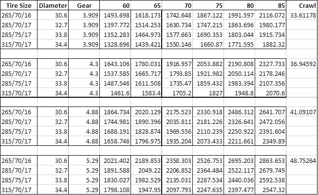

    3rd gen 5th and 6th gears are double overdrive gears in the AT (4th is tall)
    Nissan Titan has a V8
    Here’s some more for your efforts to help

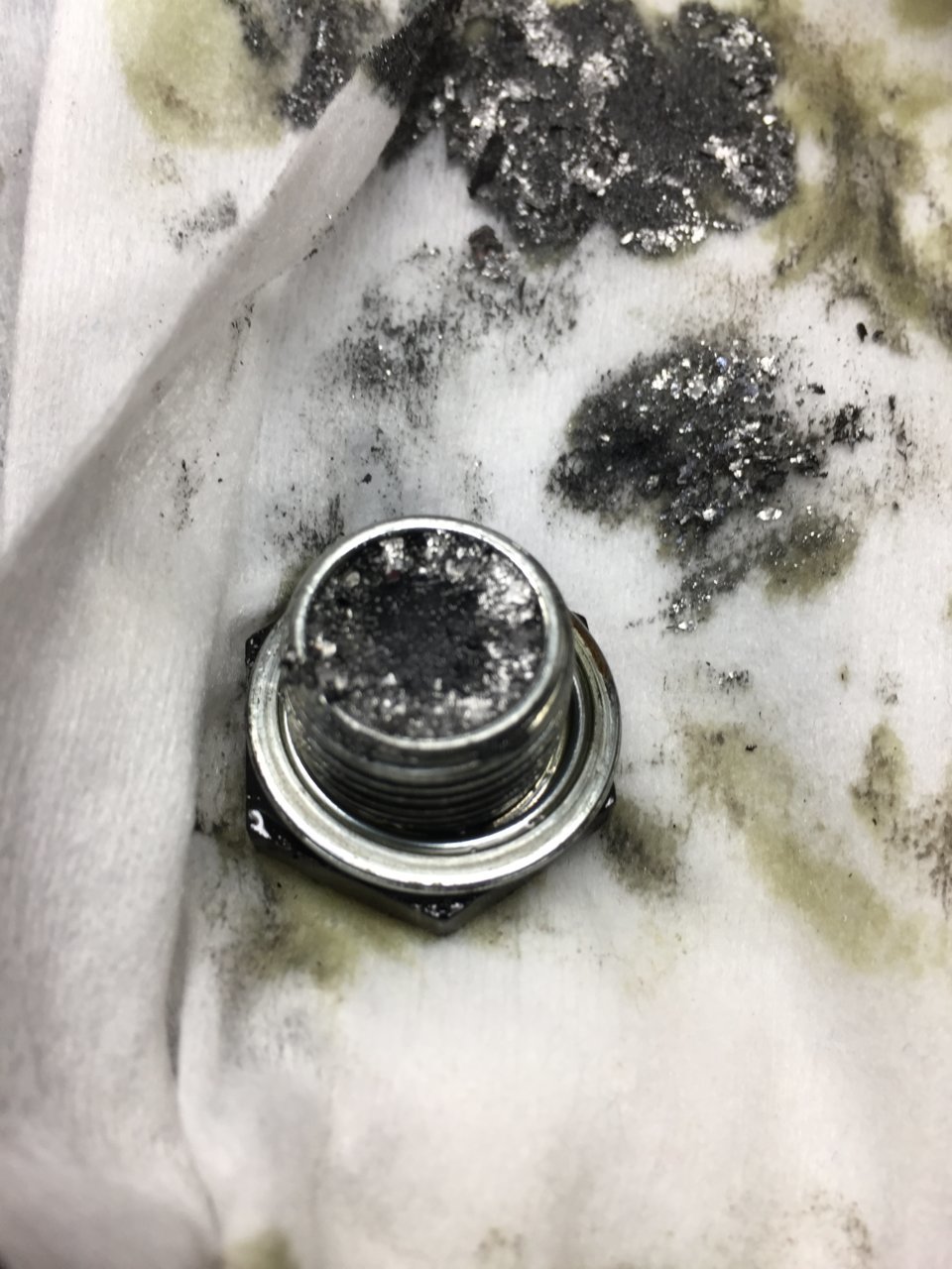

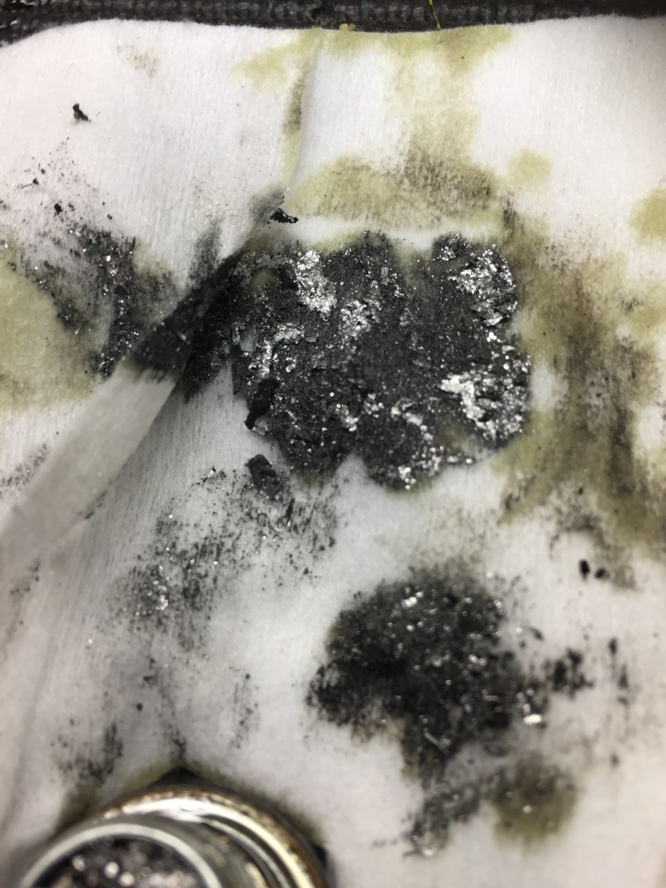

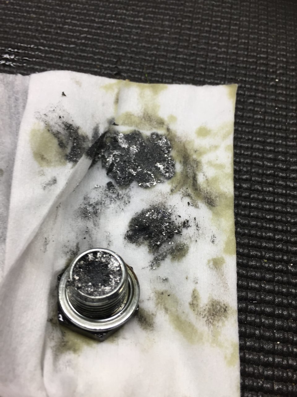

    Just changed the rear diff on the new REM polished 4.88’s. About 1200 miles on the gears for this first change (was told REM doesn’t need 500 mile break-in). The used 85w-140 (Lucas) gear oil came out dark gray and had shiny flakes.
    Is this normal when the REM gears break in?
    I got them installed at a very reputable place (Six States Distributors in Portland Or) and the paint mark for how the gears seated looked really good. Thoughts?

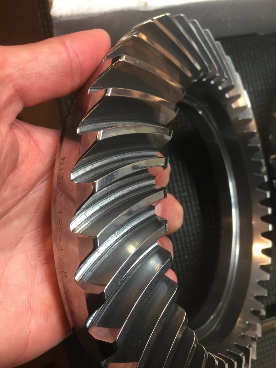

    This is what the gears look like new

    I had the REM done to mine but i changed my oil at 500 miles. I did have very fine shavings. You look like some heavier shavings but doesnt look really bad. Change the oil after another 500 miles and see if there are anymore heavy looking shavings. Send a photo to your gear installer ask his thoughts!

    Yep will do. The place I got it done has over 30 yrs experience and the paint markings for how they seated looked great so I was just surprised
